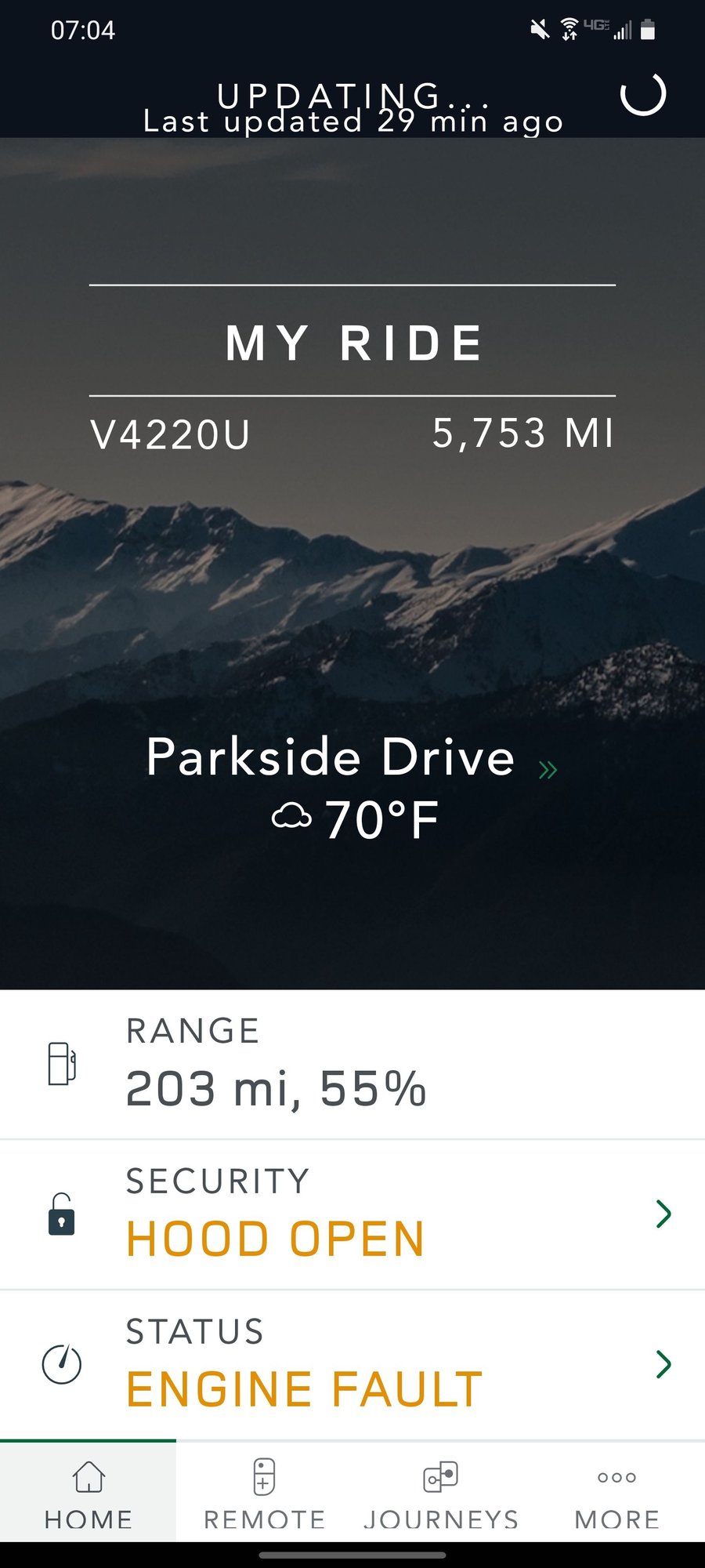

Currently this is what the app tells us. Hopefully find out mote later.

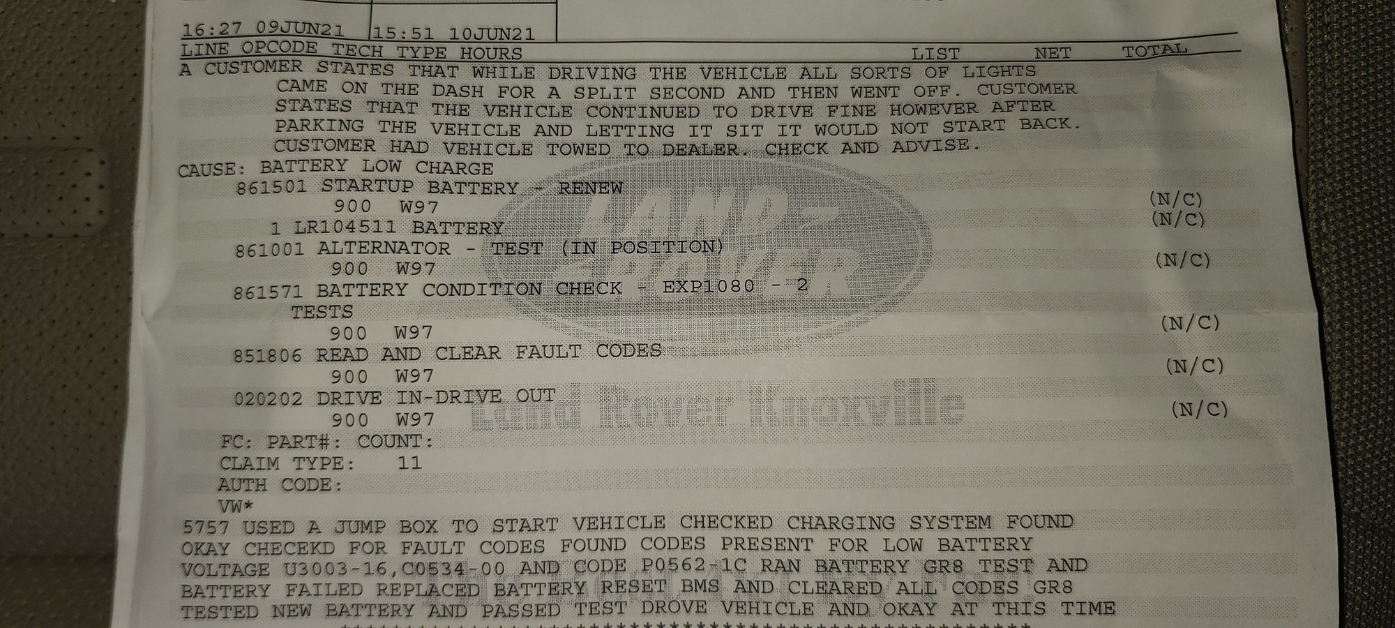

Got the vehicle back yesterday. Tech said that it was a "volt issue", and they replaced the battery. Little worrisome honestly, less than 6k miles. Drove it the day before with no issues, and has not had any other than that. Hopefully doesn't do it again.

All .... here is the explanation of a "GR8" test. Interesting. Apparently these new fangled batteries in our modern vehicles fail so often, one needs to run a standard test and turn in the test strip to have General Motors reimburse the dealer.
Plus, it seems testing the AGM battery is a mandatory part of prepping the car for sale --- at least within GM.

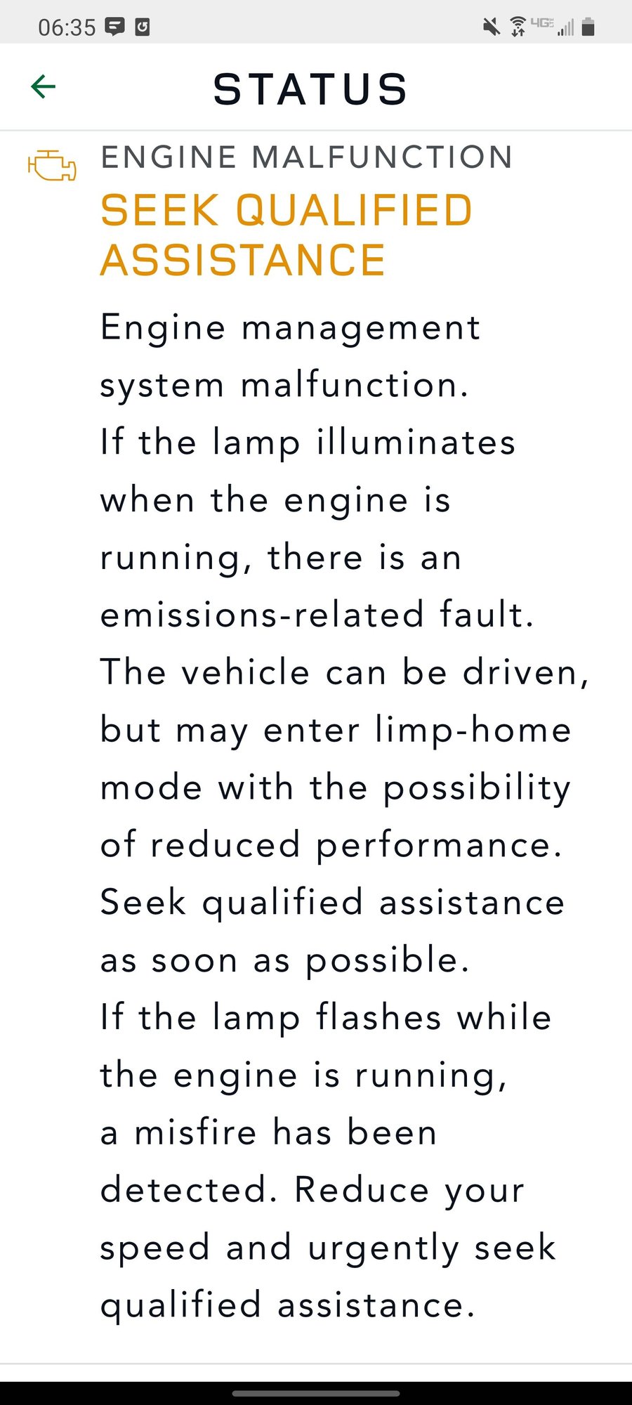

Found this elsewhere... but after getting it back from the battery issue this has happened twice in two days. Wife is going to take it by there tomorrow and see what they say. This message never came up before, maybe related maybe not.
