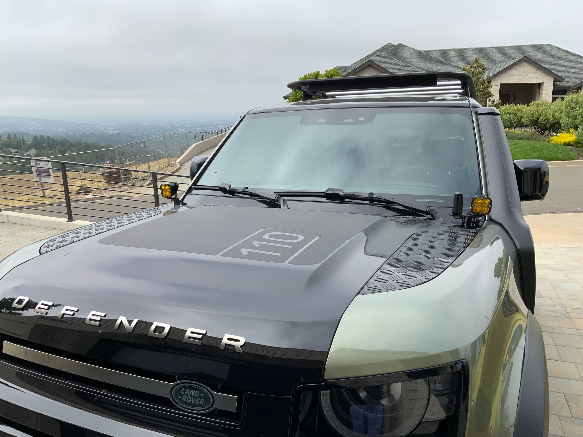

Thanks guys,
Sarek those are all interesting points. I have had my 2006 LR3 since new and I do love the air suspension but I understand the concerns. I have found it to be very reliable and the bags are cheap and easy to change but what does happen is the pump seems to be a weak spot. The LR3 is on Johnson rods with 18” rims and 32” tires. I love my Defender but that LR3 is probably what I should be focusing on. Cutting into the Defender 110X to replace bumpers and add winches is hard to stomach when I spent 100k.
I did not know all that about the locking Diff. I will have to give that some thought. I had intended to add things to the Defender but so far all I did was add the rear lights, some ditch lights, a midland radio and antenna. I keep looking at Bull bars and winches which is where I am stuck. I like the utility and look of a standard hooped bull bar but the minimalist and less destructive addition of something like the sport bar at new defender might be what I do. I probably just need to remove the factory rack and get a better one but like the front skid plate you have this feeling that I paid a lot of money for this.
As is I could just go out with people and enjoy and figure out things as I go along. I think you are far from CA if I recall correctly. I did get a nice off road trailer and my setup is coming along.
The dealer gave me the Outbound spec of the 130 and I was planning a road trip with my trailer but a little worried about hurting their car. I put PPF on mine to help with the pinstripes.
