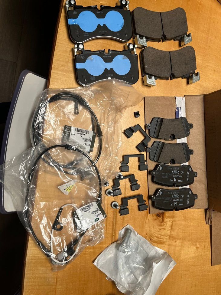

Originally Posted by KamboMD
Firstly, you always are here to help and I greatly appreciate the time you take to respond to questions here - especially mine.
I searched brake pads and oddly enough your post never popped up, while others did, which I looked over before hand. Great write up with photos.
I'm assuming I only need to replace the pads and not the sensors since the warning message hasn't creeped up yet.
On land leaping I was a bit confused because when I type in my VIN, it brings up the ones I need, but the description says for 20/22 inch wheels, which I have 19 from factory. I was going to reach out to them just to make sure that won't be a problem for mine
This is a common source of confusion. The distinction relates to the 3 sizes of rotors and their corresponding pads
in North America
smallest. P300 18” rims
largest V8 and some P400 X trims that came on 22” rims
Medium Every other model (Octa excluded as I’ve no idea on it)
ie. 19” rim means everything else. Doesn’t matter if you have 19 or 20.
yours is in the everything else category. Same as mine. P400 that is not and X on 22”s
Get the pads for the 19” 20”
rim if that is the confusing nomenclature they use. Landleaping are very helpful and will confirm part numbers.
on the replacing wear sensors. Instructions state to replace the rear one regardless. Front one only if it’s been triggered I couldn’t figure out why till I did both.
The front one requires removing the wheel arch liner to get to it. The rear one is easily accessible.
So I think it’s just a $$/time metric for service.
I see no actual difference in them and if doing it again would not replace the rear one unless it had been triggered.
They’re not that brittle at all. Easily pop off and on. I went aftermarket on the front one save a few bucks identical to OEM
