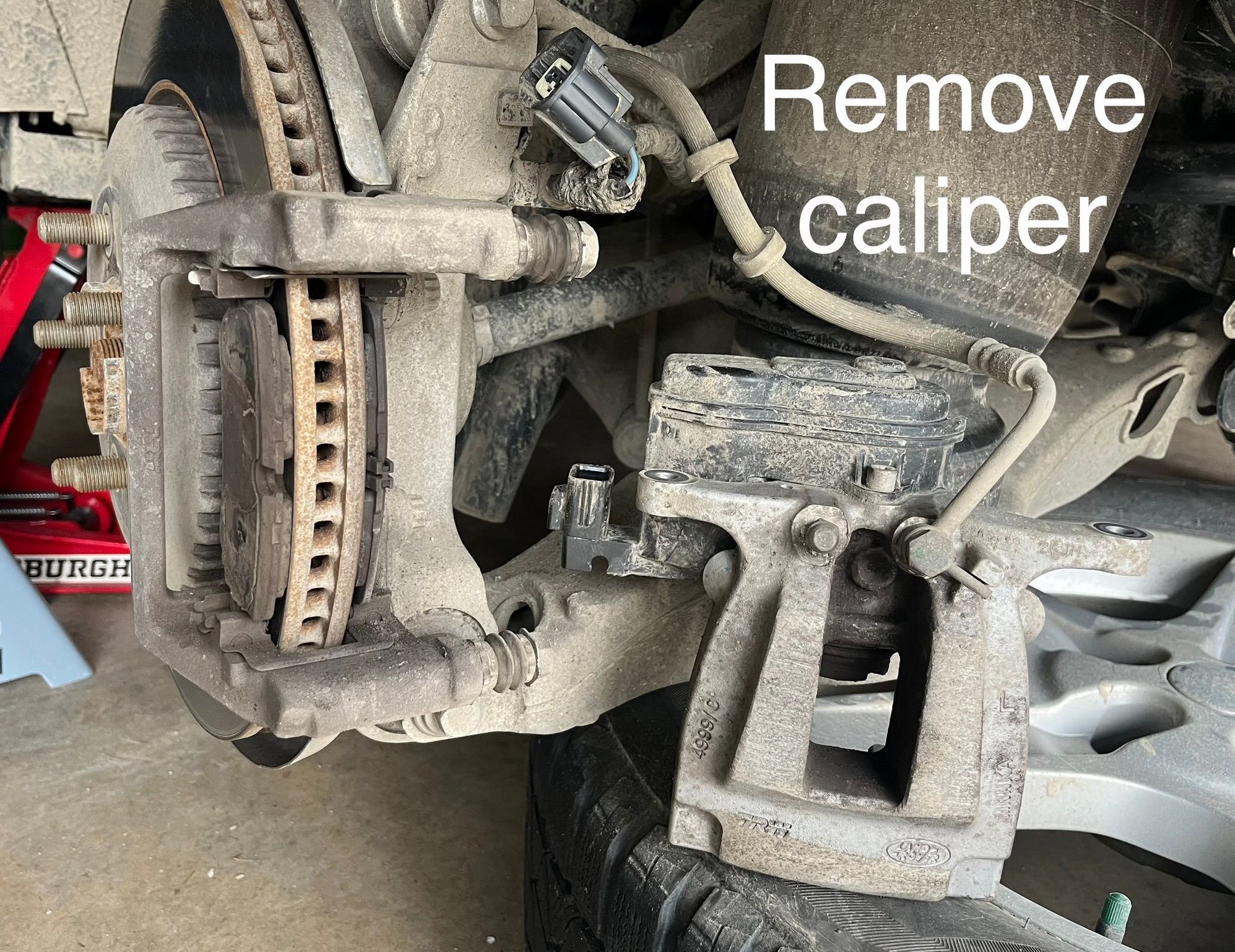

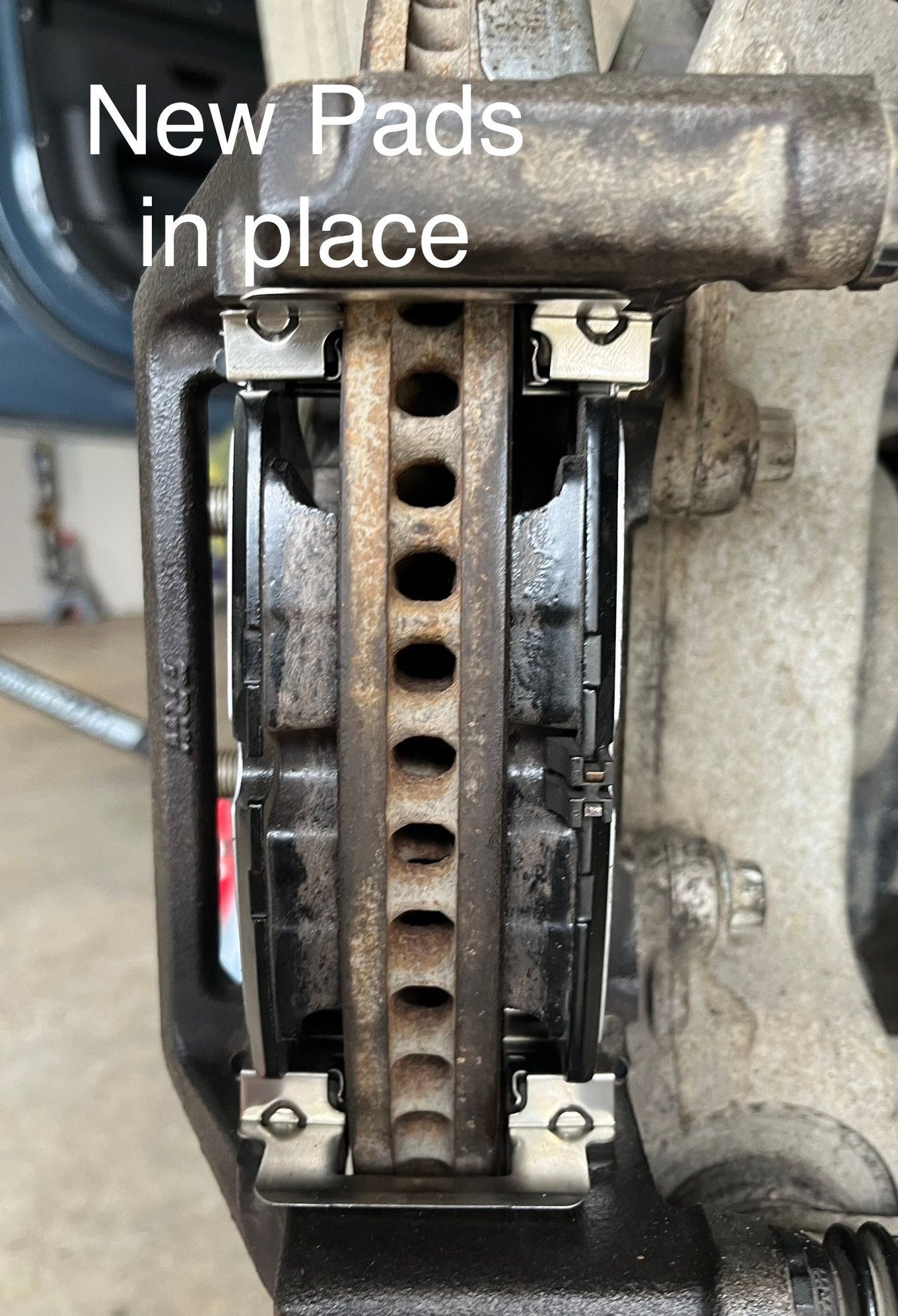

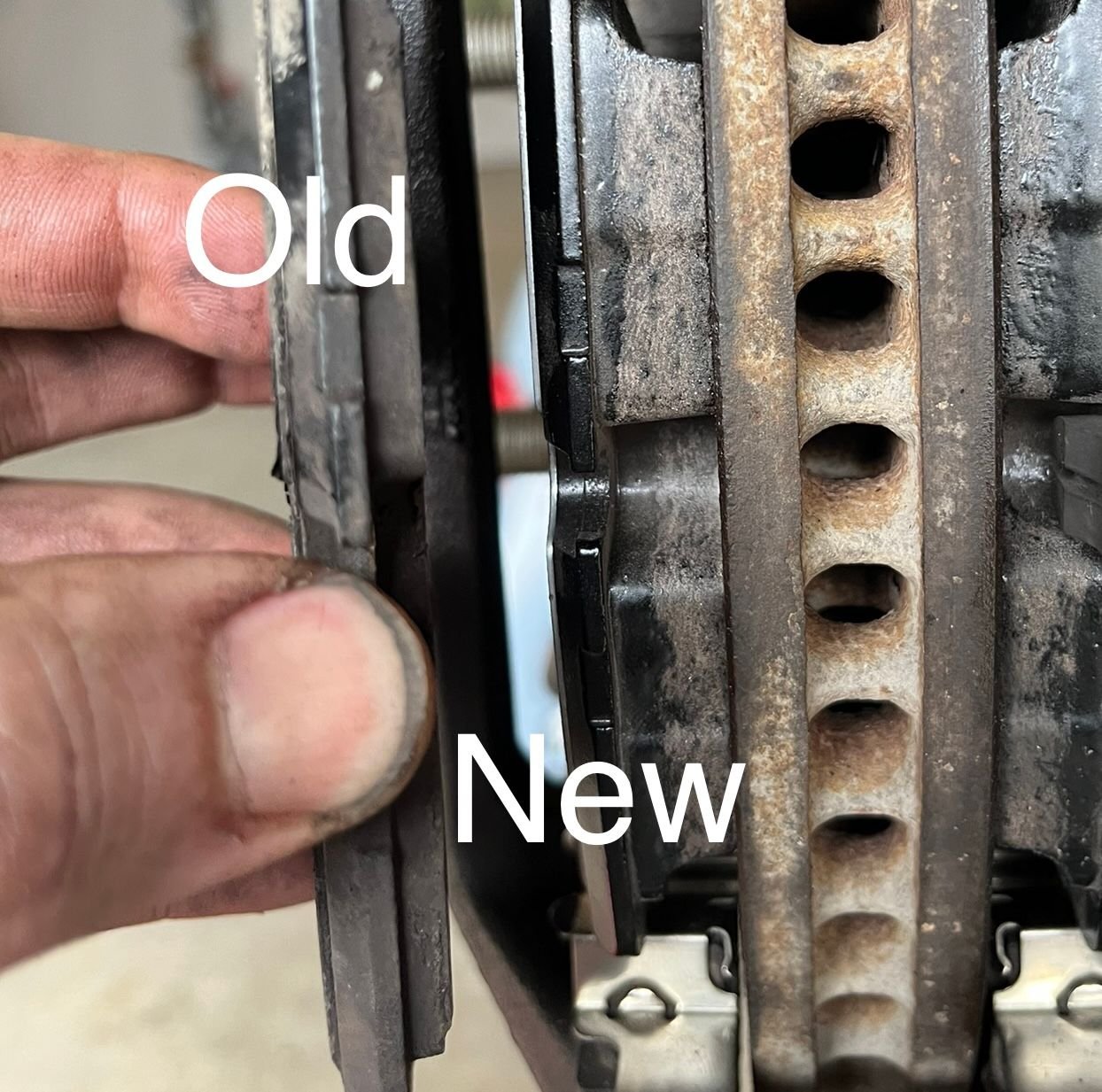

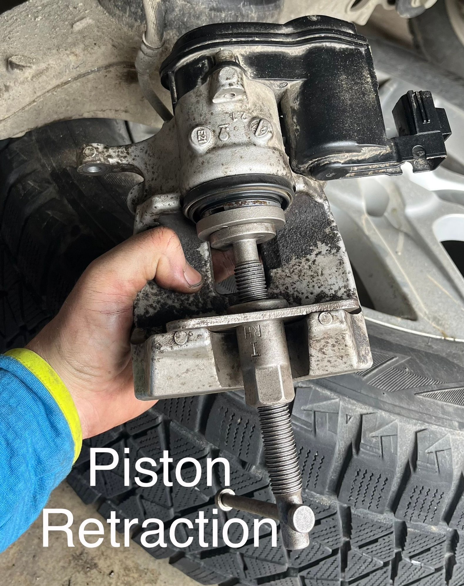

Default Rear Pads changed
58,000 miles
Rotors are fine
Pads have about 1mm remaining (Edit: before the wear sensor is involved, see last picture )
One more reason if you needed one to own a GAP IiD tool.

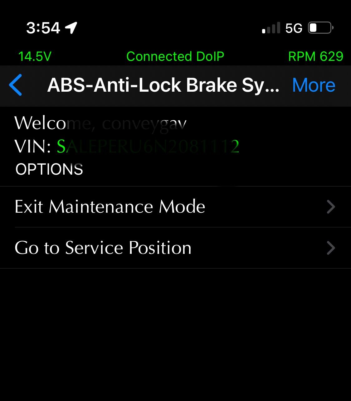

  • Activate ABS service mode with GAP tool
  • Remove some fluid from brake reservoir.
  • Chock the front wheels. Jack the rear.
  • Pop off wheels (one side at a time is fine)
  • Remove EPB electrical connector
  • Remove caliper
  • Remove and replace pads, anti rattle springs.
  • Remove and replace wear sensor (RHS only)
  • Use special tool to retract the EPB piston
  • Reposition caliper
  • Wheels back on.
  • Apply sequential pressure to brakes till a firm brake is felt.
  • Disengage service mode
  • Activate EPB.

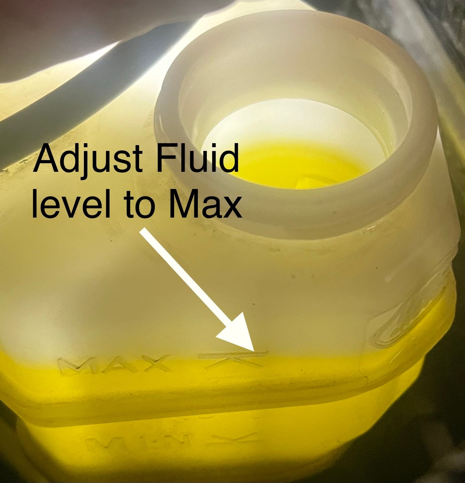

  • Adjust brake fluid levels to max.
  • Test drive. .
All went very smoothly. I’ll do the fronts next.

Readjust fluid levels
GAP IiD ABS service mode

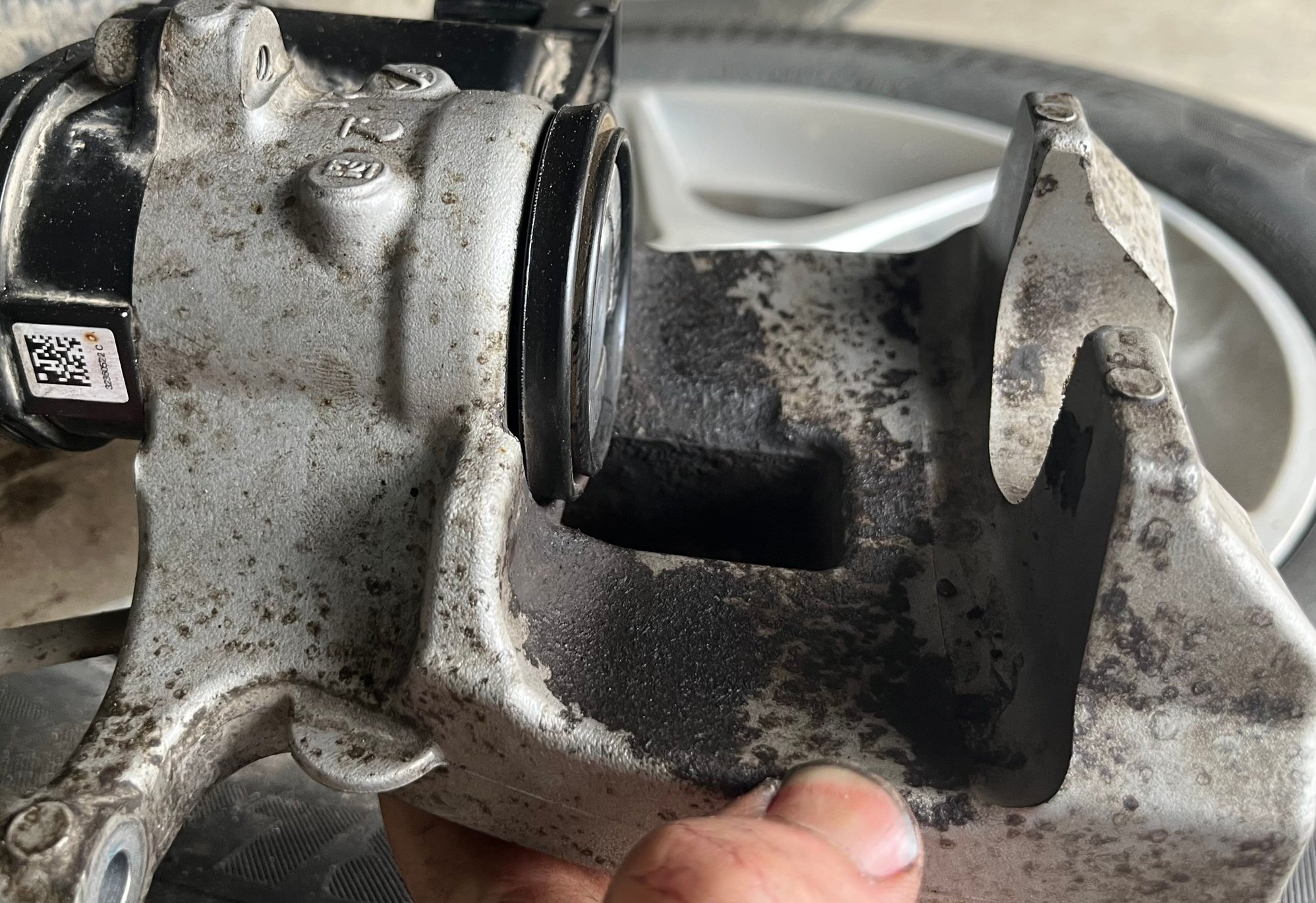

On the 1-2mm. I'm not sure where I should measure from but the pad material was looking very thin. I think my wear sensor would have been involved very soon. I think at almost 60,000 miles the rear pads owe me nothing so I'm happy to swap them out.
This was a very straightforward job. I've never done pads before so as usual was as slow as a wet week. Removing the old brake pad wear sensor was fiddly. A car trim tool popped it off with ease once I got the right one in there. Probably an hour or so for someone who's done it before.
You don't need a hanger or zip tie for the caliper. Just rest it on the tire that's off.
I wasn't sure how much crud to take off the caliper so just made sure the mating faces were nice and clean and that the piston seals were clean and in good shape. A little work with a wire brush on the caliper but more of a spit and shine than a thorough clean. I didn't want to damage any of the rubber components by being too ham-handed.

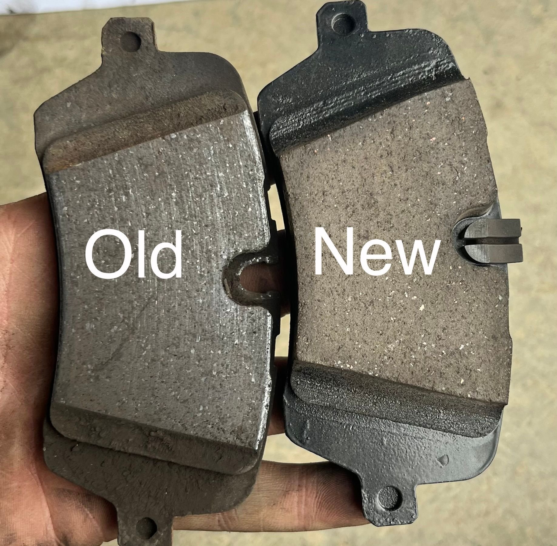

@GavinC Just curious about the difference in the area of the pad contact between the old and new pads.
Old Mar 10, 2025 | 11:25 AM
  #30
GavinC's Avatar
Joined: May 2021
Posts: 2,570
Likes: 3,646
From: Kirkland WA
The pad is sort of trapezoidal in profile. As it wears down, the mating area with the rotor gets larger.
The pads are OEM. New and old are the same.
