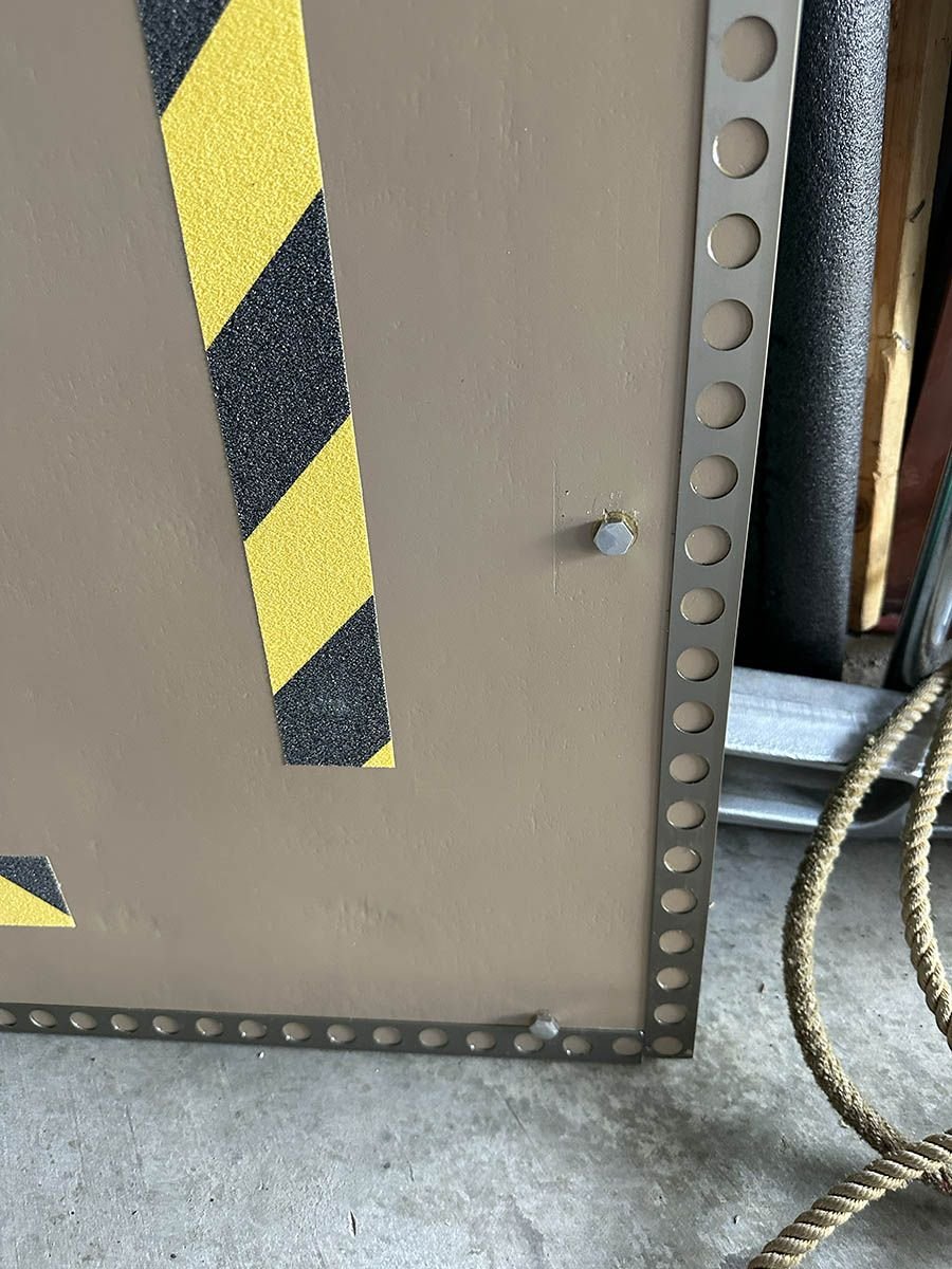

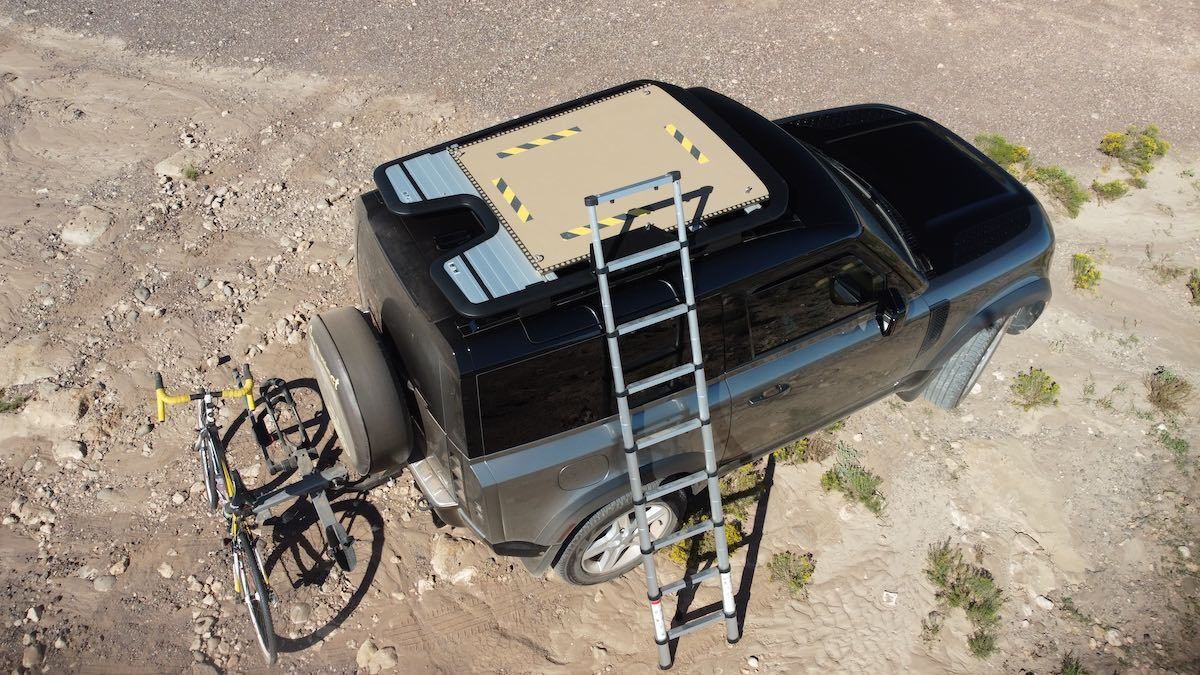

I have the OEM rack and would like to use it for photography as well. What type of platform are you using to manage and distribute the weight properly? Would like to learn about your solution and installation process. Thanks in advance.

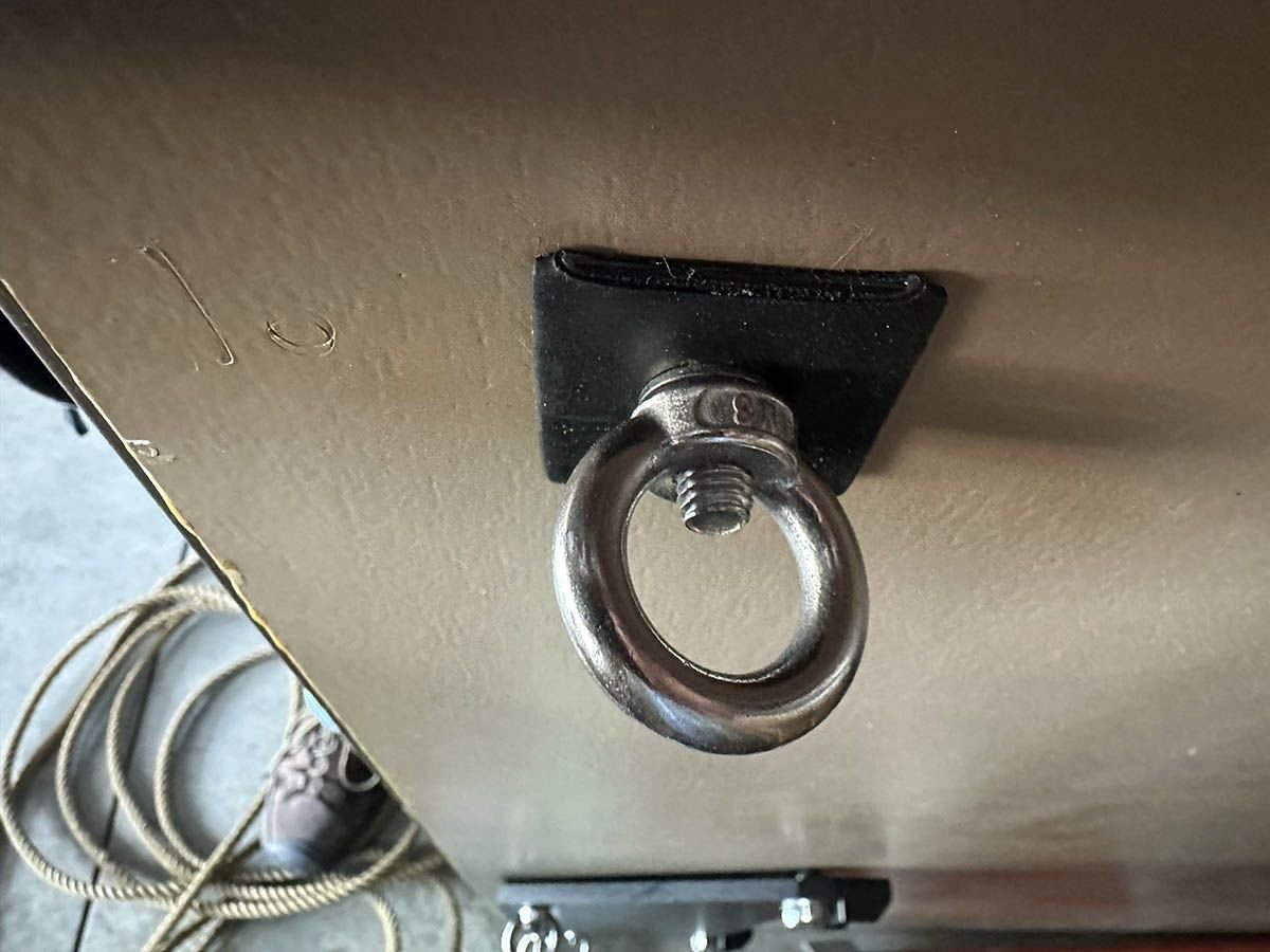

I have a whole lot of spare hardwood plywood left over from shipping one of the planes back from India. It is the metric equivalent of about ½". I cut it to be even with the size of the crossbars. You need to get it pretty close to exact, since the rack tapers fore to aft. I scribed the front edge after I had the kind of keystone shape established. Sanded the edges and put a very minor round on the edges with a router. Sanded and primed with a waterproof primer, couple of coats. Sand, then top coat, sand, top coat, about 4 coats. The metal edges are for tile, finishes edges, rather inexpensive, comes in several colors. This was attached with epoxy. The ladder attachment is a trapezoid made from Starboard® and some Front Runner Telescoping Ladder mounts, kind of metal 'U's. Ended up a trapezoid due to spacing on the crossbars and the ladder width. It is attached with some T bolts from Amazon and M-8 Stainless Rings. Four at the corners, two on either side where the ladder goes. The stripy stuff is a non-skid safety material. I also used some ABS 1/8 sheet between the crossbars and the underside of the ply, just to attenuate any potential rattling at highway speed.

I took a moment to get some detail pics of the platform. Realize that everything is reversed for storage at the moment. The little black squares are the items to avoid rattle. You have to remove the rubber strips and since the non-used crossbars still have the rubber, there is a bit of a gap between the platform and the bars. So these allow you to tighten the rings, really tight to keep the whole thing from becoming yet another source of noise.
