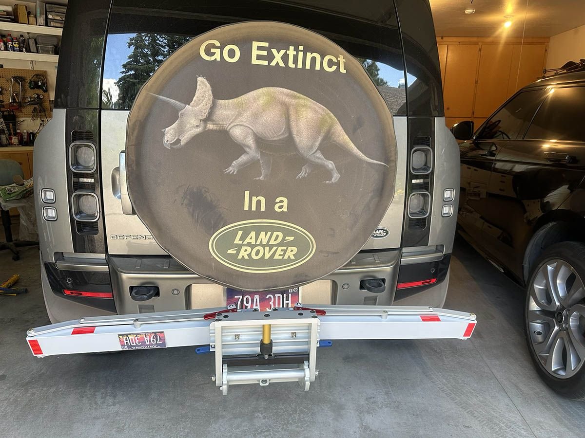

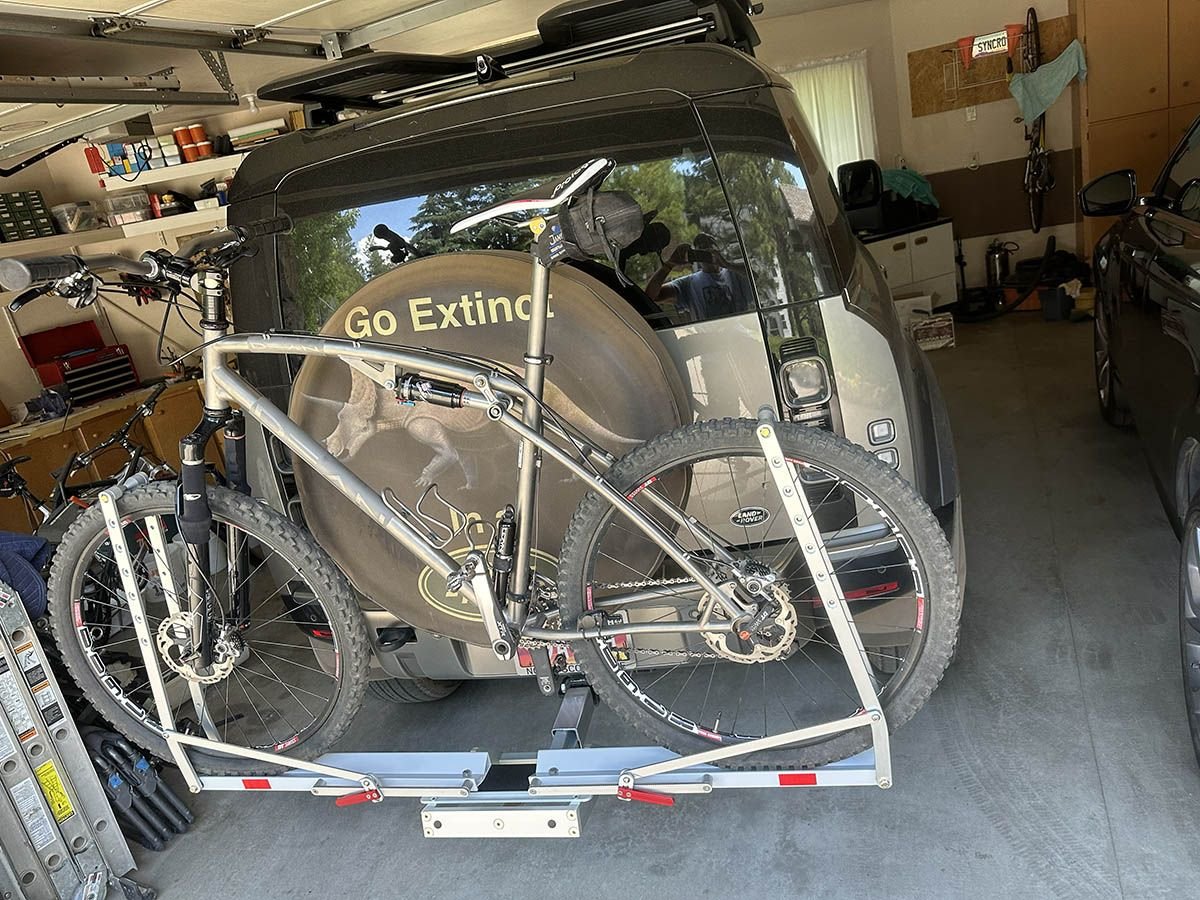

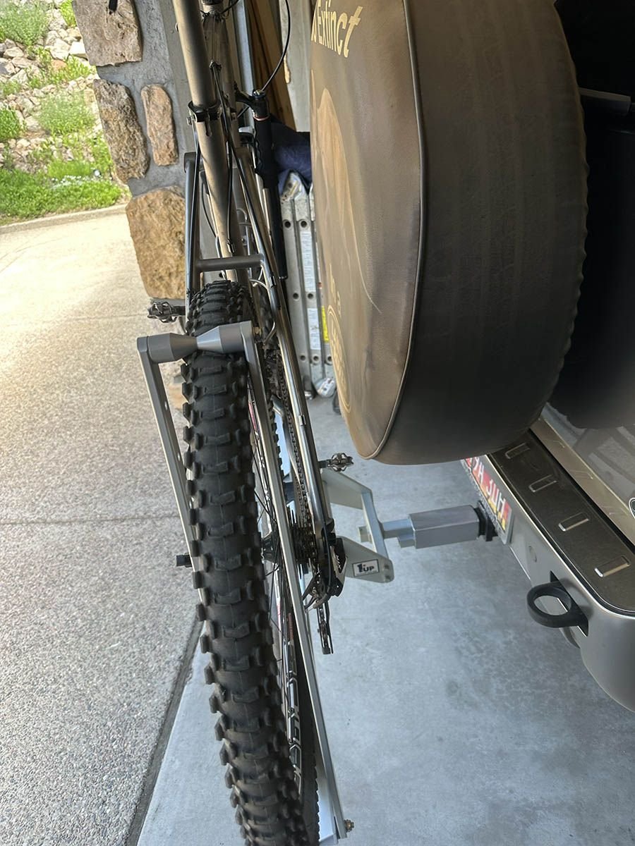

I settled last season on the 1Up. I did have a bunch of grief on the extension as well. I had an offset extension, but it kind of put it where I didn't want it, too low or too high. So I looked at straight extensions. They were all too long, all I needed was 6". So I just made one from bits of others and some square tube. No need for the holes, since the 1Up's system uses friction fitting with a large steel ball extending out and jamming the rack in place. I didn't want it too far out there or it gets all waggy should the road be rough. I can do crummy welding when I have to.

Thanks, that makes me think the 7” extension would work no problem!

It should. Since if mine had a hole, it would be a 6". Good Luck.
