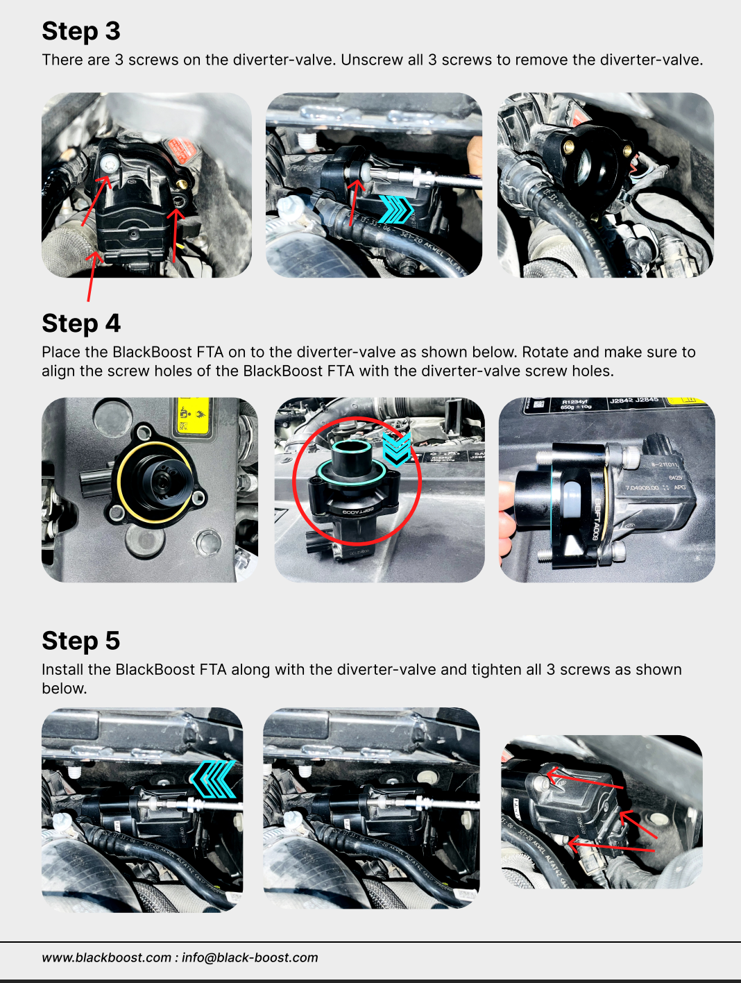

Didn't know it existed, but very interested! Looked em' up and hoped to find installation instructions to get a better sense of whats involved but I'm not seeing any on the website.
Please report back when you're done and let us know how it went. Even better if you can snap some photos while you're doing the work as a pseudo DIY write up!

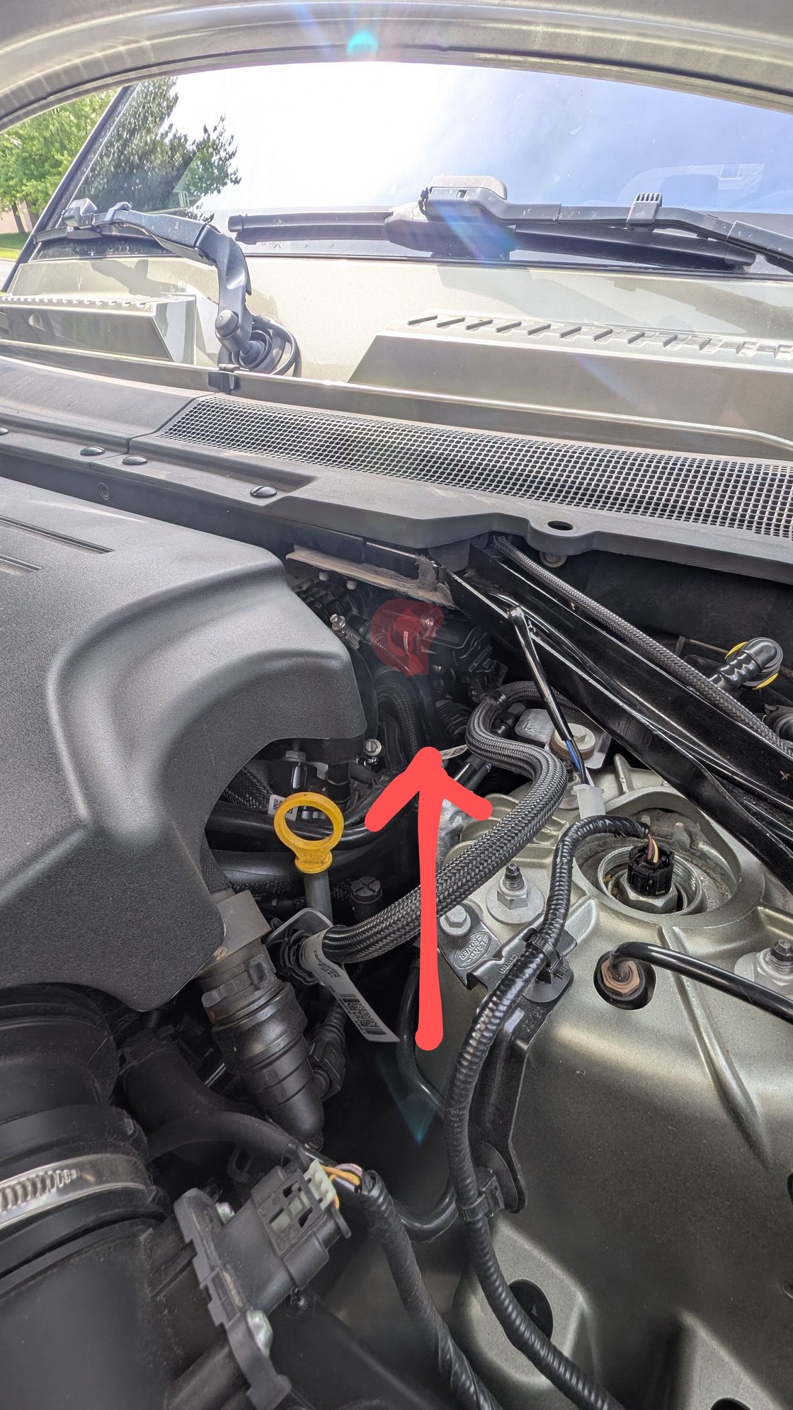

Very little as far as performance goes. It's supposed to allow ease on your turbo system as well as provide a cool swoosh sound when you get into the boost.
Old Jul 18, 2025 | 11:06 AM
landroverforums.buffed757's Avatar
Joined: Apr 2025
Posts: 31
Likes: 47
Installed, to do a video later.
