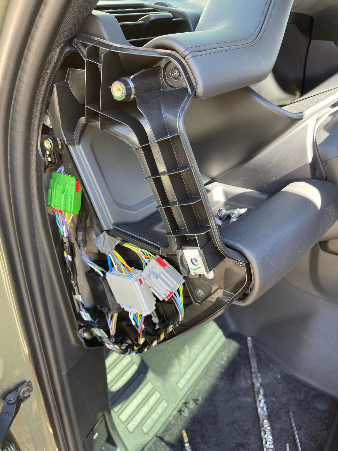

to get better access to mount the Redarc control box and the the panel with the parking brake, dimmer and blank panel, I removed the side panel of the dash that held on with the exposed Torx bolts. Easy to remove.
I unplugged the connectors to the parking brake and the dimmer and removed that small panel insert which allowed me to work on installing the Redarc **** from my work bench.

One of the posts suggesting taking off the side with exposed torx bolts but that wasn't super helpful for access in my case, so I ignored the side and went underneath entirely.
This was an easy route. After removing the bottom three screws at the footwell and disconnecting the light to remove the panel, just needed to reach my hand under and around to grip edge of whole e-brake plate + knockout and squeeze+push forward. Disconnected brake connector. See earlier post of what end result looks like (realized I didn't take a pic at the end, but it's the same as shown earlier)

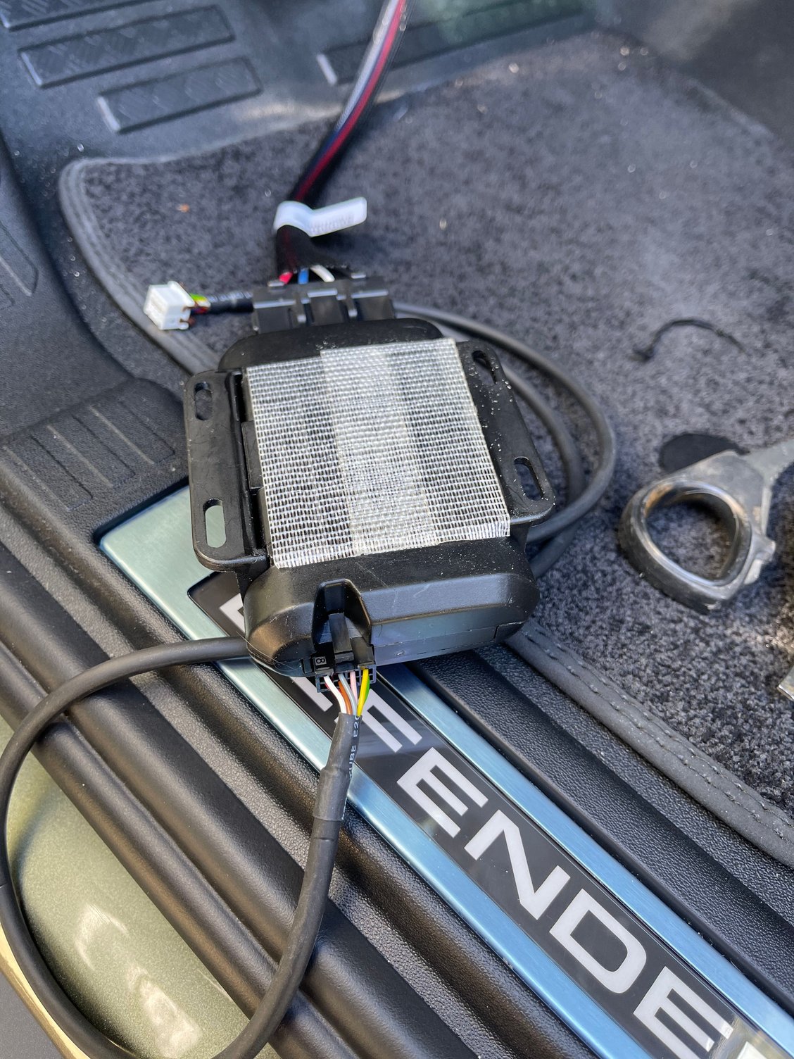

Like others, I also opted for double sided tape as a mounting solution.
Originally considered this location for the mount. It's just in the upper left, almost directly behind the open hole for the e-brake, but wasn't convinced that over time it would be the best place in off-road situations. Figured if the tape ever failed there's a possible chance it could get in the way of other things - probably overly concerned. Also didn't like it being attached to any other components.
As it happens, just behind and around is what is almost a cubby that if you maneuver the controller in right, almost fits perfectly with the tape + has some grip through pressure. Worst cast if it were ever to become dislodged due to failure of tape or whatnot it would be out of the way of everything; though doubt it's going anywhere. It's also out of the way if there are any future services and not in the way of other items.
