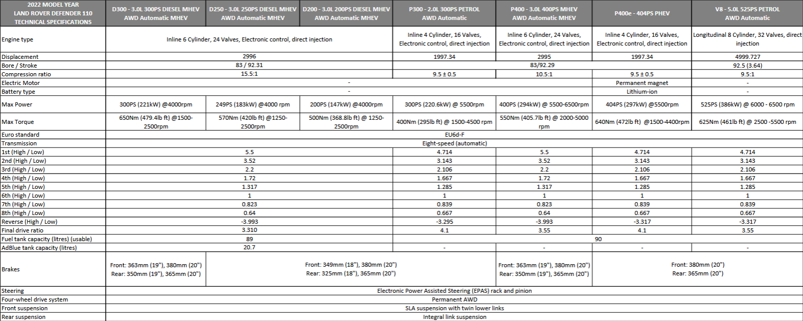

Per the published spec sheet:
Bear in mind P300s w/ the 19" wheels get the same brakes as the 18" wheels - that's what I have on my P300 that came with 19" wheels.
It's really not that complicated.

The complication comes in when calls to two different parts suppliers, visits to numerous manufacturers and suppliers websites still returns different results. The specs chart provided above would indicate 380/365mm rotors on my P400 - petrol since I have 20” wheels. But nashvegas says a good indicator is that the 350mm have the flutes or ribs on them. My original rotors have the ribs, so I’m assuming mine are 350mm. Not fully convinced which are on mine. I guess I’ll have to pull them off, although I would have preferred to do it all at once.
