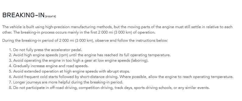

Finally got delivery on a new P400 and love the drive. a friend asked me if I were keeping it local (no highways) until the engine had some milage on it, maybe a few hundred on the odometer. That type of advice - to me - seemed really odd and maybe was what folks did in the 1970s?! Their advice boiled down to not taking a new car (engine) on the highway (going 70 mph+) for hours was not a good thing for the long term health of the engine. What says folks that know this stuff? Bad advice? thanks.

Modern engines don't need to be broken-in. Engine construction, piston ring technology and cylinder liner technology has improved so much in the past 10-20 years. It wouldn't hurt to take it easy the first thousand miles or so, but it isn't necessary by any means. I didn't drive the crap out of my car right when I bought it, but I didn't baby it by any means.
JLR recommends to take it easy the first 2000 miles, but like I said, it isn't necessary. Look at all the press cars that get delivered and have the **** beaten out of them right off the bat, and they don't have any long-term issues.

Back in the day, there were definitely reasons why you wanted to break in a new car harshly. I put a brand new P400 in my H1 back in 2022, and because its an IDI diesel whose design dates back to the 70's with some of the worst manufacturing tolerances in the automotive industry - for the first 500 miles I drove my tank like I stole it, just to seat the piston rings. I tried not to sit at a constant RPM for more than 5 seconds at a time.
However, like others have said, these days - that type of treatment isn't necessary.
"Mechanical Sympathy" is the name of the game.
