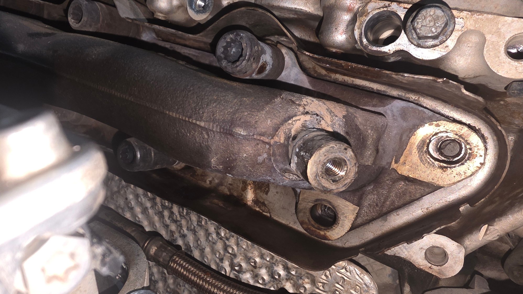

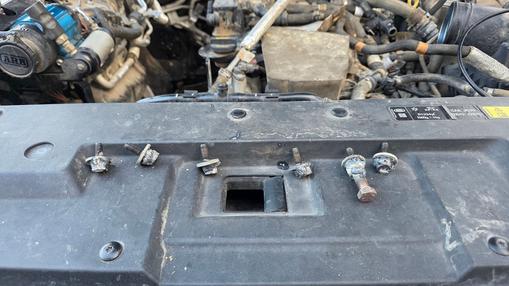

Just spreading the word. If you're hearing a rattle/ knocking during cold starts on your p400 defender, your exhaust manifold bolts are broken. Unfortunately im seeing a lot of defenders with this issue. It's a job I do not recommend for a DIY person unless you have professional tools and a welder. I just got done doing this on our Defender where 6 out of the 13 bolts were broken. Took 3 days.
Why is this happening? The exhaust manifold bolts are made from inconel and are stretch to yield. After the the torquing process they only see about 15-17 ftlbs of torque. And unfortunately you can't tighten more as they just stretch without providing more clamping force. Inconel is great for high temperature but not great with vibrations. After some time of expansion and contraction due to the engine heat cycles, they break. And to add insult to injury, they are loctited with make extraction more difficult. Welding nuts to them seems to be the best method to remove them.
We are going to come up with new hardware for this but for the meantime. Replace with what's available. As soon. As you hear a rattle, get it done before you end up like us with half of your bolts broken which will only add to the labor.
Only way to see the broken bolts are by removing the heat shields around the manifold. The gasket has a heat shield intergrated to it making it difficult to see without removing the shields surrounding the manifold.
4 broken bolst on the left sife of the manifold/turbo. You can see the top one sitting on its side
4 broken bolst on the left sife of the manifold/turbo. You can see the top one sitting on it's side
2 broken bolt on the right side

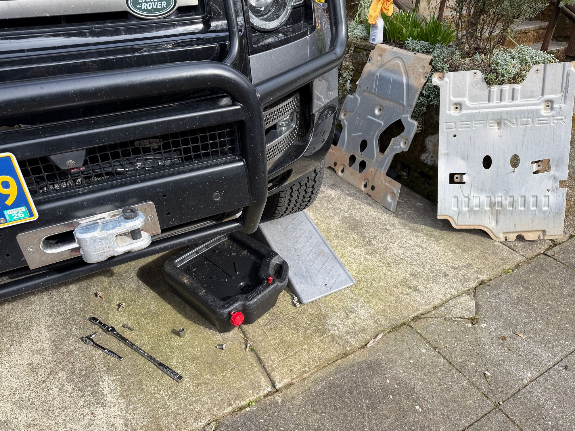

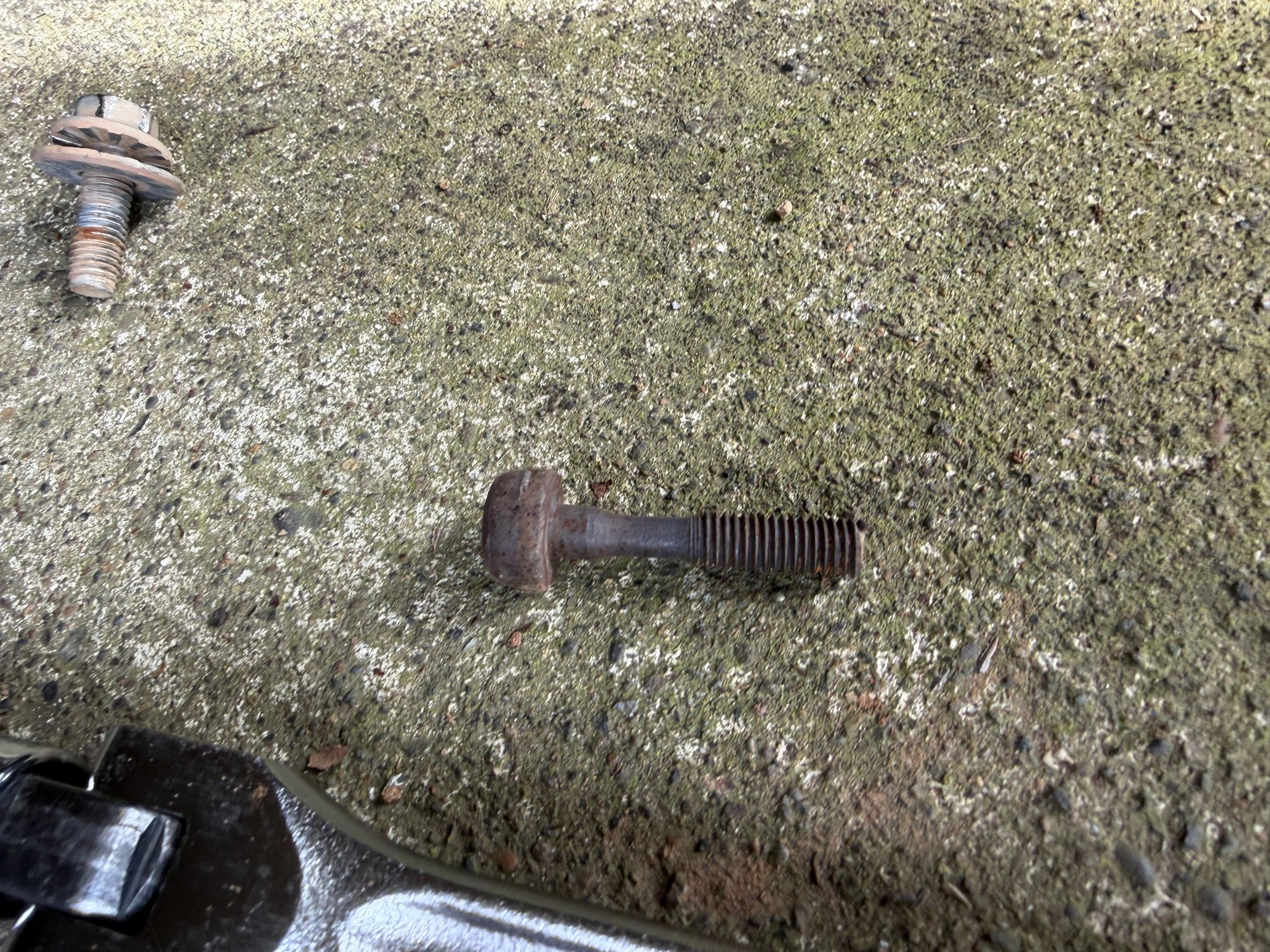

BEYOND annoyed to find this today on mine with 31k miles on it. Was changing front diff oil and this was on top of the skid plate. Unacceptable mileage for a failure like this.
It’s p400 exhaust manifold bolt recall time, LR?
