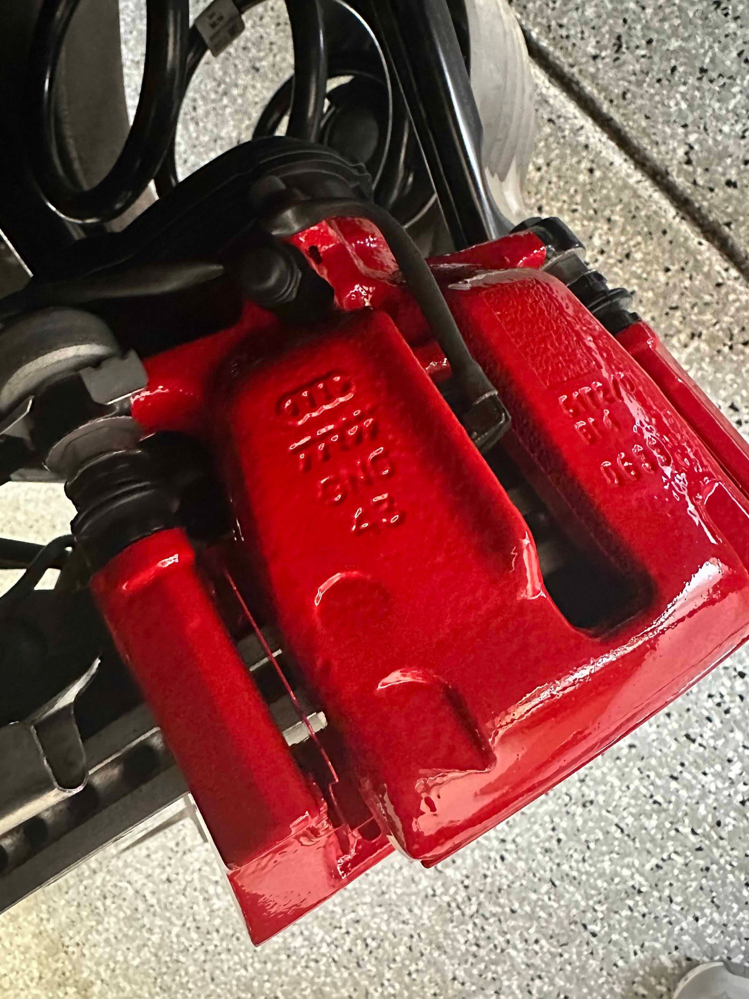

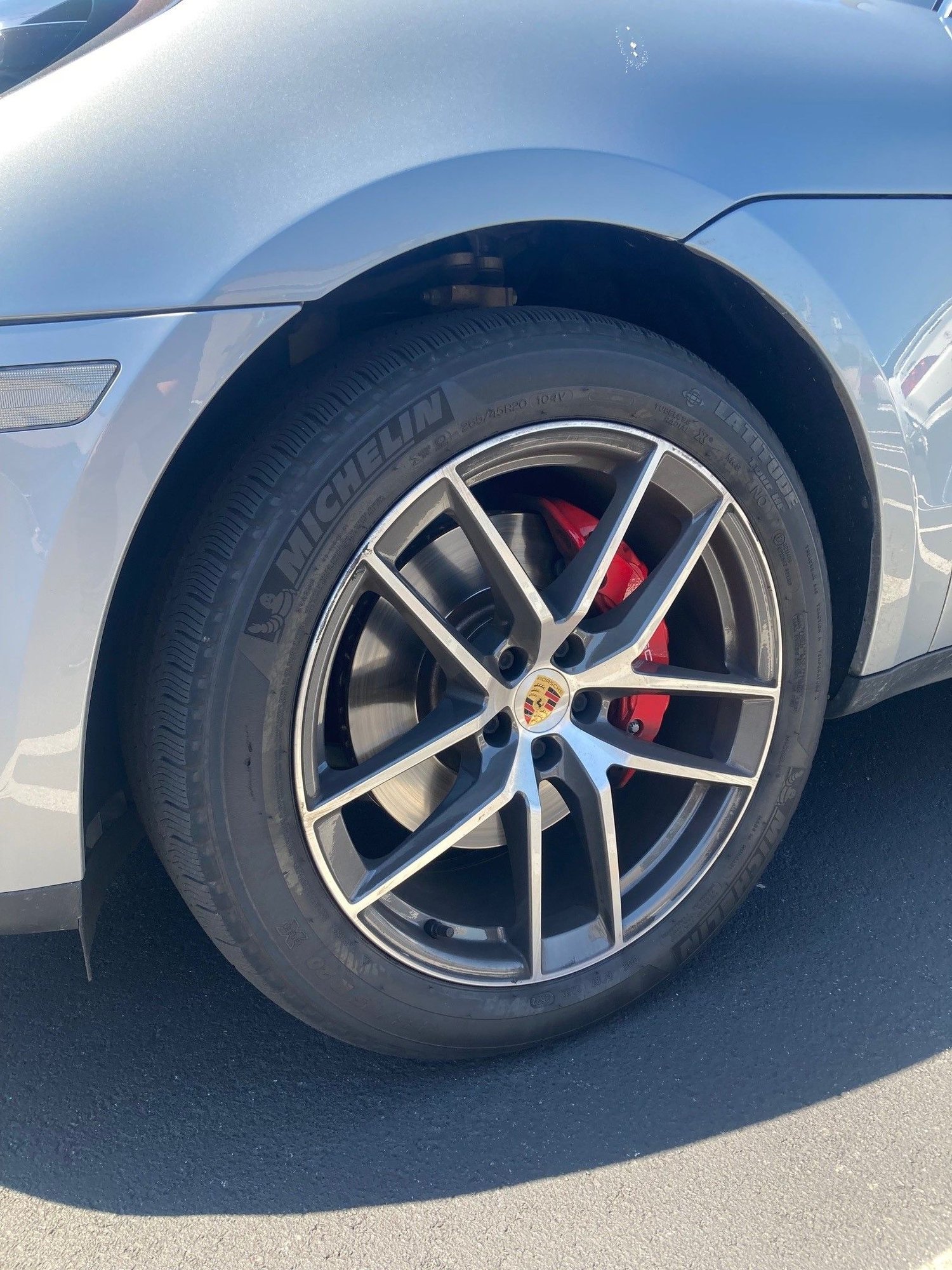

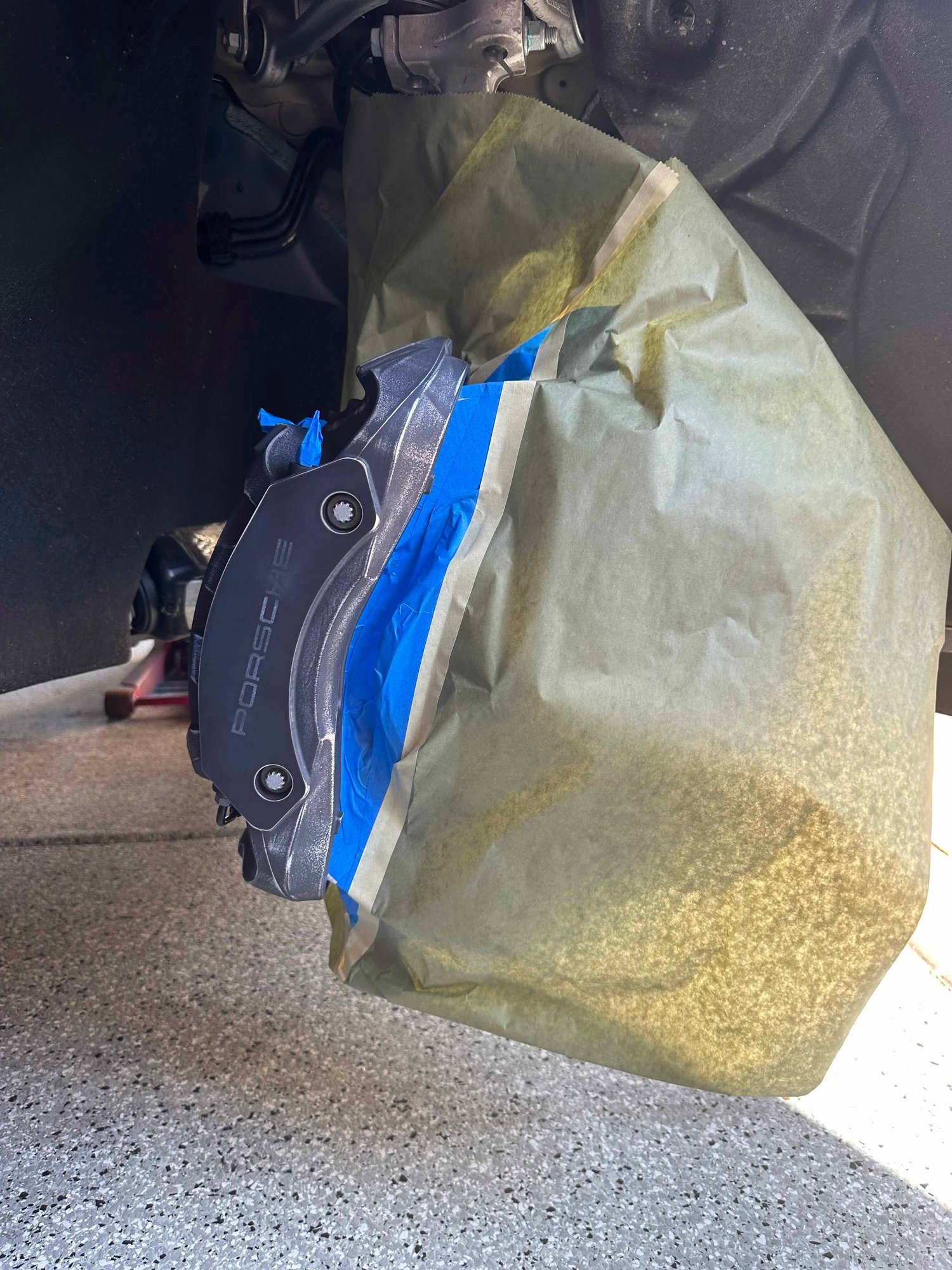

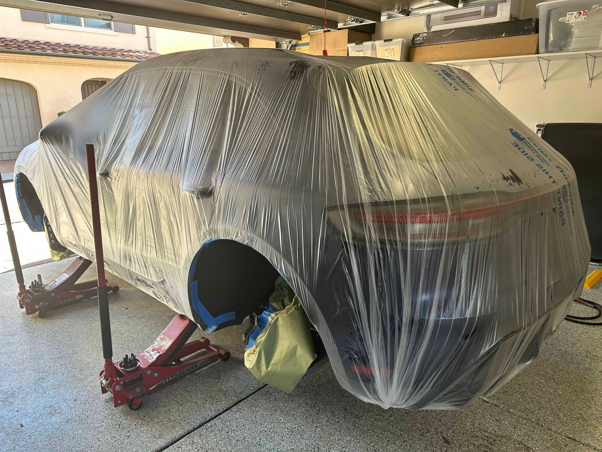

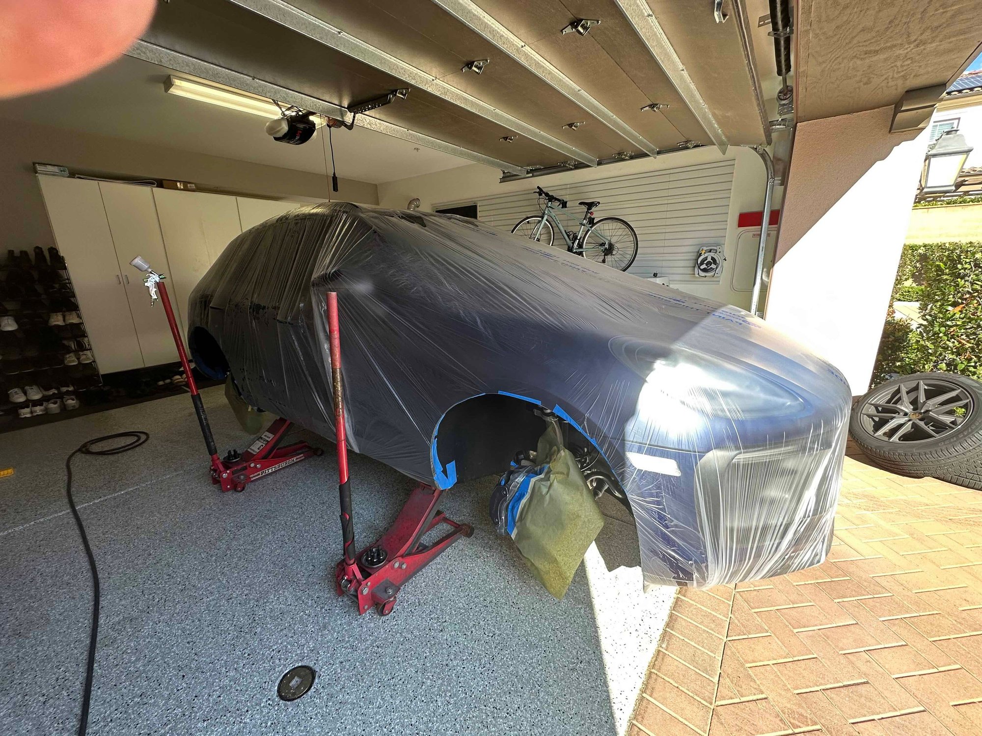

New to this forum and catching up this thread and just want to share my caliper paint project with my wife's car..
Masking > Sand > Paint prep > Paint (2-3 coats) > Apply Sticker > Clear Coat.
Don't use any caliper paint guys who just use spray can for caliper paint.
If anyone is in OC or SoCal area, I can recommend this guy.

I also have a 95B.3 Macan S (2023MY) and you matched the caliper color perfectly! The Guards Red calipers were standard on my S. I also have the same clear side markers, too! Looks much better on my Dolomite Silver Macan. How do you like your Macan? Correct me if I'm wrong, but it appears you have a T based on the grey mirrors.

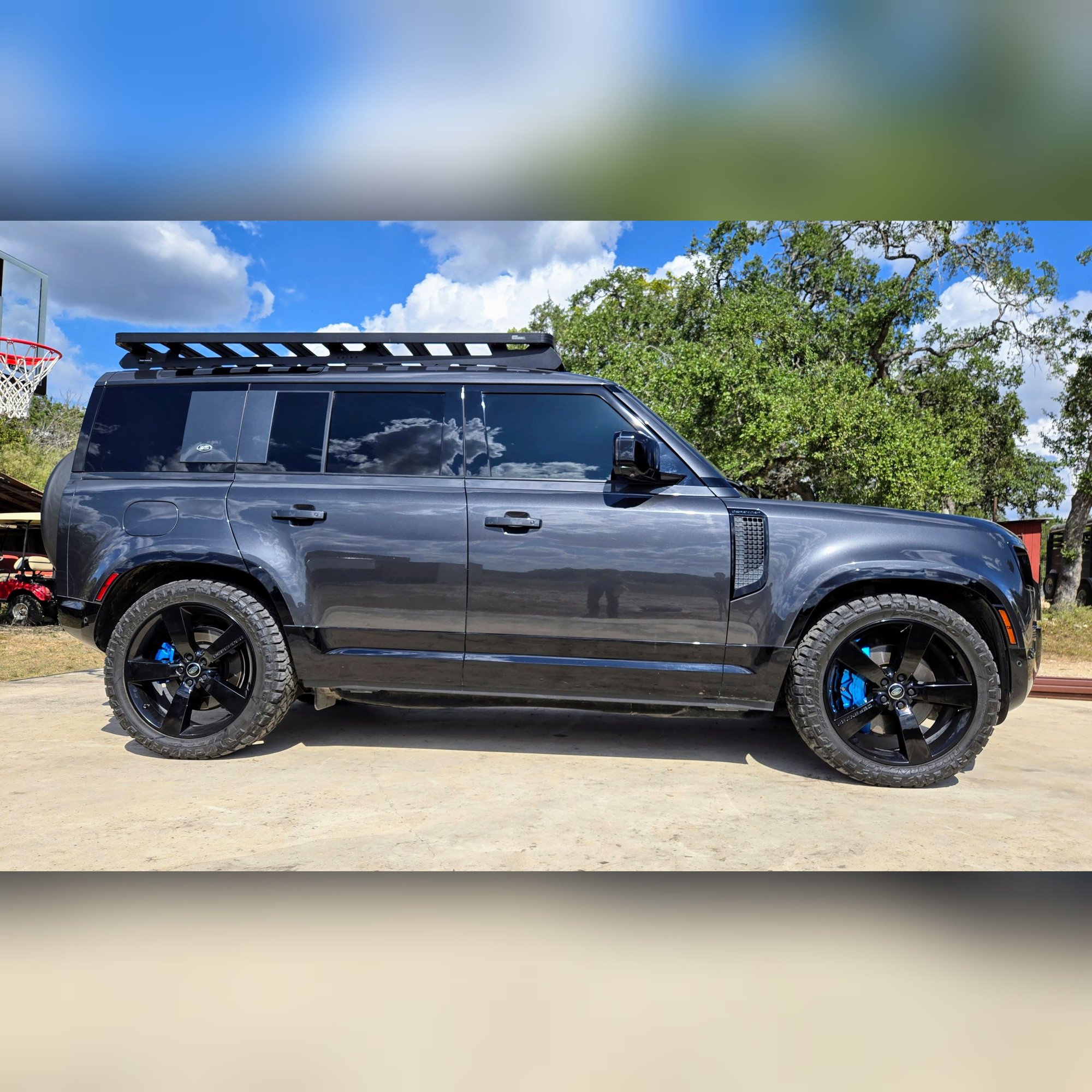

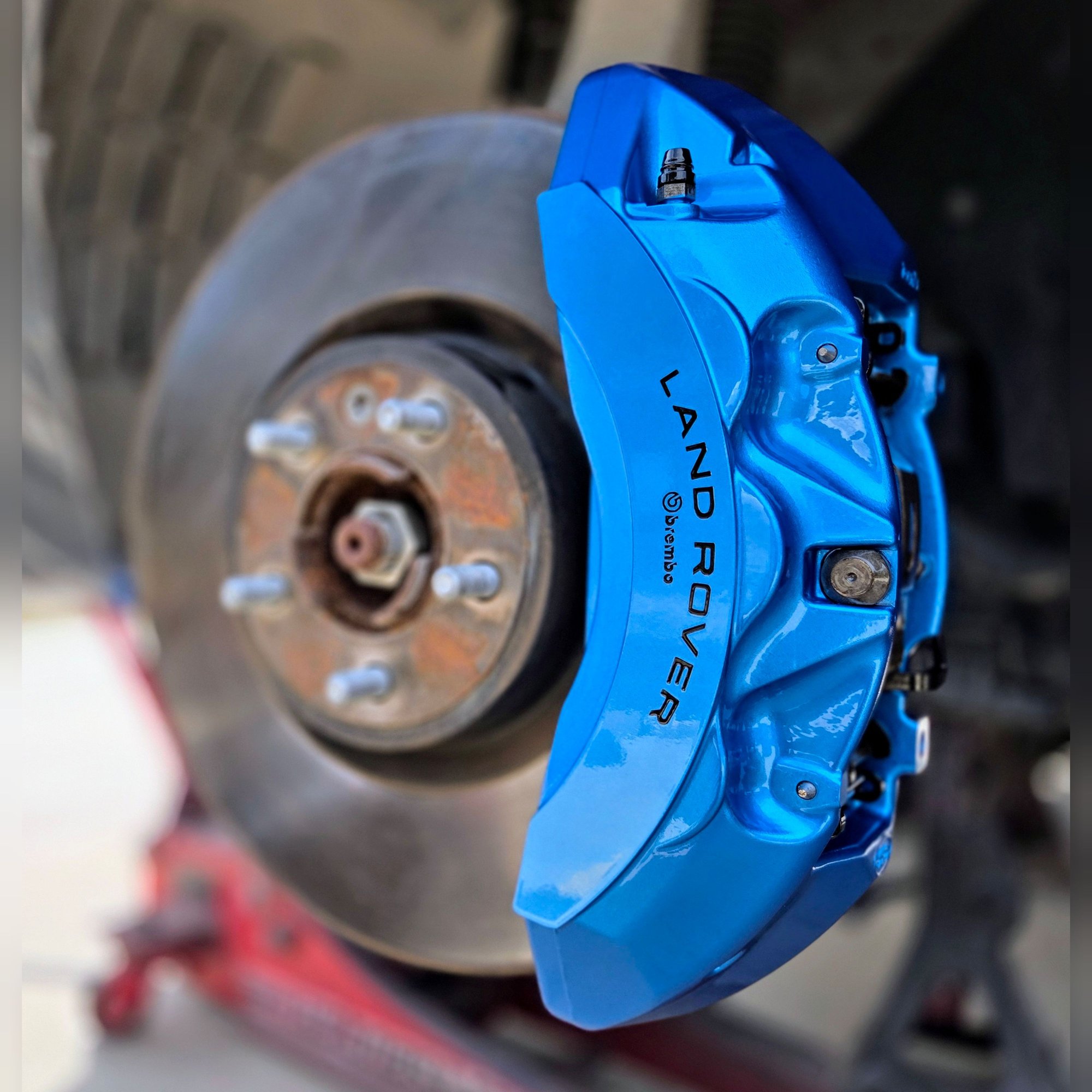

Just came across this thread.
This is one of many that we've done as close as possible to replicate the blue. After searching through alot of swatches, we went with Mopar B5 Blue to achieve a more anodized look. Hardware and pads were removed, pistons masked off, rotors, suspension and full vehicle masked off and calipers painted with all custom made-to-order PPG automotive 1k primer, 1k paint, applied decals and sealed them in 2k clear.

Looks great! The B5 Blue is very close to the OEM Xenon Blue calipers. Well done!
