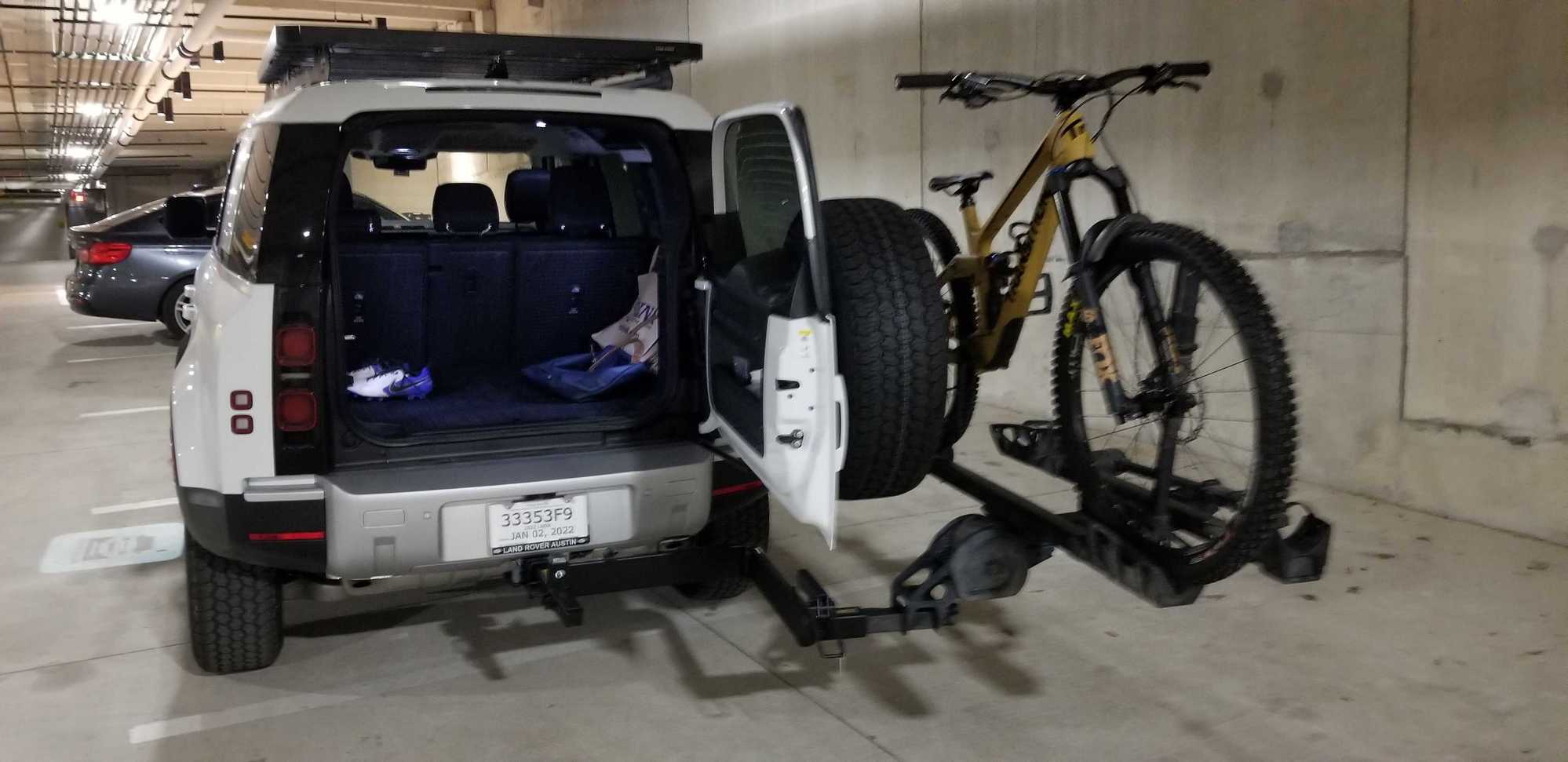

You can't really open the door with bikes mounted on the back of the car. You can slightly if you drop the rack down but the best thing to do is to get a swing away. I got this Saris for $350 and love it so far.

One other thing, because of the rear tire on the door depending on the rack you cant collapse it up without an extender. I wanted to be able to access the back when camping etc so I went with the swing away which allowed access to the back and acted as an extender to allow for clearance of the tire when folding the rack up.
Hope this helps.
