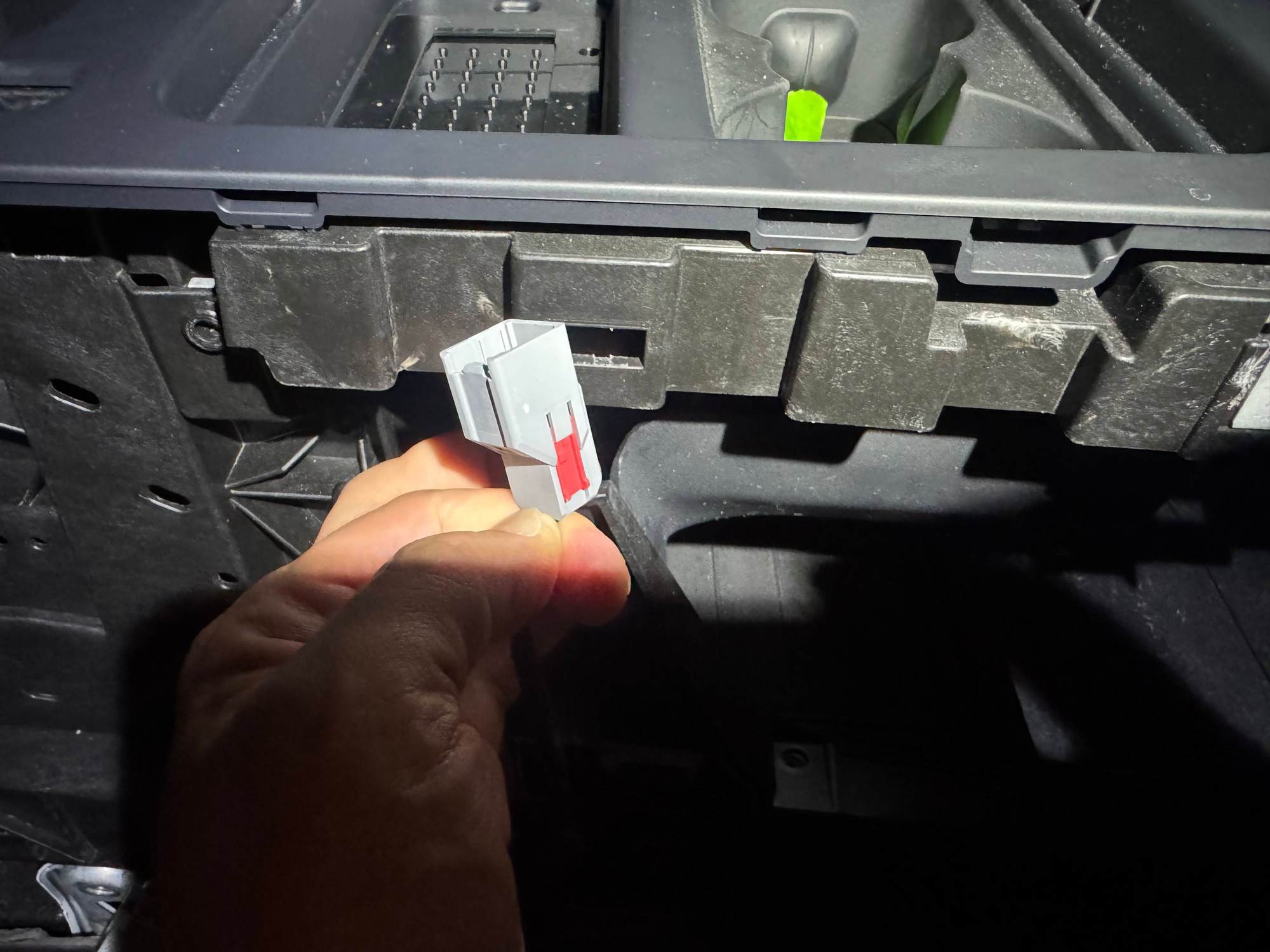

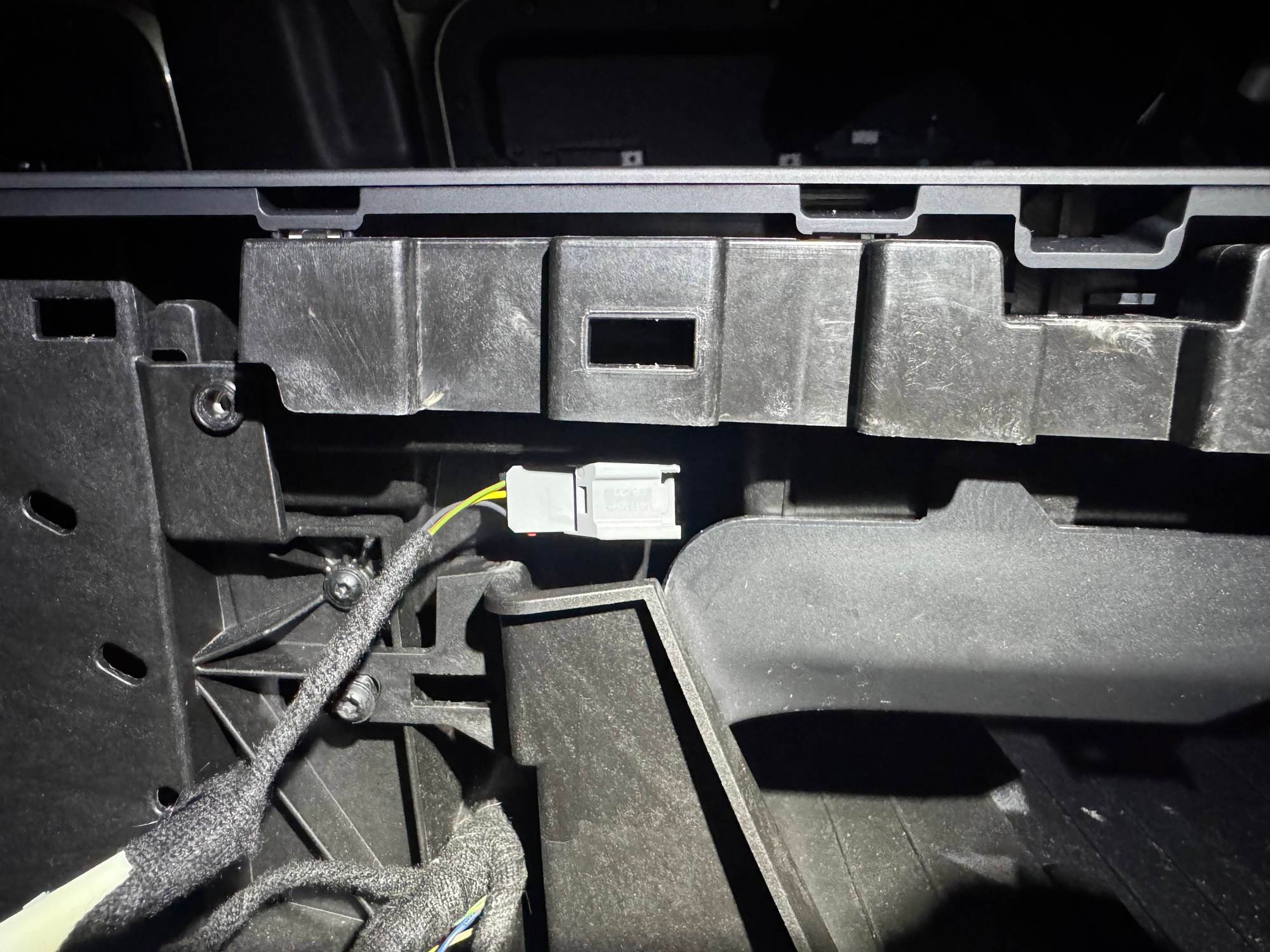

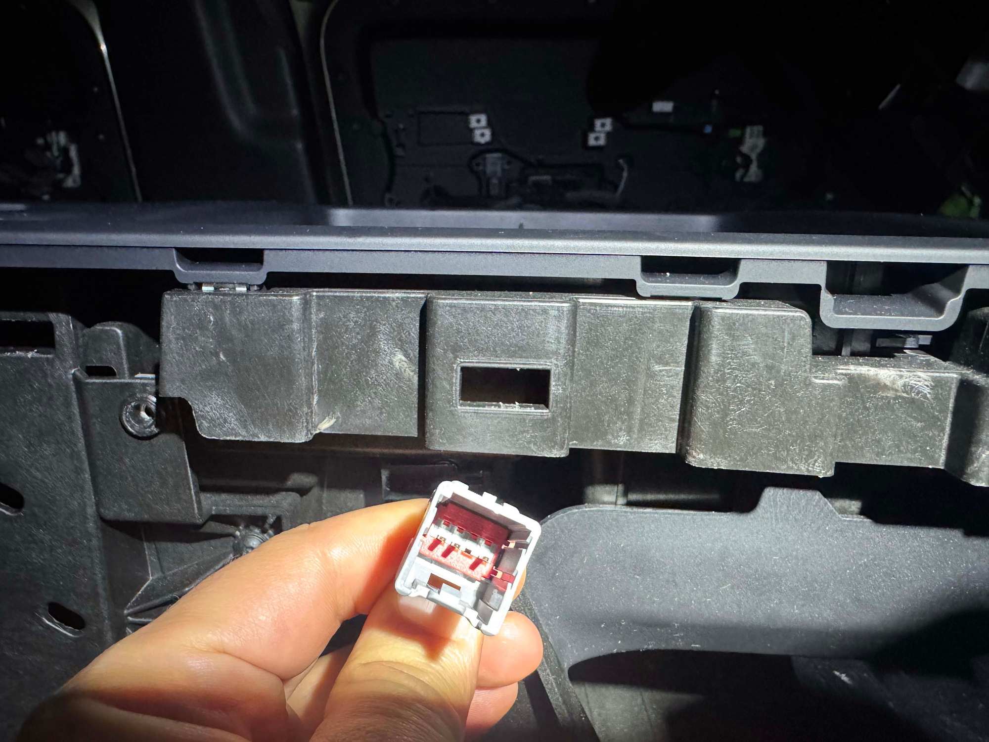

I came across a wire + connector buried behind the passenger (usa) side of the center console finisher/card. It wants to connect to something toward the front of the console but is not, and I wonder what it could connect to if an option was selected?
To note this is from a 2020 P400 SE. No fridge selected, but seems that would need an extension and not sure if this for it anyway. Also, car does have the wireless charging bit.
Images below for reference.

Looks like I found the answer, ambient lighting:

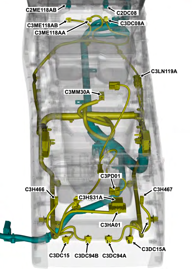

I couldn't find anything about it in the workshop manual, and it doesn't say what the connector is for. I'd say it is most likely for the fridge, or could be for the wireless charger. Usually cars are pre-wired for optional extras that may or may not be selected. For example, all Defenders come pre-wired for illuminated treadplates, even if you didn't order them. This is everything I could find about the console and the wiring diagram for the fridge:

Thanks! I think the connector is higher than those two images. I’ll take a look at ambient lighting in the workshop manual.

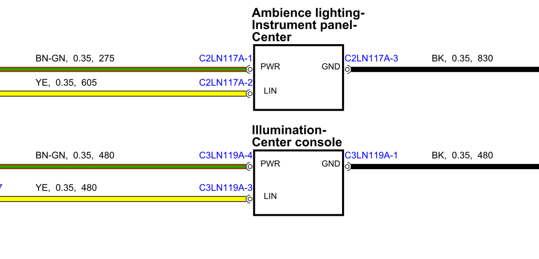

It's most likely CLN119A for the centre console illumination
Console connectors from rear
Ambient lighting
Ambient lighting
