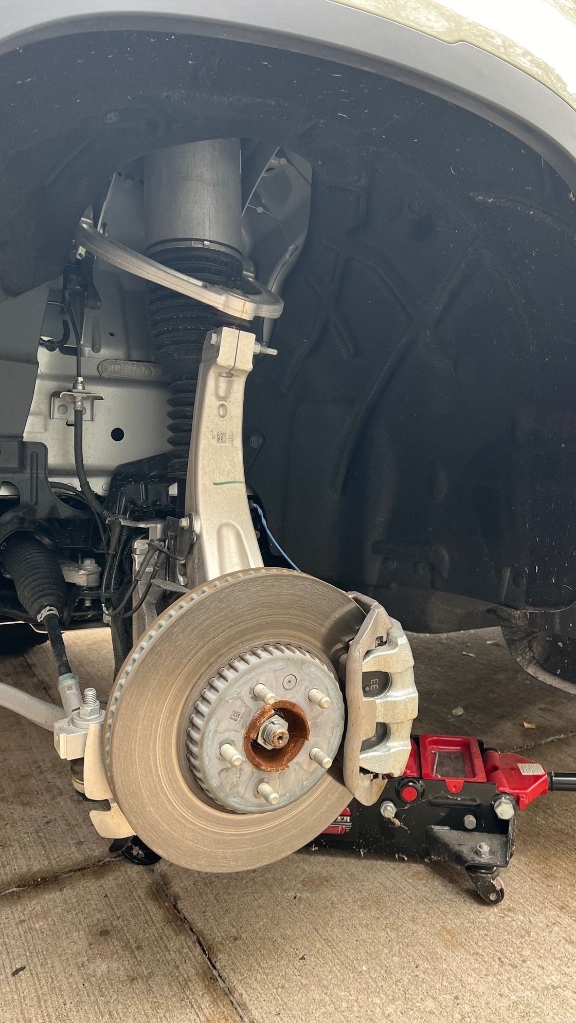

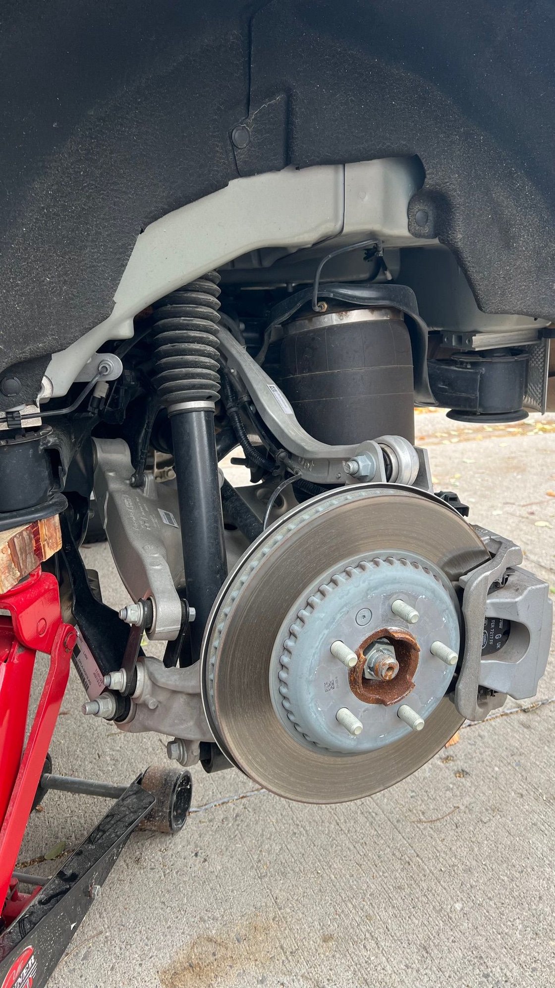

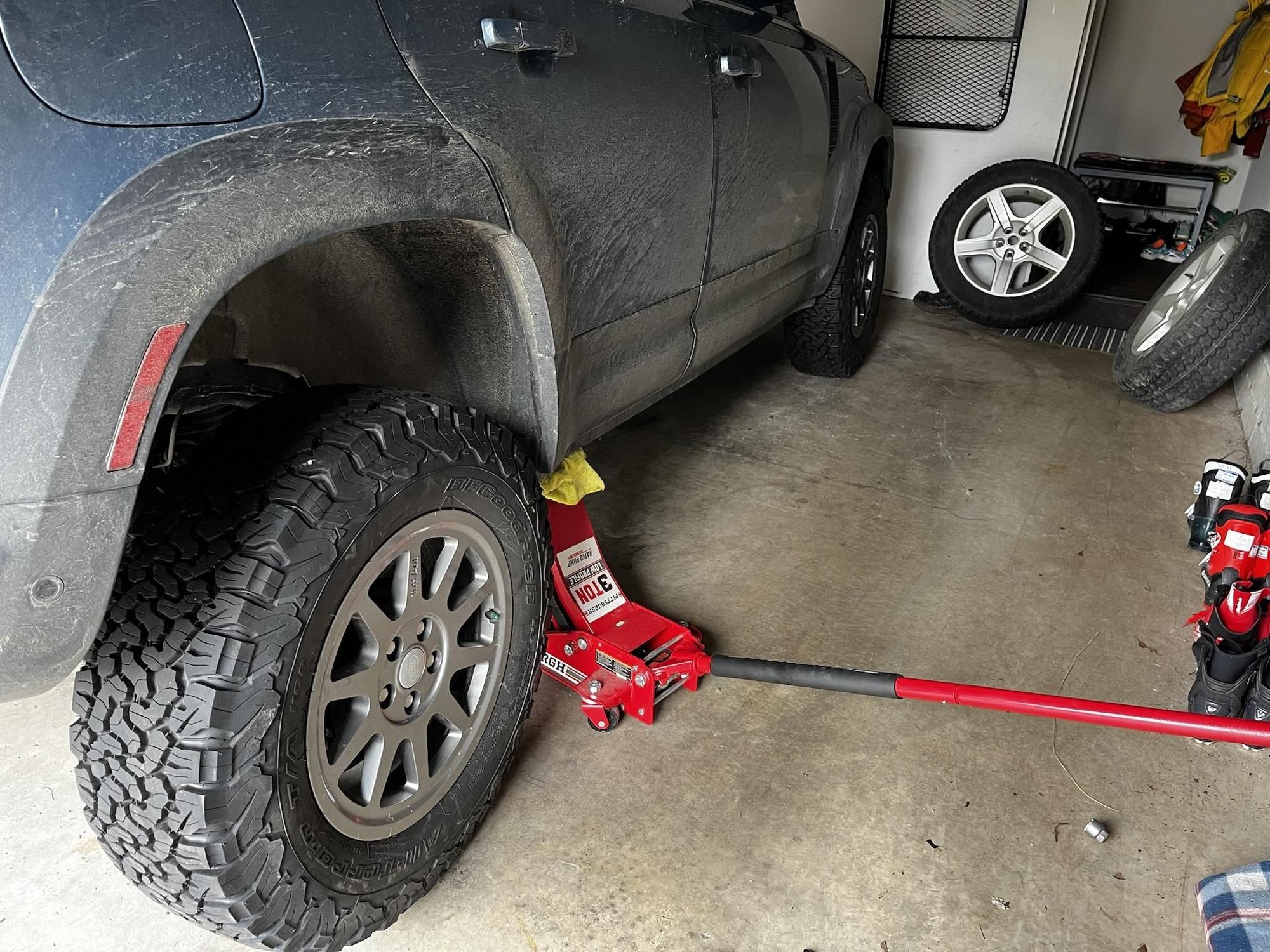

I do my seasonal swaps twice a year.
I've done it with the OEM scissors jack and it's a lot of work.
A floor jack (Harbor Freight have mine on sale at the moment) really makes life easy.
Plenty disagree with this but repeated multi-wheel swaps have verified this.
Lower the car to access height, turn it off and leave a door ajar. Now all 4 corners are lower and your jack will get the wheels off the ground as needed with greater ease. I use the pinch welds as jacking points and have a 3T floor jack.
  • Have your wheels ready to go. Chock the rears/fronts as needed
  • Use the jig to assist in position of the new wheels. Just screw it in a little bit. The tolerance on it is very precise so it can bind up a bit if the wheel is not on correctly.
  • Tighten the bolts in a star and have a torque wrench set to 104 ft lb or the equivalent setting in Nm (140 I think and it's in the user guide)
  • Torque check after your first drive.
  • Autozone provide loaner torque wrenches if you don't want to but one but it's useful to have.
  • Label your tires for a 5 wheel rotation pattern for next swap.

20+ at home tire changes on the Defender and for me the jury has very much delivered its verdict.
Lower the car, turn it off, crack a door and the suspension doesn't hinder you. No waiting is needed.
Pop it into off-road height and my floor jack is rendered useless.
