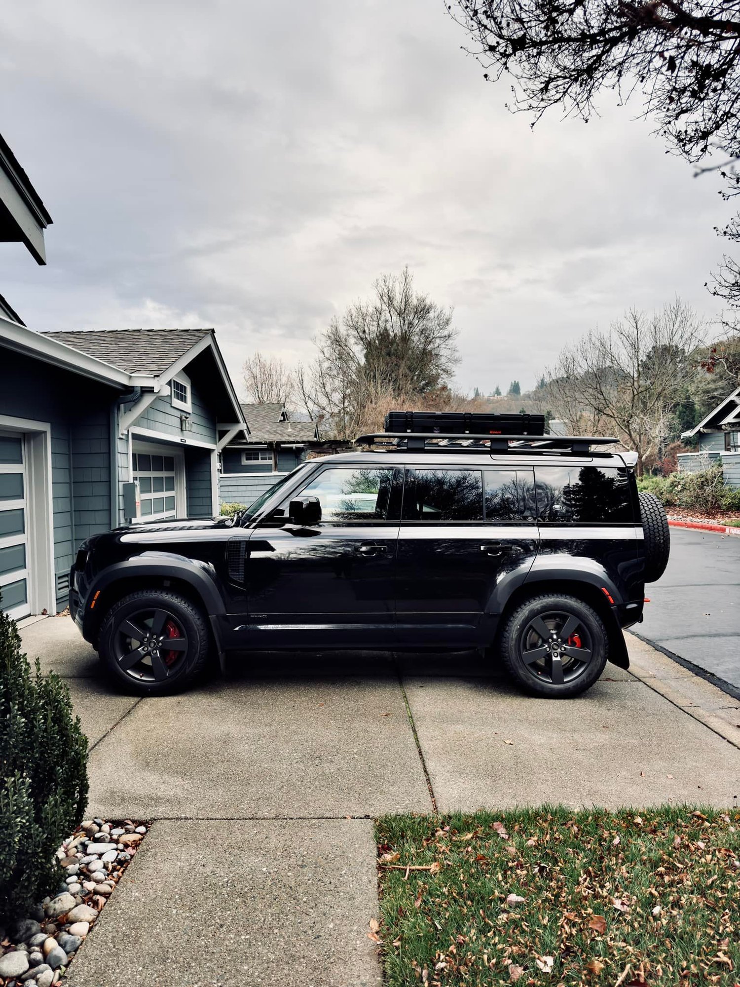

Anyway, here she is with the new wheels, which will have the general every day tires, while the other set will be fitted with KO2s or similar.

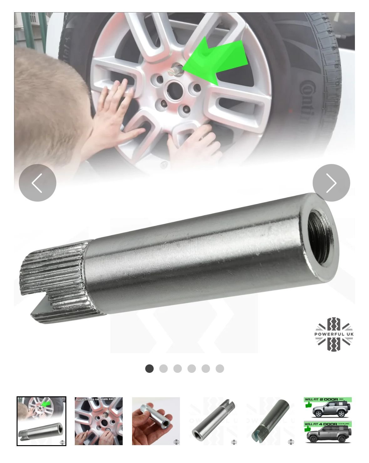

Oops. Should have added this to your shopping list. Especially for mounting the spare if you are alone! I’m sure you can find another elsewhere, but PowerfulUK has certainly earned my biz.
https://www.powerfuluk.com/collectio...-defender-l663
That is awesome! Will be ordering. I've ordered from PowerfulUK before as well and love what they do for the Defender community.

Did your Defender not come with the jig? It should be in the trunk next to the jack. If not, your dealer short-changed you.
I'll have to check when I get the vehicle back from the dealer (getting the 20k service). More than likely I'm an idiot and didn't use it
