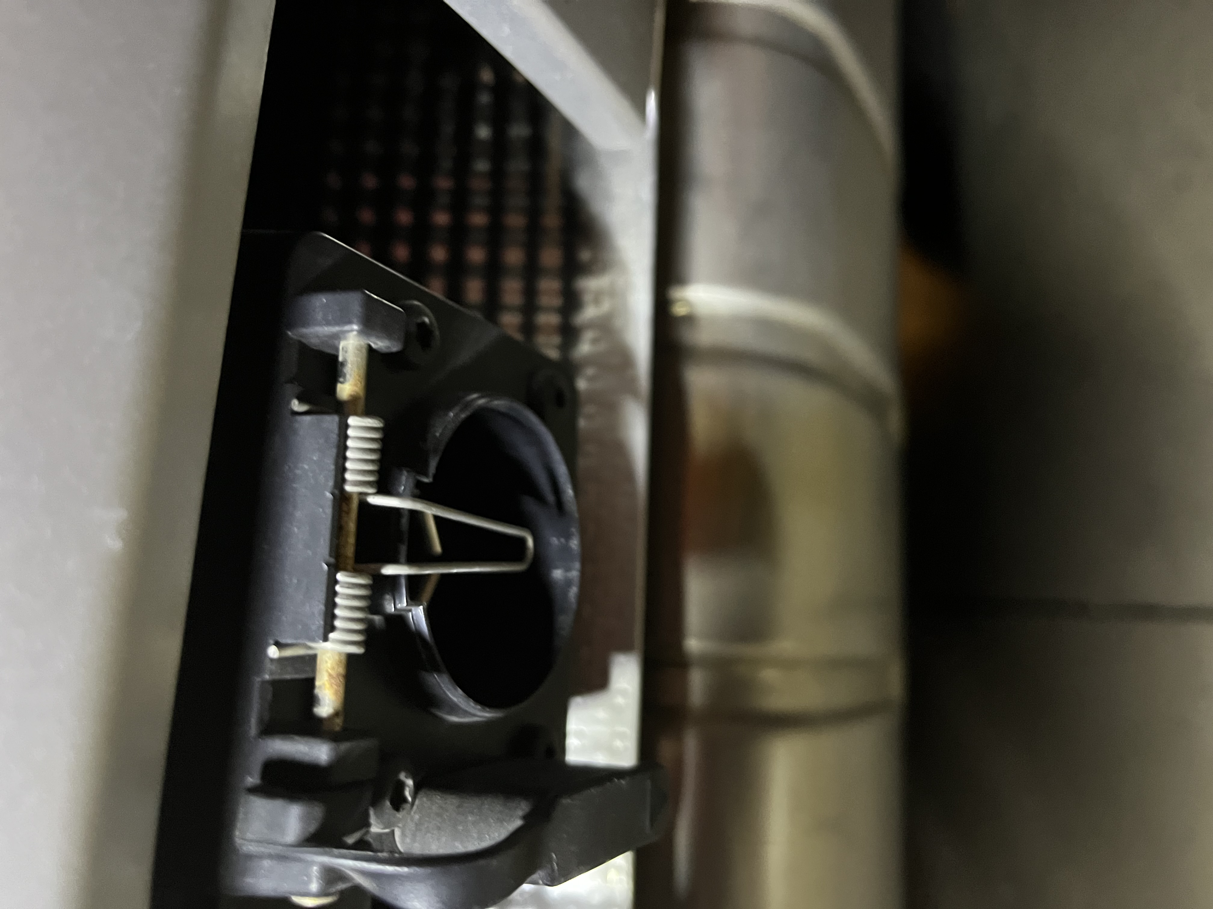

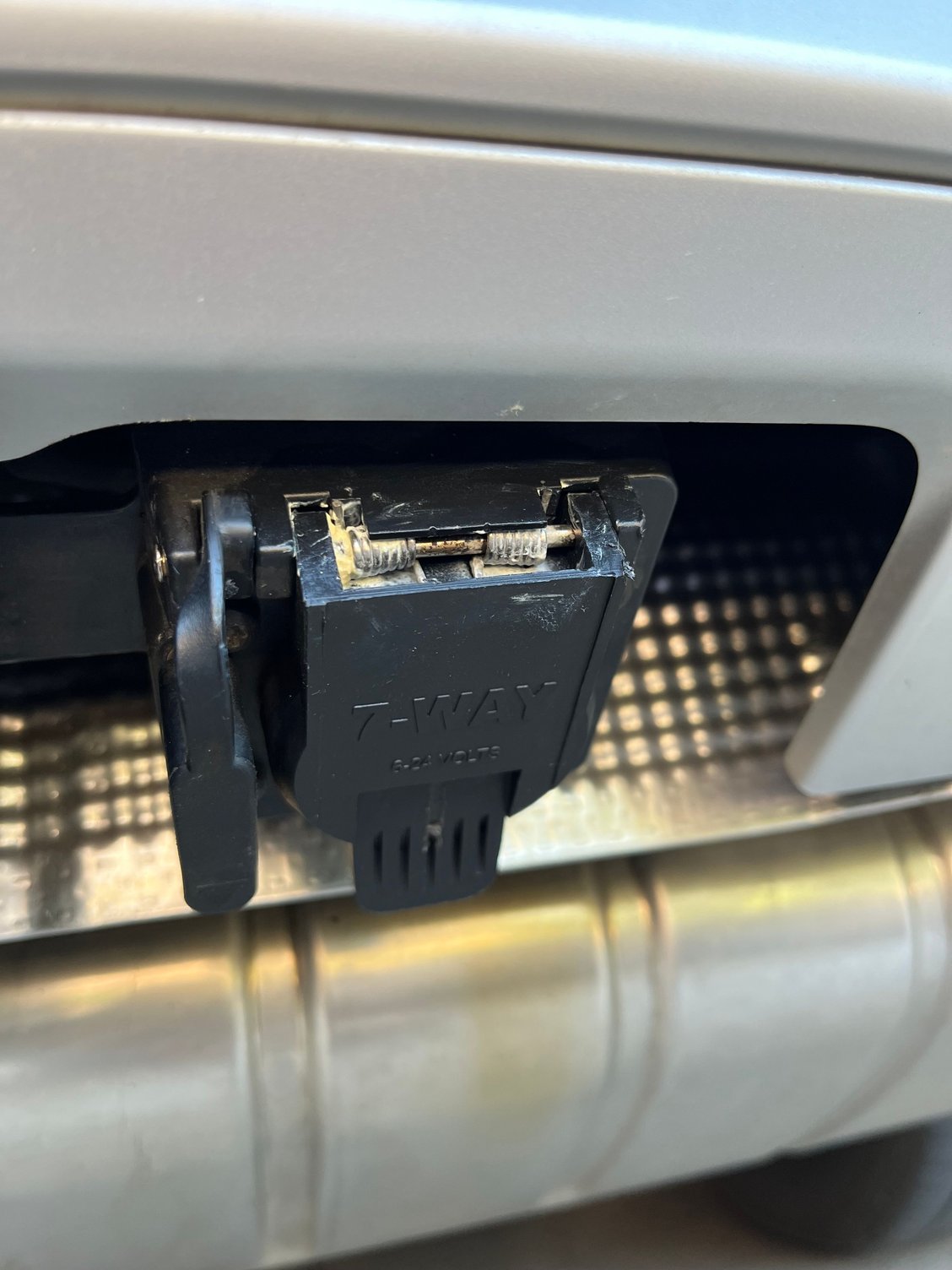

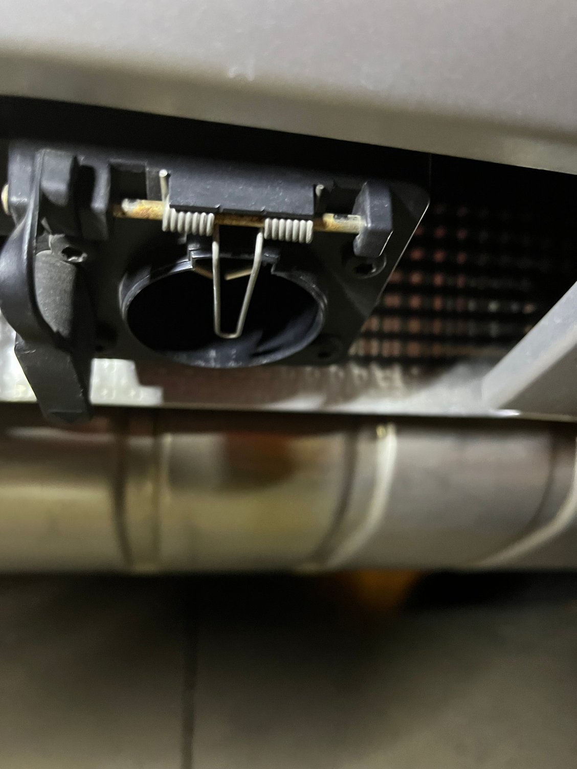

Seems as though the cover or flap on the 7-pin wire harness connector is under-engineered and they break more easily than they should. I found this out when trying to unplug the connector “plug” after towing our wakeboat. Cover snapped right off when I pulled it back a little to unplug the connector (most covers have a retention “spot” on the inside of the cover that helps the plug stay connected (helpful especially since the Defender is angled down). Anyway, I researched a bit here and learned you could indeed replace the cover with an aftermarket one (I bought one from Curt, on Amazon; $10), by removing the hinge pin, running it through the new cover’s hinge points and you are good to go. My caveats are that our spring is just a bit too long for the Curt one I used, which puts a little extra tension on the pin, making it a little difficult to get the pin to pass through the second/right side hole. I tried to remove some material with a drill bit, in the bottom of the area in the cover where the spring bottoms out, and needed to lube the pin with some lithium grease (a little carried away :-) ), but, with patience/perseverance, got it through, and the cover works great. Here are some pics (tried to post a short video of how well the cover snaps back, but I don’t think it loaded):
