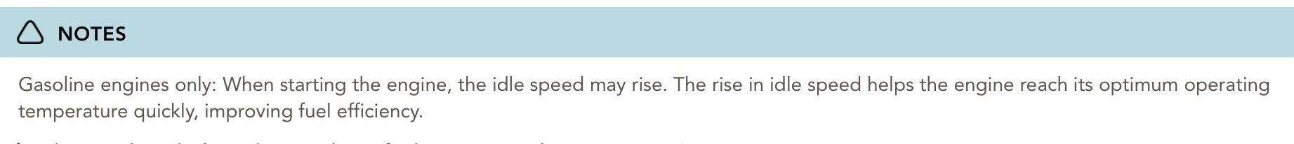

Yep they all do that for all the reasons mentioned. There is a section in the manual specifically about this. With all that said I am with you on waiting to shift. I always make sure it finishes the cycle and the rpm’s drop before I put mine in gear.
Old Aug 15, 2023 | 09:06 PM
RogueRover's Avatar
Joined: Apr 2023
Posts: 140
Likes: 120
well, sure enough……
