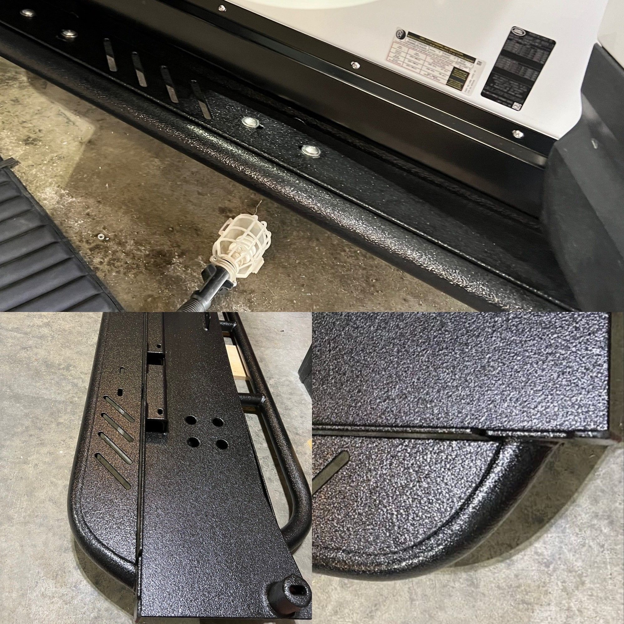

I was also concerned of the dis-similar metals corroding living in Upstate NY (salt/brine used a lot on our roads)
I had my sliders stripped of paint then Line-X'ed (basically a rubber coating) them, used aluminum riv-nuts, painted the holes I had to drill for the riv-nuts, and put aluminum anti-seize on all surfaces that contact the body (the contact surfaces on the sliders were also coated in Line-X) and hardware. I looked like the Tin Man when I was done, hahahaha...Hopefully that should help with the dis-similar metals.

The Line-X coating is thick and rubbery coating, it acted like a seal, when I torqued everything down. They will eventually need a re-coat after some trail abuse.
The riv-nuts I used were marine grade, as of strength rating they are only used to fasten the sill plates and are not load bearing, I don't see them ripping out.
The slider hardware was SS grade 8 bolts I sourced from a USA manufacturer.
I tried my best to paint, seal, protect against corrosion...time will tell.
