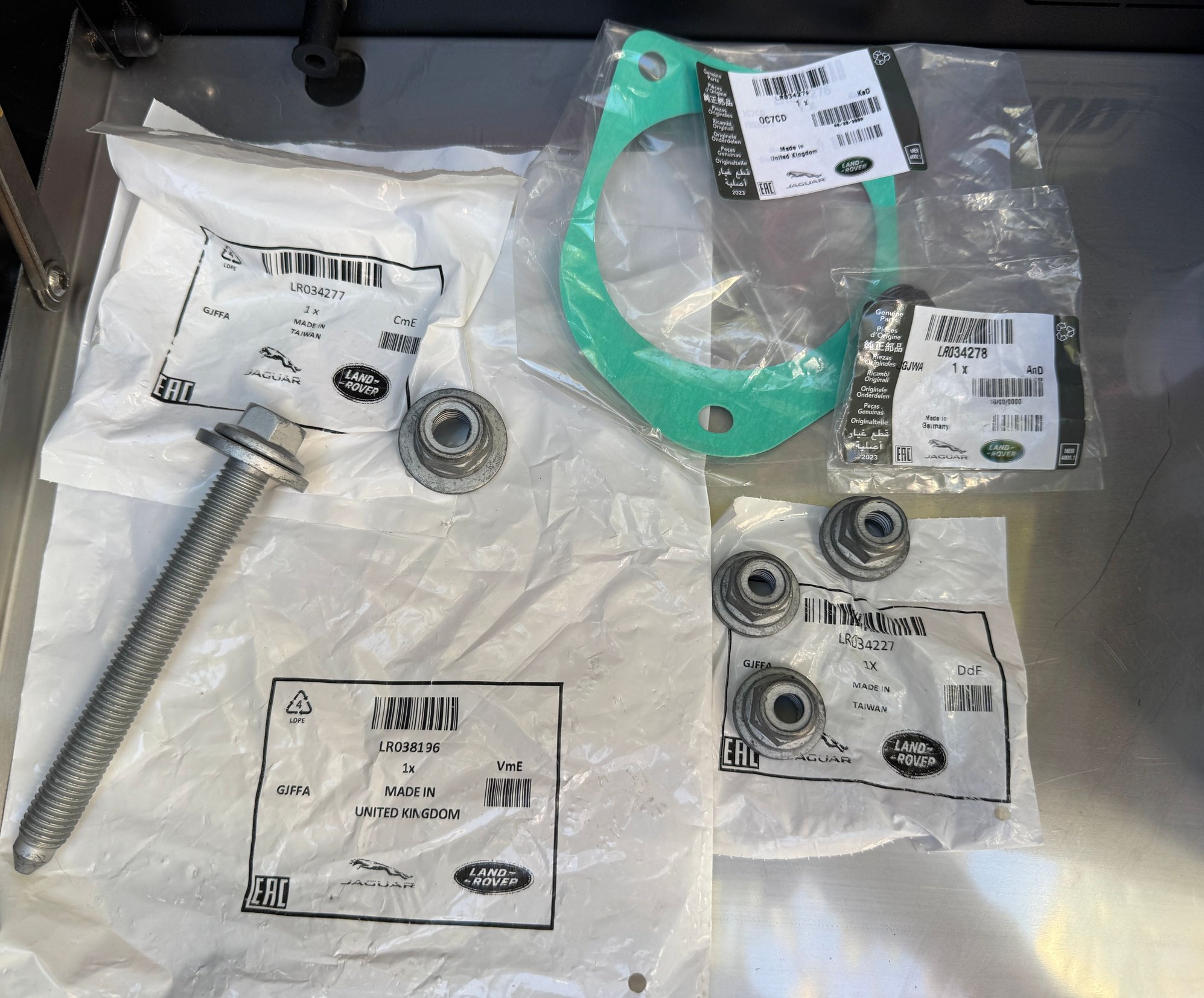

Another story: I had to change the left rear adaptive shock on my Defender. The way the shock mounts, there is a green synthetic material that looks not unlike a paper gasket, between the shock upper mount and the aluminum frame of the car at that point. That is to prevent exactly the issue I was talking about in this thread over time that has happened between steel subframes and aluminum RR bodies (similar situation, movement, coating failure, muck / wetness, corrosion). Here’s a pic of that gasket btw. It’s green in the bag. This potential for corrosion is ** Exactly ** why JLR puts this there. I never investigated it but I bet this material is available to buy by the sheet and one could cut it to fit slider mounting areas. Note: You can’t just shove a rubber bit in there or something else... the isolator material can’t retain water, that will make the problem worse.
