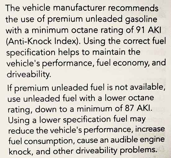

Here is the recommendation and explanation from our Defender Bible (the manual). Premium (min. of 91 octane).
"Using a lower specification fuel may reduce the vehicle's performance, increase fuel consumption, cause an audible engine knock, and other driveability problems.
