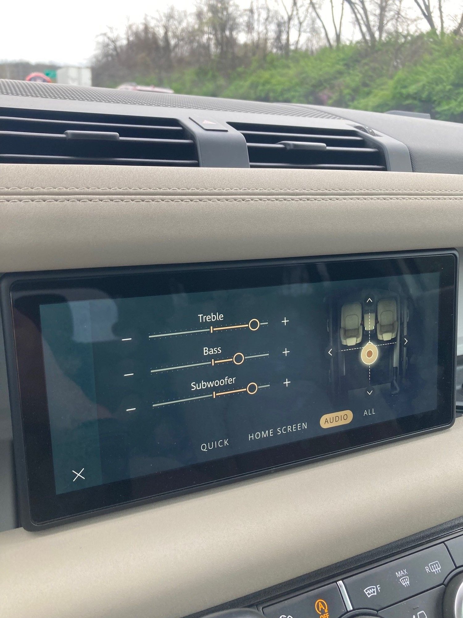

I did sound engineering for 11 years up until 2014 and mainly live events where acoustics can be challenging from gig to gig. I've come to the conclusion of just adjusting the balance to rearwards to give it something close to a sound stage. And the lack of advance adjustments in equalization is so early 2000's is just as disappointing. That's my two cents.

Yes, moving the balance a few ticks rearward does help quite a bit. A full 5 or 7 band equalizer would be ideal, but just a dedicated midrange setting would fix all of my issues with the 400w Meridian. I can live without a center speaker, after all, almost all music is recorded in stereo, but the lack of midrange in the Defender's base Meridian system is my biggest problem with it. Other than that, I think it is pretty decent, but the 825w Meridian Surround in my old D5 is still one of the best in-car audio systems I've ever heard. Only the 35-speaker Meridian Signature in the new RR, the Bowers & Wilkins in Volvos, the Burmester 3D system in the Porsche Panamera and the Naim system in the Bentley Flying Spur are better than my old D5 IMO.
