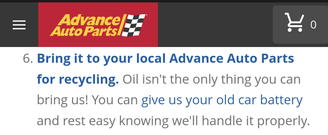

@GavinC Thanks for sharing this. For me this confirms the need to change the oil more frequently than LR recommends. Since the POS LR dealership can't ever seem to remember to perform an oil service I'll be ordering the items to do it myself. 1 qq: what do you do with the used oil?
Thanks

Most oil change places will take it or
