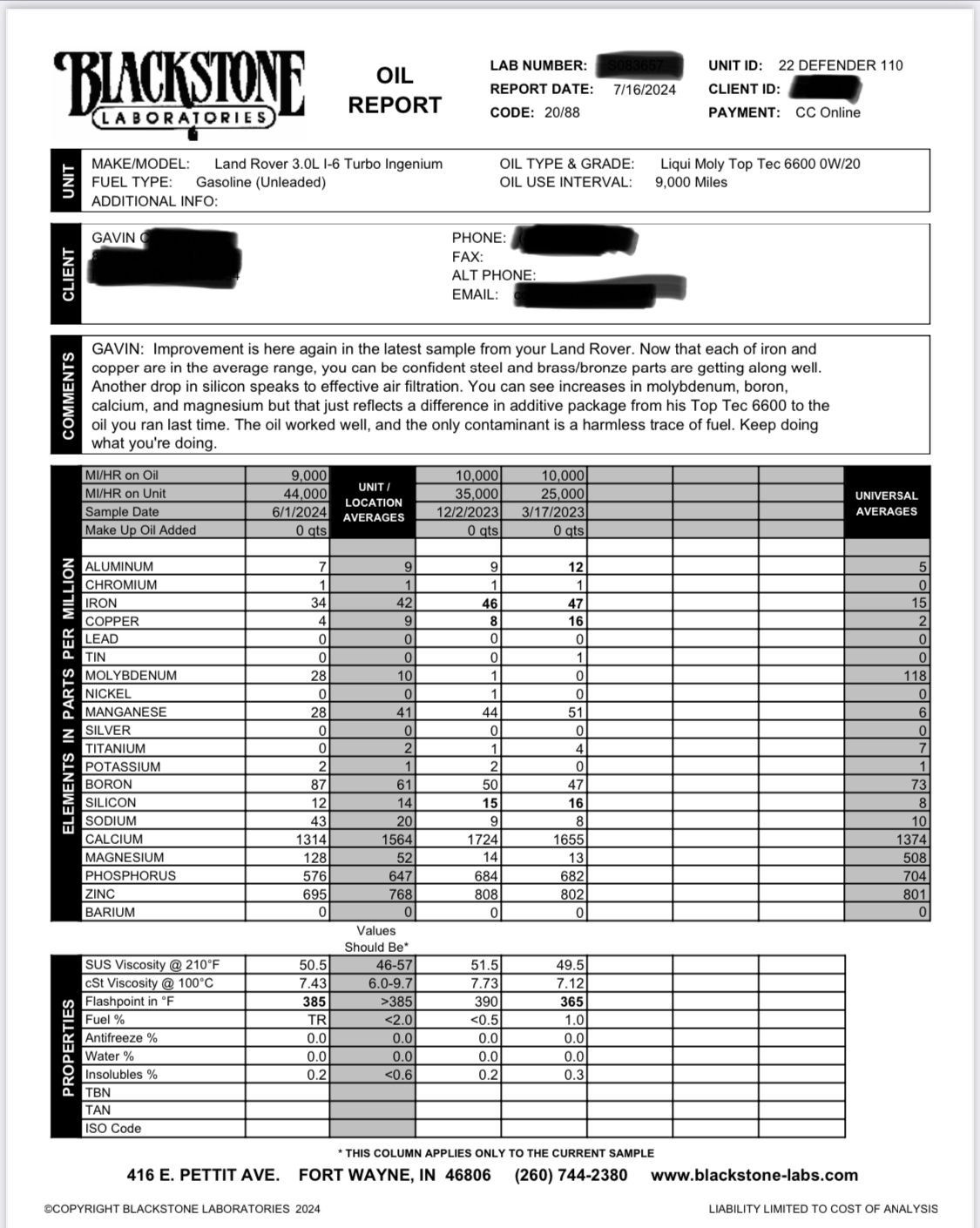

Latest oil sample. Changed it about 1000 miles ago.
Blackstone Labs Oil Report
  • P400
  • 44,000miles on the odometer.
  • This was the fourth oil change. 15,000 miles, 25,000 miles, 35,000 miles 44,000 miles
  • The oil sample is 9,000 miles old.
  • Reduced Iron and less silicon
  • All seems in order
