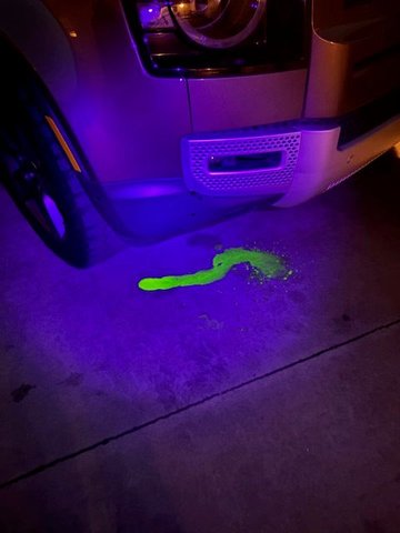

My 110 is leaking coolant and I cant seem to find the source. Its on the passenger side. I checked the aux radiators behind the bumper. I didn't see anything.
I added dye to help find the leak. I can't see anything from the top. I am going to remove the under shield and see If I can locate the problem.
Ill post my findings.
This is the second time It leaks in a month. Its odd because I check it daily. Nothing and then a quick 5 min trip to the store and this is what I find. (see pic)
If anyone has had this issue please share, I might have the same thing going on. Thanks.

Possibly the auxiliary radiator. It is a known leak source.

Mine was fixed for that exact problem under the warranty. First they replaced the reservoir, and when that didn’t work they replaced the aux radiator near the wheels. Problem solved. Took some pushing back, so if you hear “you know these vehicles do use up the antifreeze” keep pushing.

Also, have the dealer check the water pump. There have been several issues with the water pump, and the leak from the pump is tiny and difficult to see. After several visits to the dealer where they could not locate the leak, they found it at the water pump.

Found the cause of the leak. Its the O-rings from the turbo coolant lines. LR part # 104123612
Being Friday afternoon I wont get the O-rings until Tuesday. I paid a total of $34.82 for two seals. From my local dealer.
I think the reason it spilled the way that it did is because the under shield and the slight slope in my driveway.
Others on this forum have had the same issue, pointed me in the right direction. Thanks.
Next I will check the water pump as you recommended. Just to put this coolant issue to rest.
