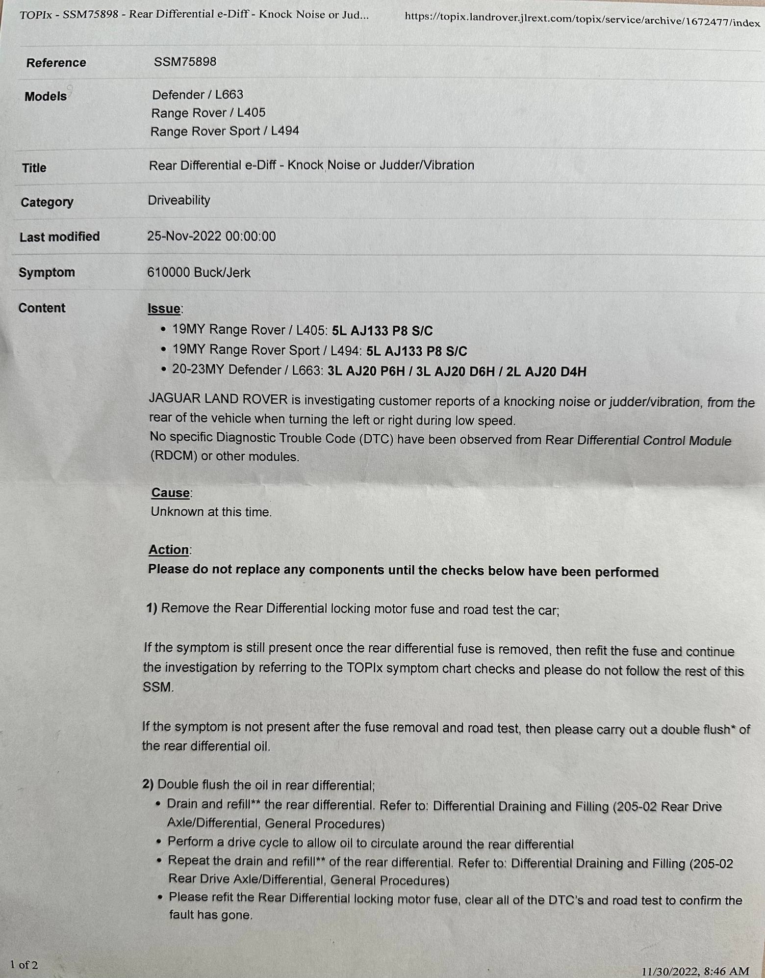

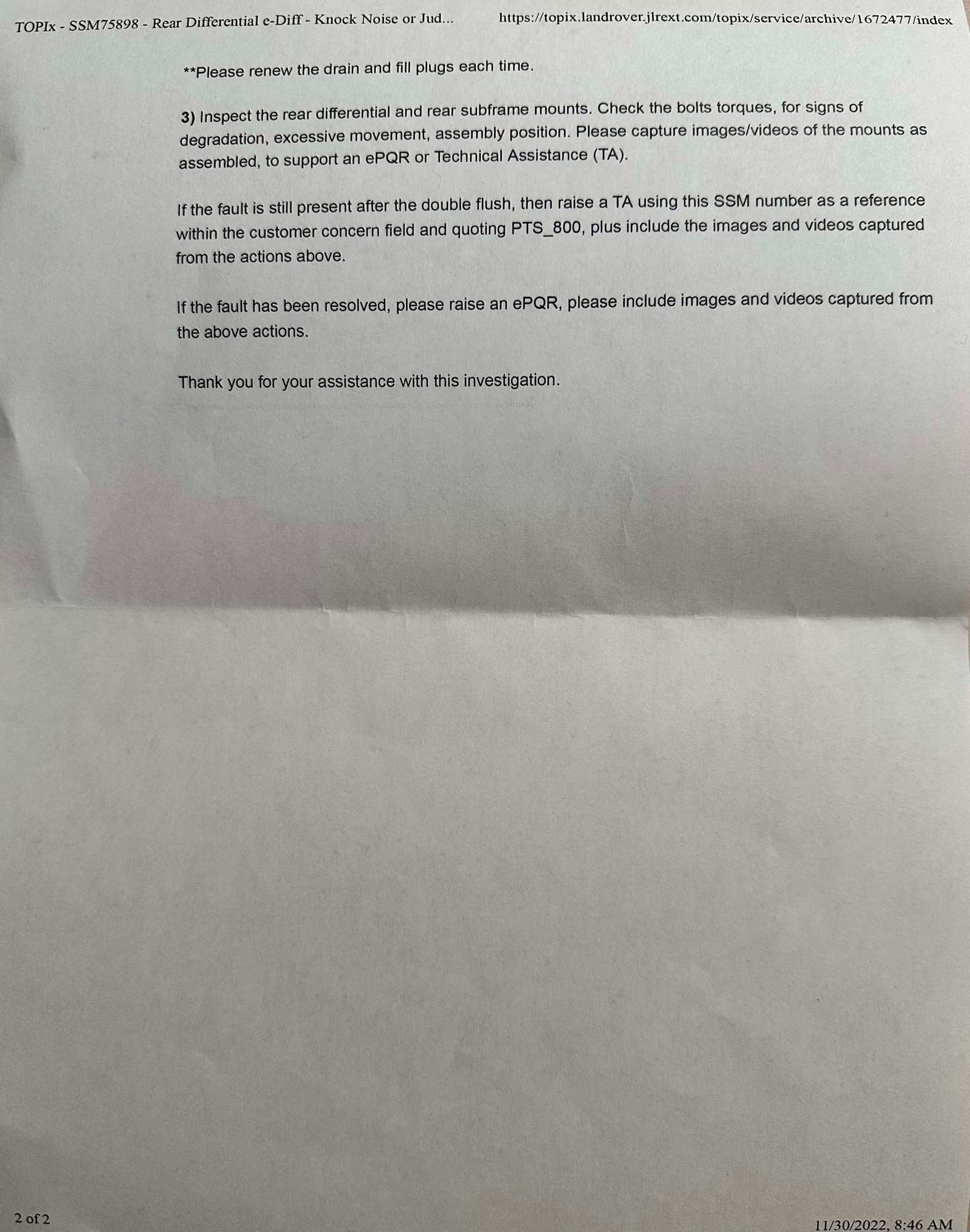

Update: Turns out it was in-fact a Diff issue, but an odd one. The service shop found a service bulletin related to the issue I've been having, reason for issue is UNKNOWN. Land Rover guidance was to remove the fuse and double flush the oil in the rear diff. Issue seems to be resolved! If it comes back will have to do a warranty claim for a new one but I think it must be a software related gremlin and not a mechanical issue. Service Bulletin for reference below. Hope this helps and if you go to get your diff fluids changed please make sure to flag this to your service tech, might save you a headache.

Ugghh !! I am at 40K miles on my 2020 110 P300 and am presently waiting for the dealer I am using to obtain a transmission filter, so they may change the transmission fluid, rear ediff fluid and transfer case fluid on the same day (I hope they do not mix them up !!).
So, I read the TOPIX to imply that the problem they are addressing is that when the rear differential attempts to engage there has been some chunky gunk released within the differential during the static change which should NOT be there and thus they want to flush out all the fluid TWICE more, in the hopes it will resolve the problem.
This is the least expensive fix, which is what is done when certainty of something worse occurring is not present.
I have printed out the TOPIX and will definitely be aware -- thanks!
