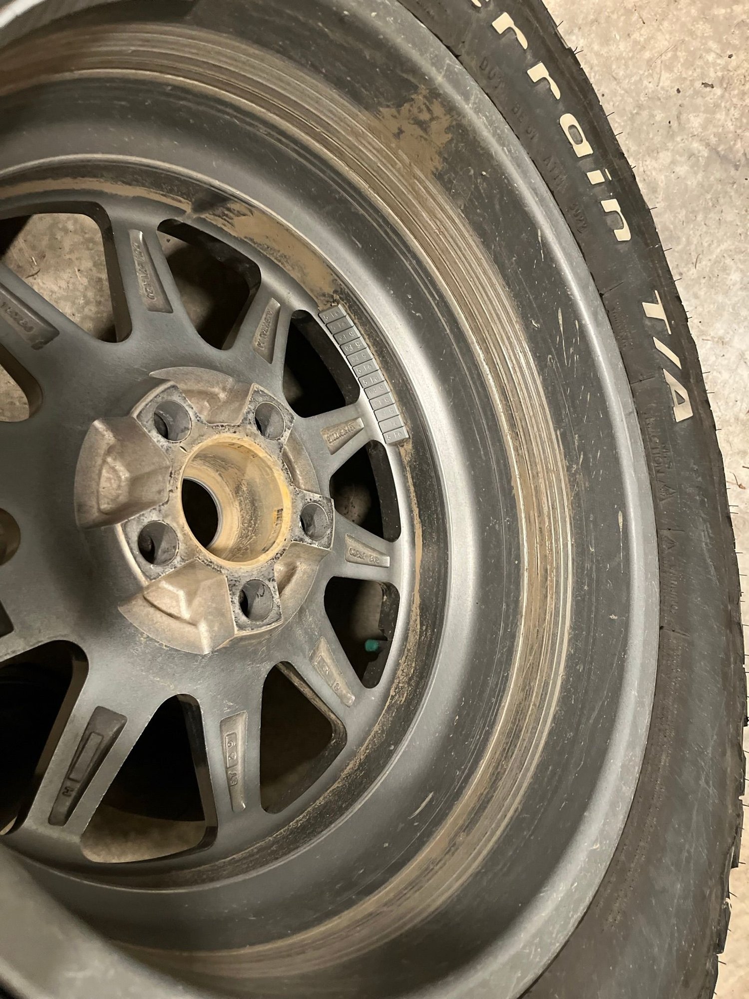

Some internal grooves on an 18” with +29 offset as an example. All 5 look the same. 30000 miles on them. It’s sort of self limiting. But the calipers will be chewed up with steelies and these tiny clearances.  Something’s gotta give.
