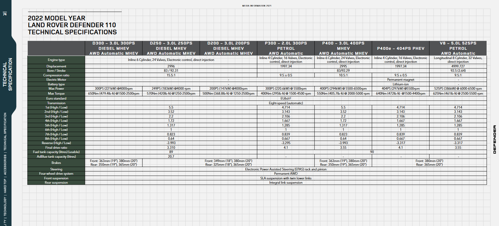

The P300 and ROW D200/D250 comes with the 13.7" front and 12.8" rear rotors on 18" and 19" wheels. 20" and 22" wheels come with the 14.9" front and 14.4" rear rotors. The P400 and ROW D300/D350 comes with 14.2" front and 13.8" rear rotors for the 19" wheels (smallest you can spec), while the 20" and 22" wheels come with the 14.9" front and 14.4" rear brakes respectively.
This is false. Read this thread: https://landroverforums.com/forum/20...39/#post912816

Originally Posted by A1C6
Per the press kit:

Per the press kit:
