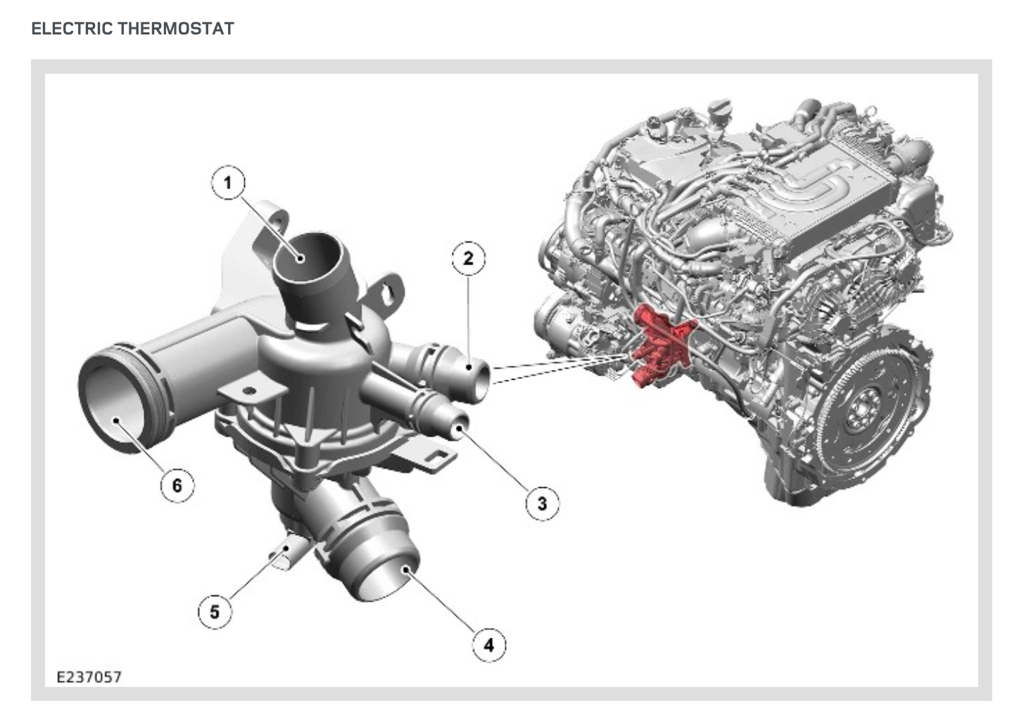

Each step in the attached pdf is likely a rabbit hole of removal of other stuff. The shop manual is a great resource.
Looks doable and worth doing to save the $3500 in labor but to each their own.
Brute force, basic tools, patience and a few beers are in order.
Each clip and electrical connector is a little puzzle unto itself on these engines. If the Defender was an animal, the comparable location of the thermostat would be 8" up the ileum.

As @Defendit.. points out - if you want to tackle this, grab the workshop manual. There's a copy floating around the forum. I have the P400 version, you'll need the P300 version. @GavinC gave a great service by targeting section 303-03C "Electric Thermostat" Removal & Installation. As he states, this is doable. One thing to note is that these often turn into a spaghetti game of referenced sections. 303-03C will lead you to 412-01 which details removing the AC Compressor and it in turn leads you to 412-00 which is AC System evacuation and recovery. You may be good (or lucky, either works) and able to work around disconnecting the AC system. Then you won't have to recover or replace the AC.
At that point, I gave up on tracking down the subtasks and decided to eagerly await the results of your journey. Me: my 3 day estimate of me doing it myself went out the window with "General equipment: Air conditioning system refrigerant recovery / recharging stations". Some might just vent it out, but for me that's a nope. Not judging anyone's techniques, I'm just outlining my skills boundary. I agree with GavinC - this one is going to go deep into a dark body cavity. Some folks enjoy spelunking!
