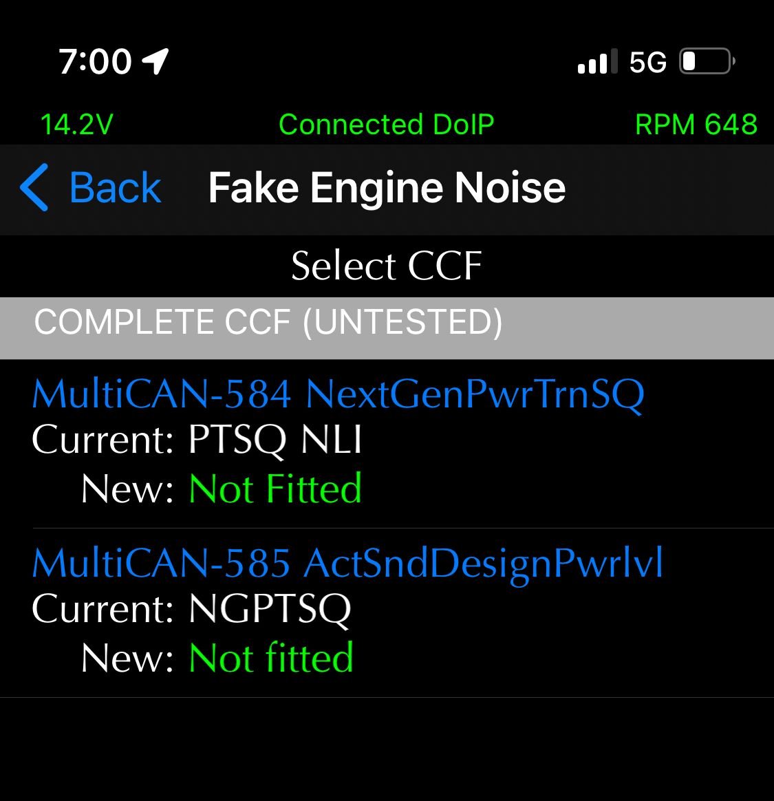

Are these the correct parameters to select for the two CCFs listed?
Just to clarify from others, the faults that occurred, if any, were they clearable or did you have to revert to prior settings to clear?
Old Feb 28, 2025 | 09:21 PM
jwilliexd's Avatar
Joined: Jun 2023
Posts: 30
Likes: 10
Yup! “Not fitted” for both.
