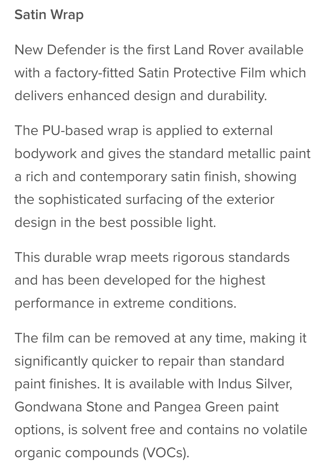

Are you sure it's XPEL though? Afaik, LR hasn't ever specified a brand.
Would make it easier to address this issue if they did. Hell, I've buffed XPEL and it's fine if you're really careful but who knows what this really is. All ppf is not the same.
LR is intentionally vague but that's a whole other conversation. "No voc's and "solvent free" are not terms XPEL uses in their marketing. Also, if it was XPEL, you would think they would at least mention self-healing.
From LR:
From LR:
XPEL has at least said they are the product on the Range Rover Westminster. I can't imagine Land Rover using something different on other vehicles in the lineup. Is this airtight evidence? No, I admit it's not.
https://www.xpel.com/blog/range-rover-stealth-xpel
Hard to be sure I suppose. There was a video that showed a clip of the Defender wrap process a couple years back and they were vague about it being in-house or farmed out to a sub.
Idk if being in the Nitra factory has anything to do with possibly using dif't material than the RRS but there was a shortage of ppf material for a bit. I almost wonder if they're vague about it so that they can switch between available product or if they just don't want you cross shopping to see if you can just have it wrapped with the same material for a better price.
One thing for probably, they're vague for a reason. We just don't know what that reason is.
It kind of sucks because not knowing what it is diminishes the value of the wrap.
