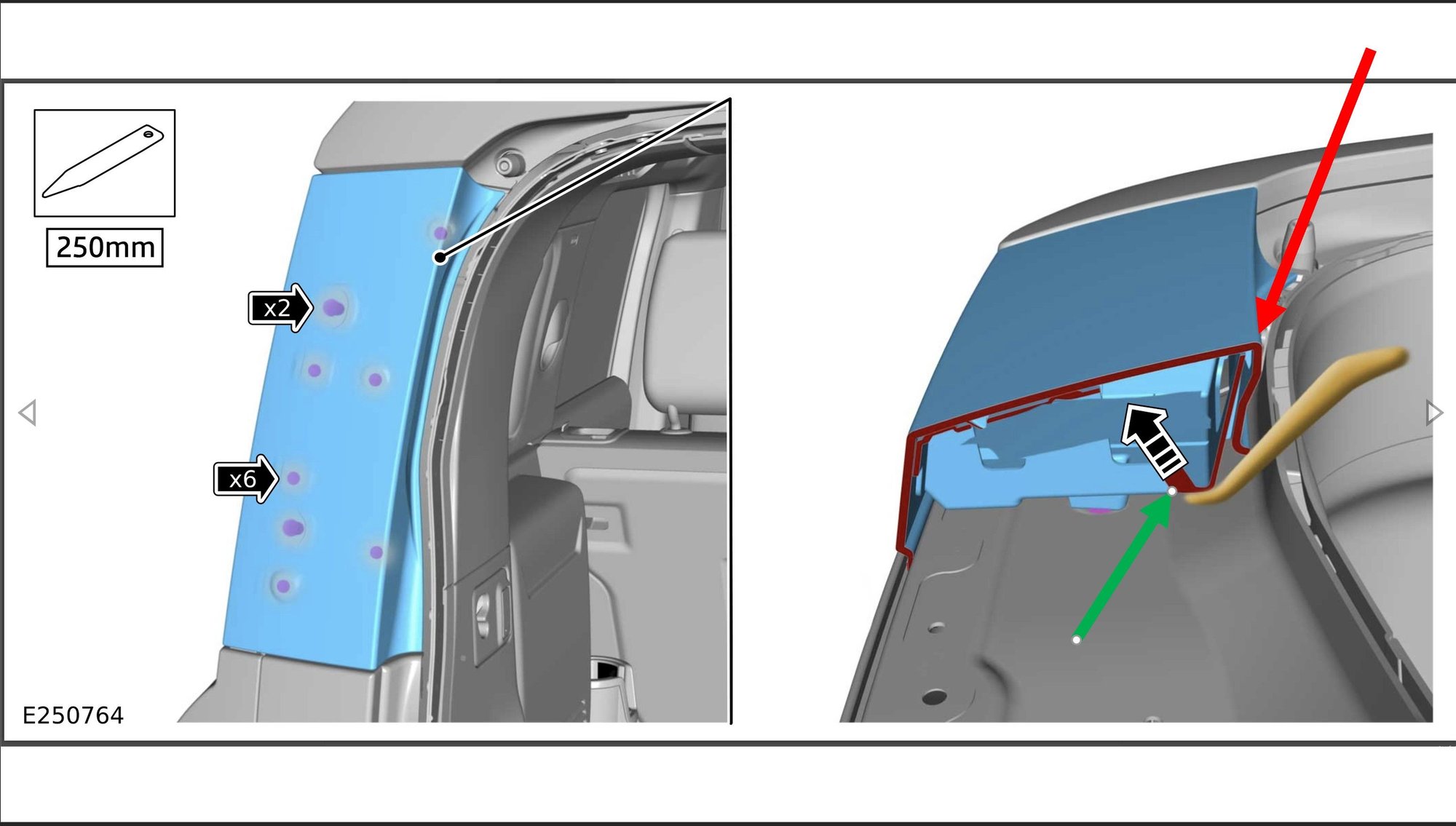

GrouseK9, any advice on getting the trim piece off without breaking it the way the PowerfulUK guys did?

@Simon14 - The Upper D-pillar trim is made of two pieces of plastic that are VERY poorly heat welded together. If you try to pry from the outer layer (Red Arrow), you will easily separate them. You will curse and then either JB weld it or order another. The preferred way is to pry the INNER layer out (Green Arrow). The gold thing is supposed to represent the trim tool and where to place it. It is hard to tell when you are outside the vehicle, but you need to dig deep and pry more 'inside' the trim than usual or than you think. Good luck!
EDIT: Those purple dots are the really tough rubber grommet/connection points. Start with levering at the high/right and then the low/right points to start.
