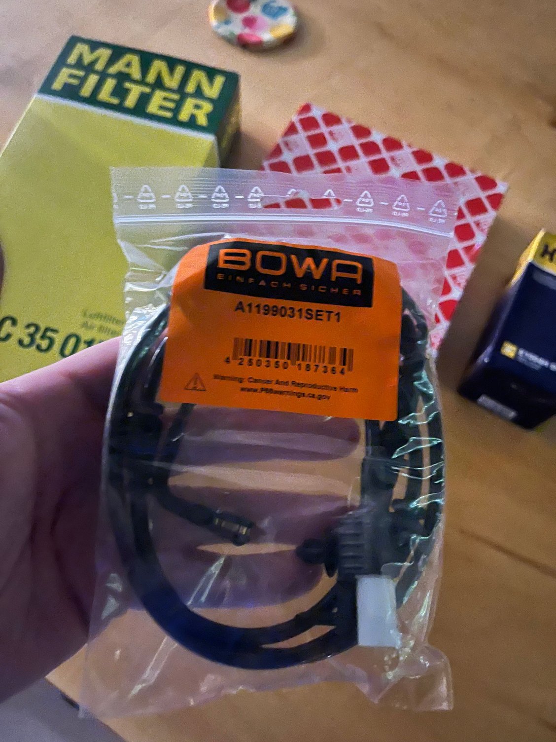

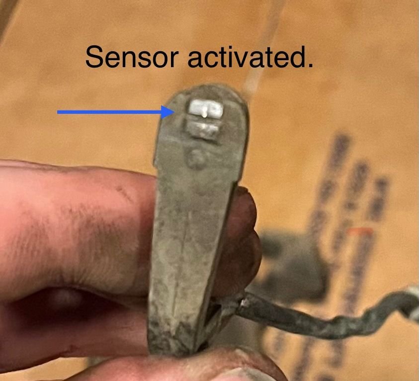

  • Wear sensor if you’ve triggered the old one.
  • 2x caliper bolts per side
Special Tools needed
  • Break spreader $30 from Autozone
I swapped out the wear sensor as it had been activated.

The wear sensor is tucked in behind the plastic wheel liner.

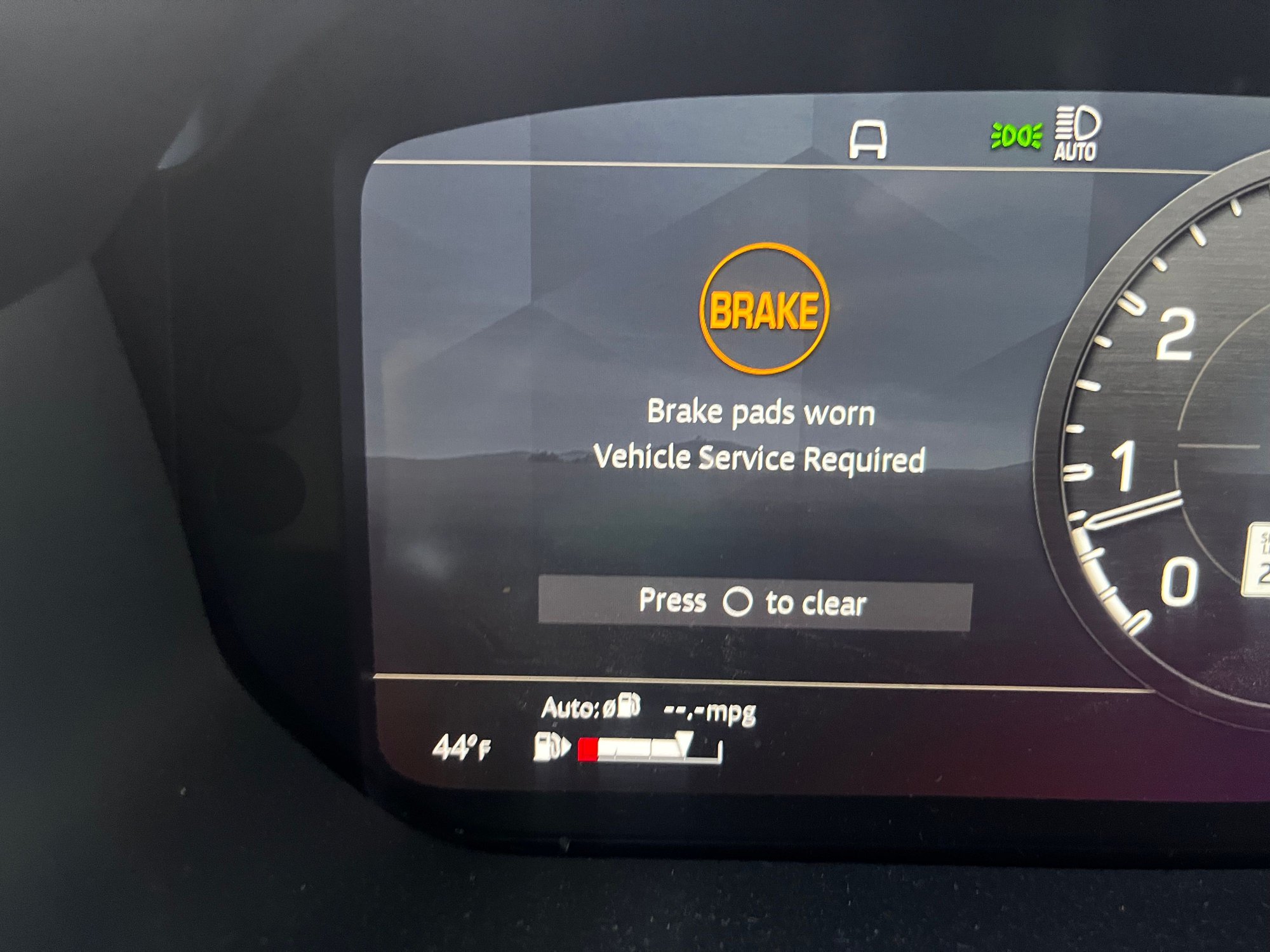

The warning to change pads.

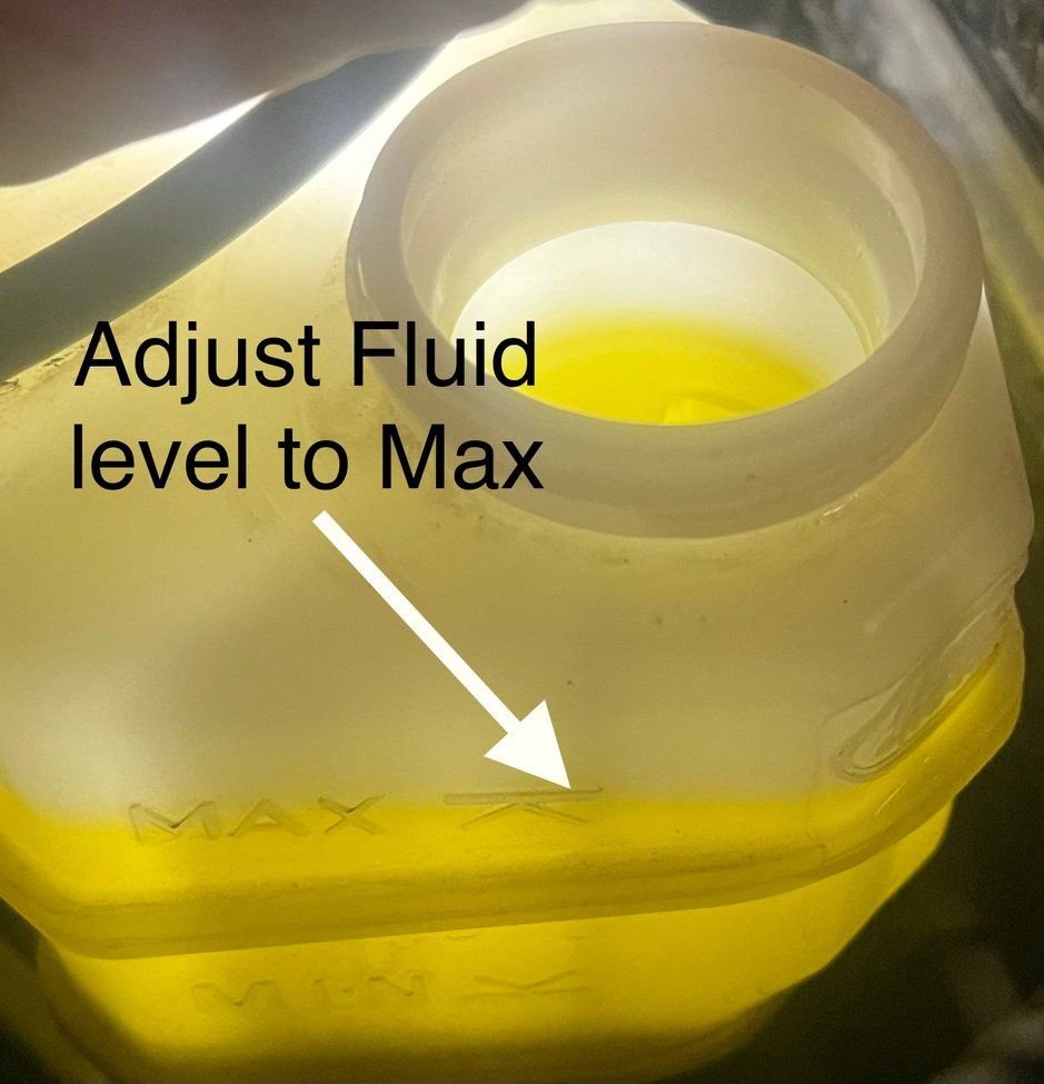

Top off/remove brake fluid in reservoir as needed after exiting service mode.

Did you not encounter a higher level of breakoil in the reservoir after reset of the caliper or did you top off a little before ?

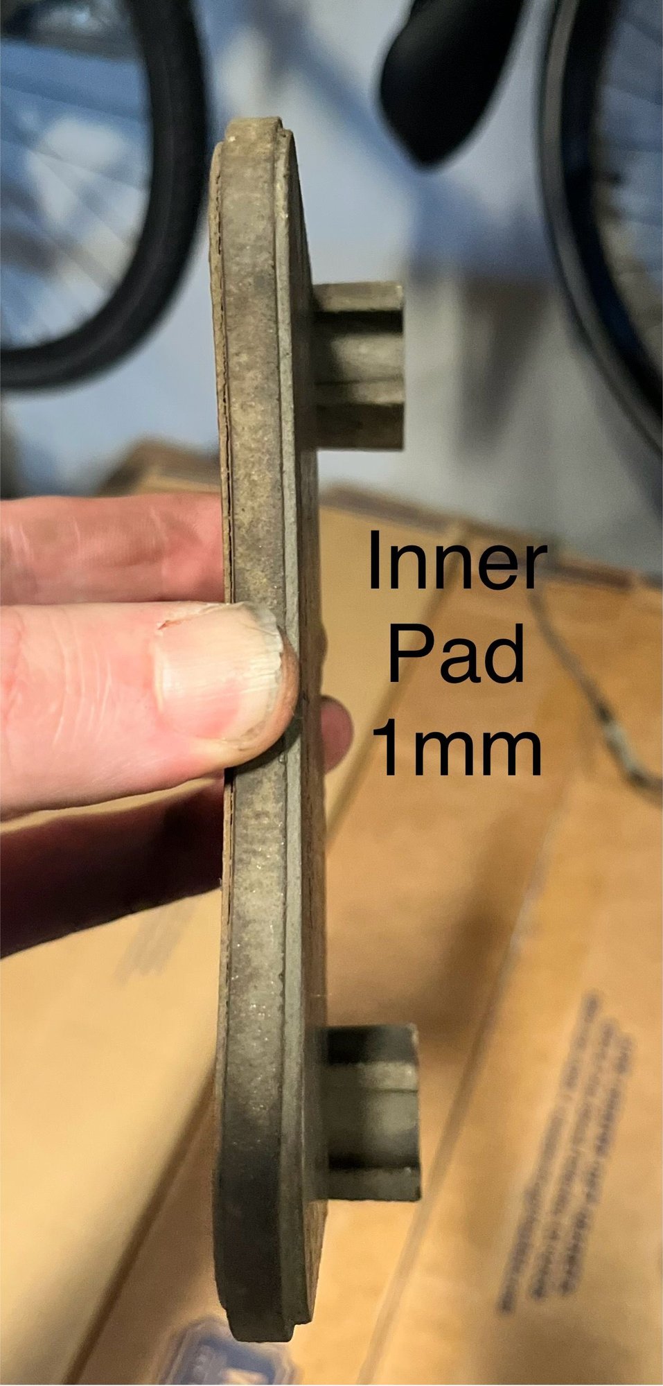

Give those brake pads a hug for surviving 70k plus! How did the rotors look? Most importantly that Nog looks very delicious!

I used a turkey baster to remove brake fluid from the reservoir before retracting pistons. By the end the level was back to full and i just removed a fraction more after doing the final brake calibration a nd exiting service mode.
Other option would be to crack the bleeder screw on each caliper and collect the fluid there. I just wanted to eliminate variables and stuck to the JLR instructions above.
Rotors look mint. No need to even consider replacing them any time soon.
