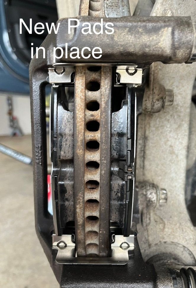

Had the same question as @jwest re the use of GAP tool for fronts. The EPB is only applied to rears, right? Just curious. Have not gotten to do brakes on the Defender but on the D5 entering service mode is only relevant for the rear brakes because of EPB.
Just did my rear pads, without the GAP tool. Not necessary to have the GAP when doing the brakes. The EPB is only on the rears, not the fronts. Service mode is not required when doing the rears, also. There is a process/procedure to deactivate the EPB before starting the rears, allowing the DIY’er to swap out the pads and/or rotors without going into Service Mode or GAP tool.
Yes. Once you disengage the EPB and have the engine off you're good to go.
I found doing the rears a lot simpler. No monster bolts with the two step torque to deal with.
Also, repositioning the guide pins in the floating caliper while manhandling the caliper and keeping strain off the brake line took a little patience and a modicum of sailor-talk. .

To my very untrained eye, the rotors on all 4 corners look perfect. Fat and true. I swapped rear pads 15,000 miles ago (58k) and now the fronts. I can't see any need for new rotors for a long time.

I was looking for any sign of a lip on the rotors but the seem completely flush with the edges. Boiler plate LR advice is pads and rotors at the same time but I think this is more from the standpoint of doing it just right so they don't have any do-overs related to warped rotors and the like.
I found it interesting (I'm something of a nerd) that the inner front pad was markedly more worn than the outer. This was the same on right and left so it's clearly a normal thing. The wear sensor is positioned on that pad too. I wonder why the wear pattern is thus. Something related to centripetal force and lateral load under turning is my guess.
Edit: A dumb guess. Possibly just more force on the piston on the inner aspect.
