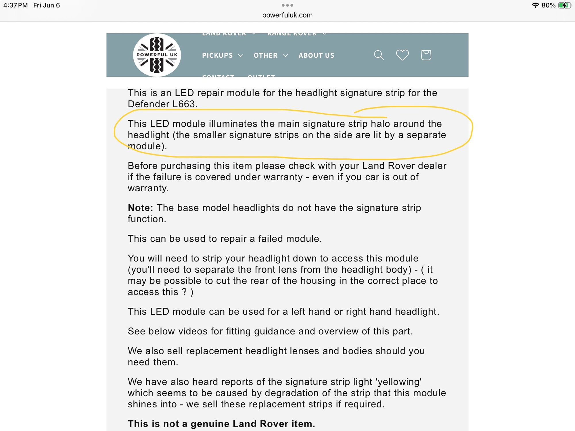

One thing I was unsure about researching the Powerful UK module replacement. It seems as though that only deals with the non-working Halo light and not the DRL...or am I mistaken?

One thing I was unsure about researching the Powerful UK module replacement. It seems as though that only overs the non-working Halo light and not the DRL...or am I mistaken?
The halo lights and the DRLs (daytime running lights) are the same thing.

I thought so, but this is the reason for my confusion.

My right side Halo light was out and the DRL lights were also out. I contacted Powerful UK about their repair module they sell for the Halo light. They confirmed it does not address the DRL not working, but they hope to investigate and come up with a similar solution in the future.

DRL is halo.
the two square lights will turn on when you first turn on the lights but then will go out. You won’t need to do anything to the square lights. Once the halo DRL module is back working the two square lights will remain on.
easy to check this.
turn on your lights. Your squares will be on for a few seconds.
Again. DRL = halo plus square. But only the halo fails. When folks talk about failed DRL they mean the halo.
I have no idea why the squares go on and then off with a failed halo but this is exactly what happens.
repair of halo is less than $10. Mine was $3
