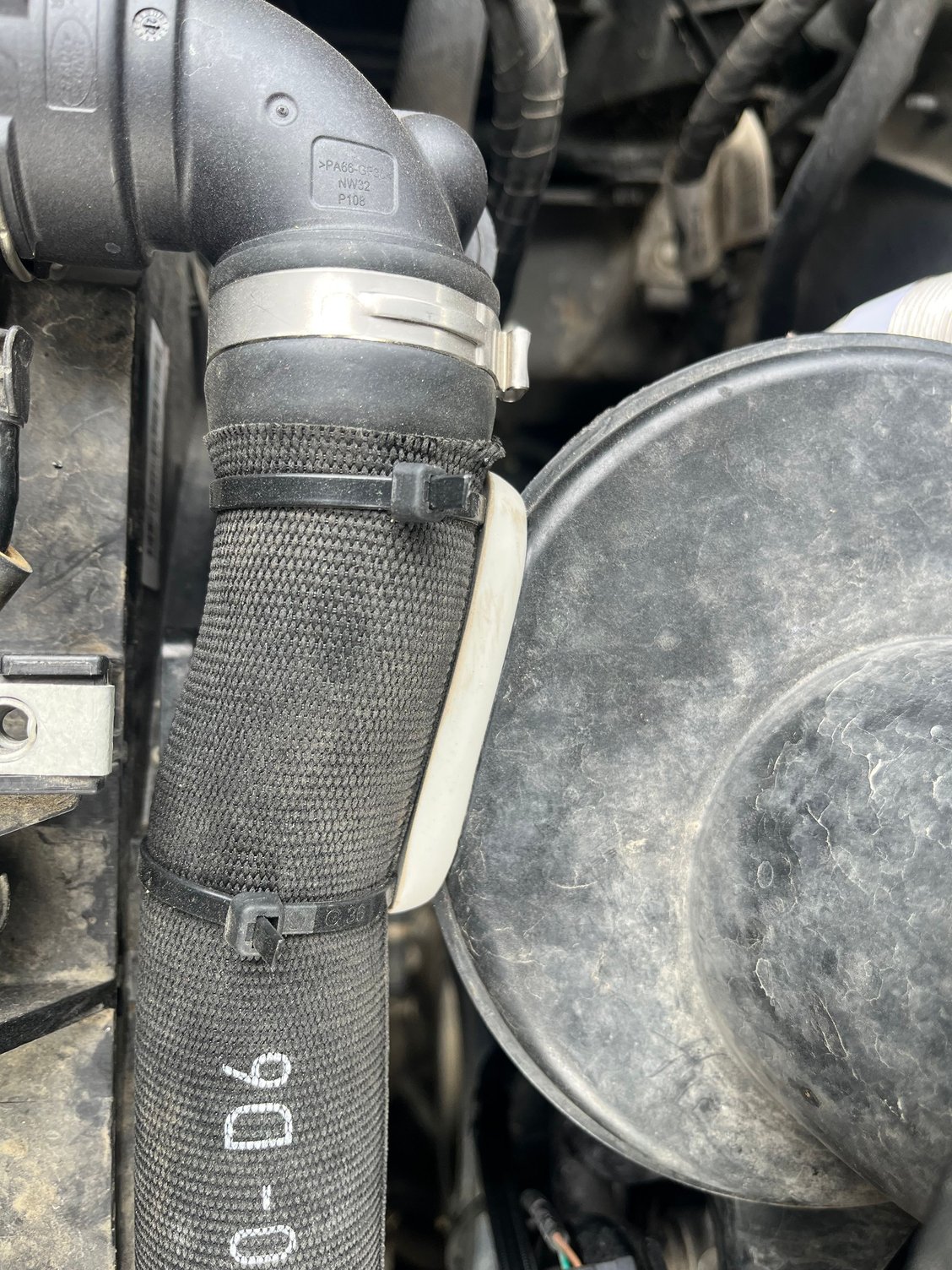

Old Jan 18, 2026 | 05:41 AM
Nick1's Avatar
Joined: Jan 2026
Default 2022 LR Defender - Coolant Hose
This was interesting reading -
My 2022 LR Defender top radiator hose developed a sizeable split in it from rubbing as well.
It took 99500kms or 3.5 years to wear through the pipe allowing coolant to spray out over the engine. This resulted in a low coolant message.
It has been replaced under warranty, however the replacement will wear through too over time.
Not aware of any advisory having been issued either, but believe there should be as, looks like a design error and really should require a recall to check for wear and replace with the upgraded version of the pipe if there is one. Mine was replaced with the same pipe, but the issue of wearing still exists. I have placed a temporary fix by placing a rubber packer in thereto stop it wearing.

Old Jan 18, 2026 | 09:54 AM
H1Tad's Avatar
Joined: Nov 2024
Posts: 374
Likes: 318
From: Cape Elizabeth ME
Any chance you could post a picture of your DIY fix?
Thanks in advance!

Old Jan 18, 2026 | 02:00 PM
WTFChuck's Avatar
Posts: 928
Likes: 866
From: Southern Florida
To reduce wear on a hose, what I’ve done in the past when replacing a hose is to cut off a section of the old hose, slit it lengthwise and wrap it around the new hose and secure with zip ties. And no cost.
