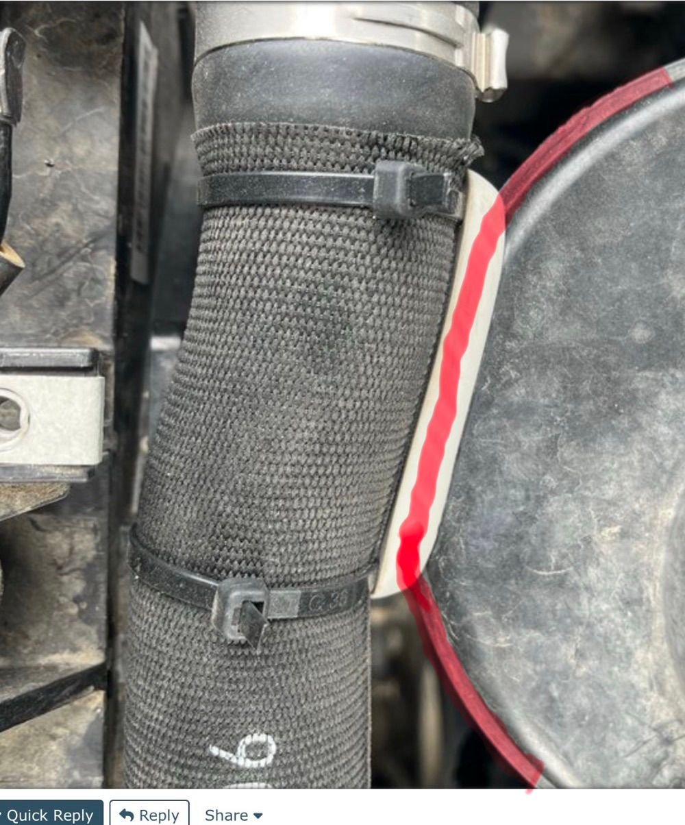

Nice fix, Nick1. Simple, cheap, yet effective. But looking at the pic of your hack, it appears that there is a sharp ridge on that object that looks like a plastic canister of some kind. Easily redesigned by Land Rover if their engineers were prone to customer feedback and complaints, or even analyzing patterns in their service repairs or parts inventory could be an indicator of design flaws. One can only hope.
Exactly. Those two parts are constantly under stress pushing against each other, not to mention possible engine movements during acceleration. That plastic elbow at the top sooner or later will crack under pressure and heat, unlike JLR execs refusing to see and fix this flawed design.
