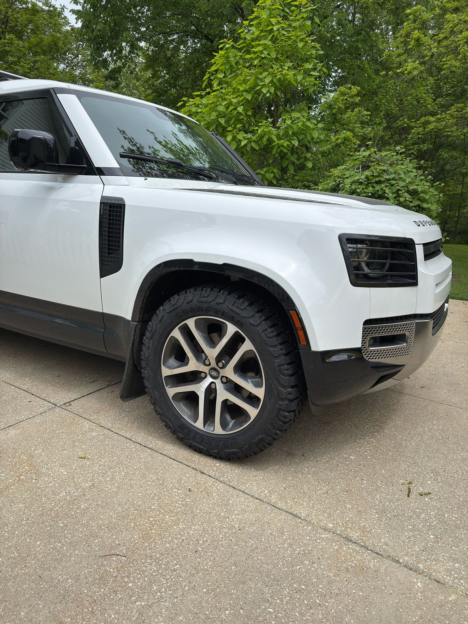

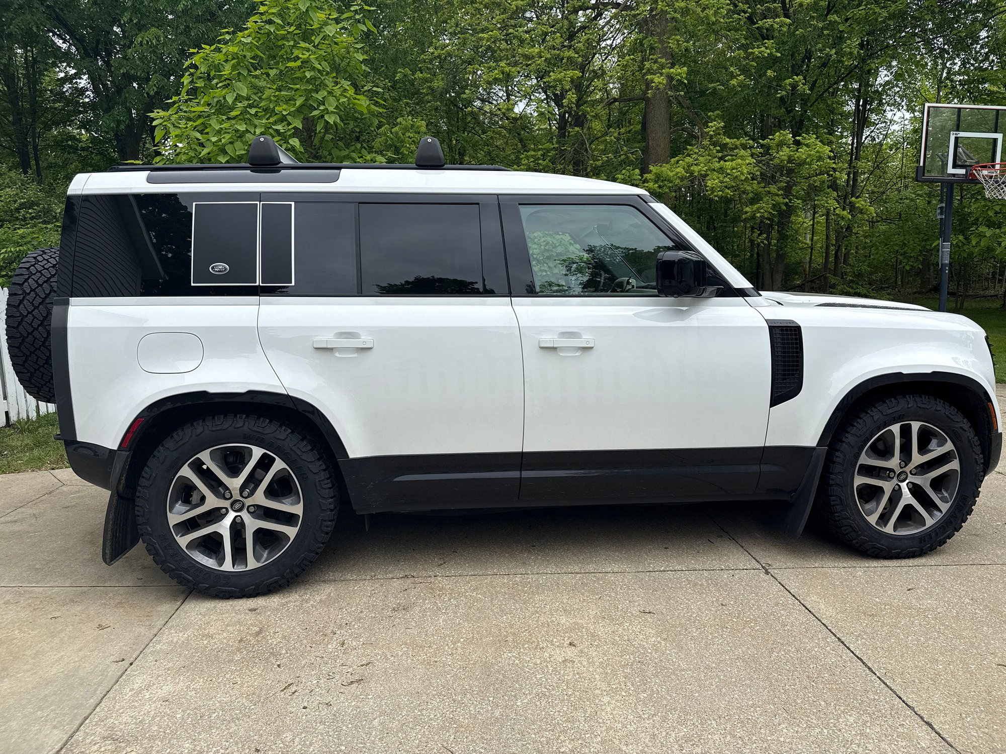

So - Installed Duratrac RTs. and clears on OEM 20's without spacer set.
Raised 275 55 R20 Goodyear Duratracs
Raised Height on- 275 55 R20 Goodyear Duratracs
Access Height Below
Defender 110 L663 - 2023 - Goodyear Duratrac 275 55 20
