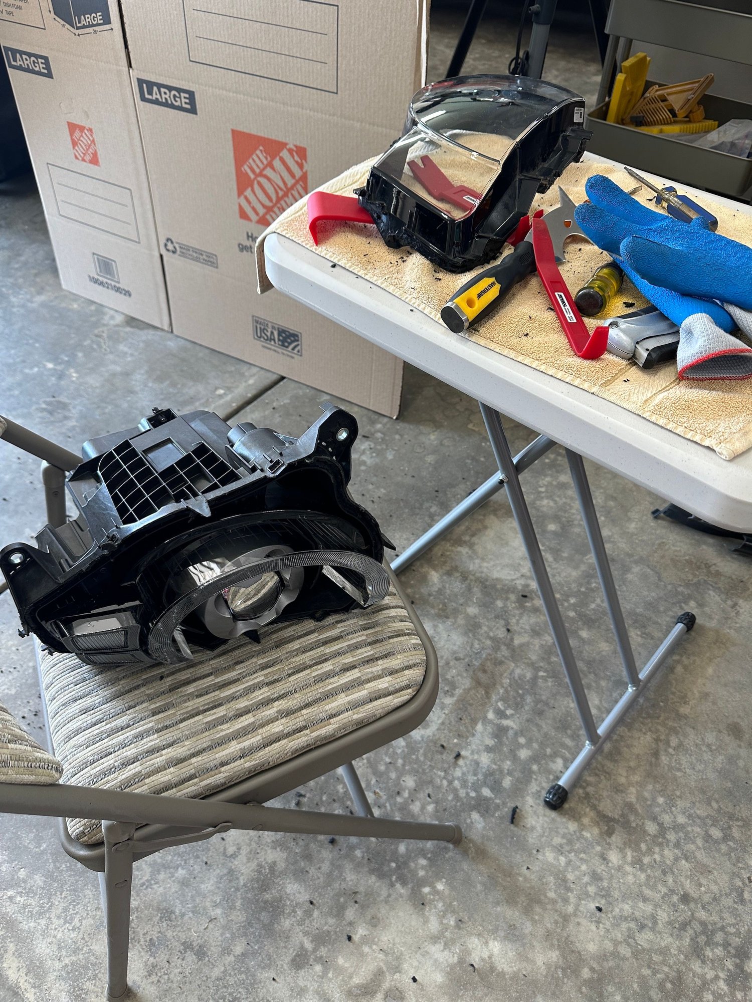

This thread along with the 2 PowerfulUK videos (grille removal and headlight disassembly) helped me greatly. It took almost no time to remove the front grille & trim and the entire headlight. Where it took time was separating the actual headlight from the lens. That took me about 2 hours. I was determined not to break anything or warp the lens by yanking on it, so I took my sweet time cutting the adhesive and eventually used pry tools to help me separate it. Also, cleaning out all the adhesive took time but a major cheatcode is to use linoleum tools like in the photo attached which worked very well.
Here are some thoughts:
- You don't have to remove the large heatsink on the back of the headlight. Functionally that does nothing for access. If you want to get it out of the way while you remove the lens it's easy to put back on.
- If you have the washer jets, you can easily detach the hose. Either clamp it or keep it pointed up or it will just continue to pour out washer fluid.
- Rubberized work gloves are good for when you're working on the lens separation.
- Separating the harness to the front grille is all about the grey notch on the back of the harness. You have to retract it, then push down to get the harness to separate.
My main observation after getting it all back together is the LED chip I got from PowerfulIK seems *slightly* dimmer than the one that comes in the Defender headlight. Nothing to worry about though and you'll eventually forget. I used the caulk strip in the photo below and will report back in a couple months if vapor appears or not.
