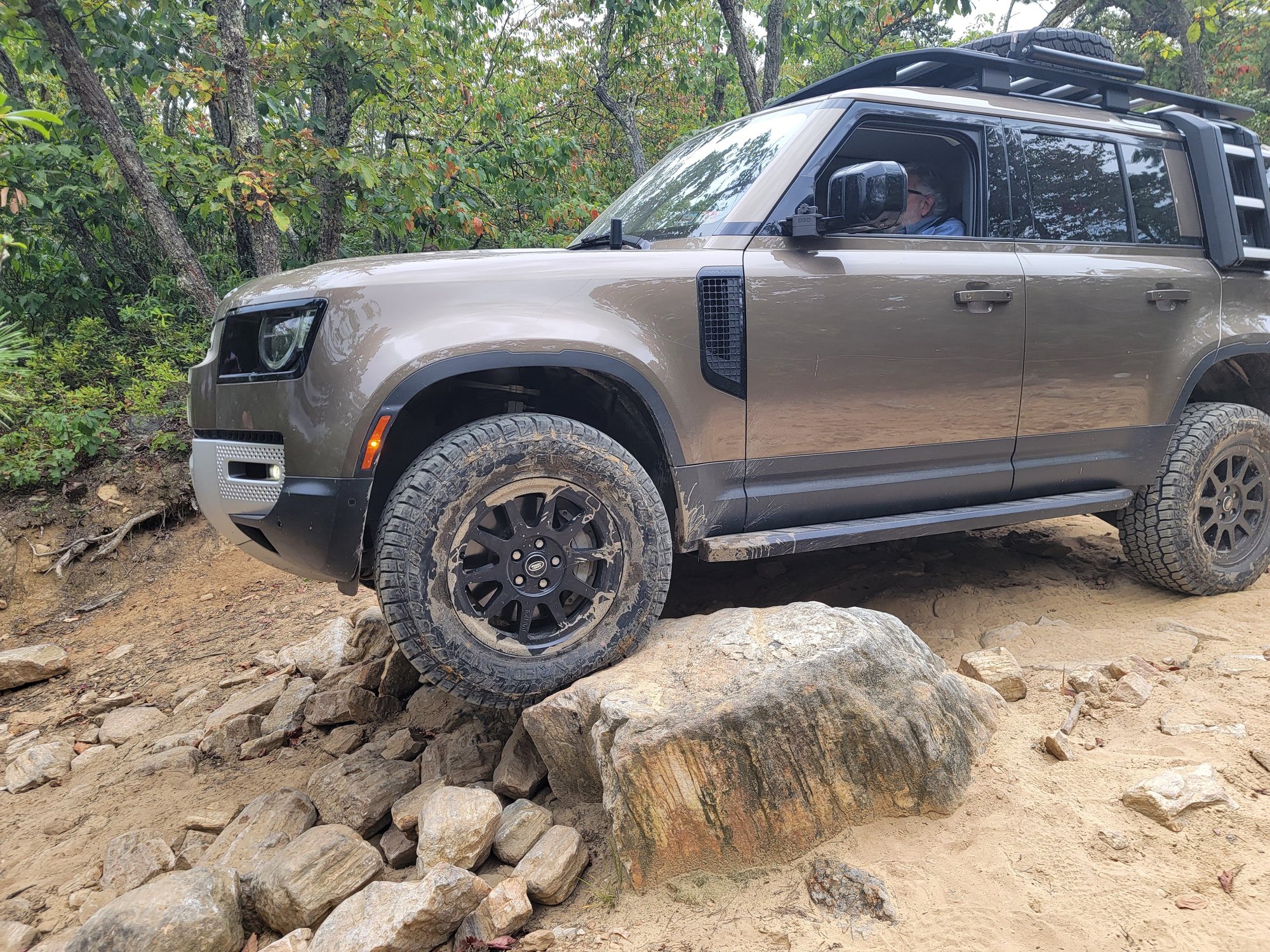

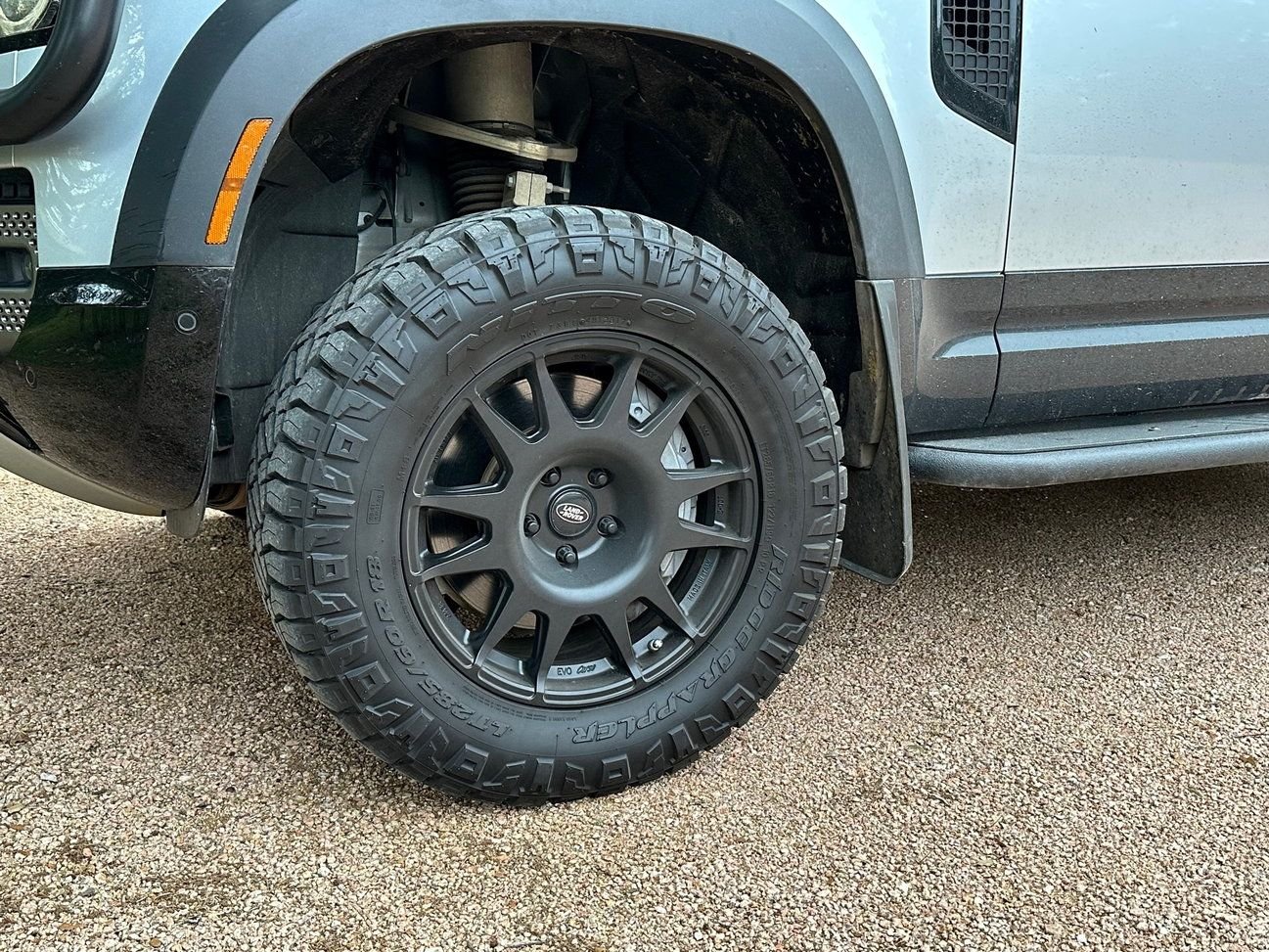

Not in your ask, but just to throw out the data points. I ground my calipers and installed 18" Evo Corse DakkarZero wheels and 285/60R18 Nitto Ridge Grapplers. My experience is that they have taken on everything I've thrown at them. I'm not an @sarek level off-roader - but I don't mind putting it through stuff. I haven't ridden in snow (I'm in Texas) so no insights there. Mud, does great. Rocks, awesome. In my reading, the thing with a Defender2 is to NOT air them down and I don't. I put them on the light load setting and let the mad wizardry from Lucas Electronics' grandchildren do their deeds. I also have the original wheelsets with the standard "Offroad" tires. 20" Goodyears. The nitto's are louder, but with my tone deaf hearing it isn't anything to be concerned with. Highway speeds, no problem. They are now my "daily wheelset". Any "offroad" tire will be louder. I'd suggest going to a local land rover club meet up and ask someone for a ride. If you are near a metro area, there will be one. Try to take a highway ride with someone else. Good luck!
Glamor shot after a wash
Close up of east Texas red clay
Last year's SCARR in Texas
