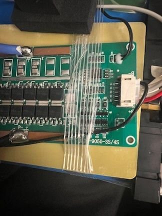

I stand corrected, AGM. It is of no real consequence, the small battery has its own BMS installed internally. Was looking into making one for a bud going to Burning Man and came across this in the reviews:
Image of BMS internal to the battery
So it does its own charge controlling, no need for special charger, the Current monitor. and voltage gage give you pretty much all you need to keep track of the system. Redarc and such are way overkill on something like this. It would seem on further inspection, most of the LiFe batteries now have their own BMS system internally installed, so special chargers are not necessary any longer. Would kind of explain why the other installation I did coming up on 4 years ago is still running strong. This particular battery, which is on the silly side of inexpensive, is good for 2,000 cycles.

- Your AGM battery does not have a BMS per se, at least not compared to a lithium battery (and lithium batteries are generally much better off with a BMS regardless of chemistry). The "BMS" for the 12V battery is simply there to tell the DC-DC charger when to charge the 12V battery from the 48V MHEV battery as you don't have a 12V alternator with MHEV. If your needs dictate a house battery, a Redarc system is anything but overkill.
