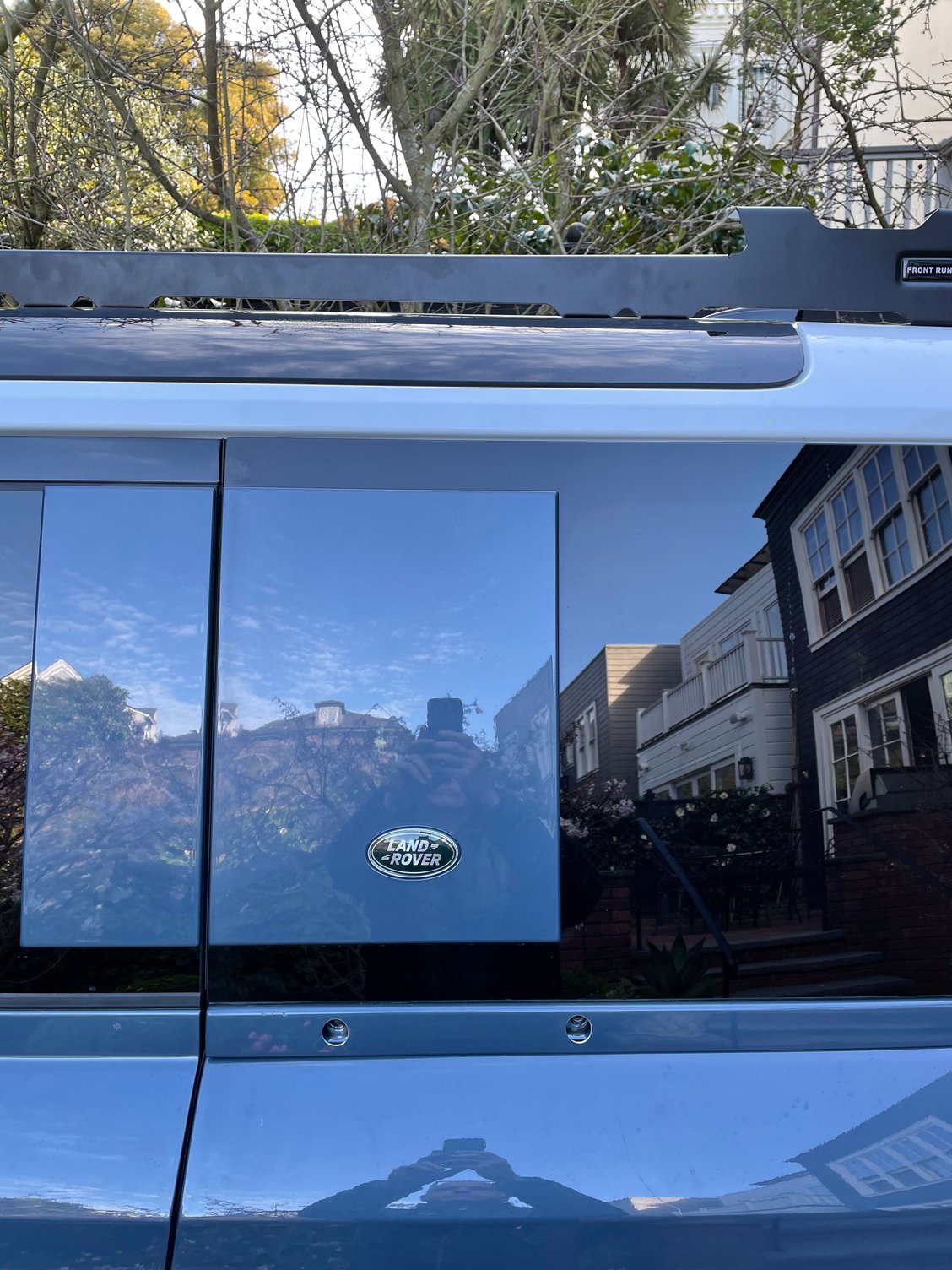

I got the ladder, had it installed & took it off. I do not like the way it obstructed the view in the driver side mirror.
I also have FR Slimline II RACK on my 110.
I don’t think you could fit the ladder under the rails in the location Land Rover rack goes on Defender. Picture below.
I got Xtend 750p telescoping ladder instead.
by the way, I had no problem taking off OEM rails & putting on FR rails. Unfortunately, the FR Rack shipment was missing a number of bolts which they still have to send me to install rack.
