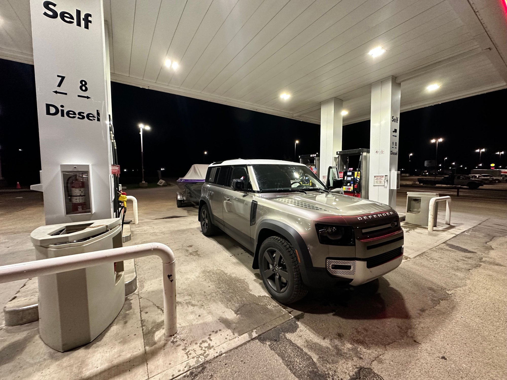

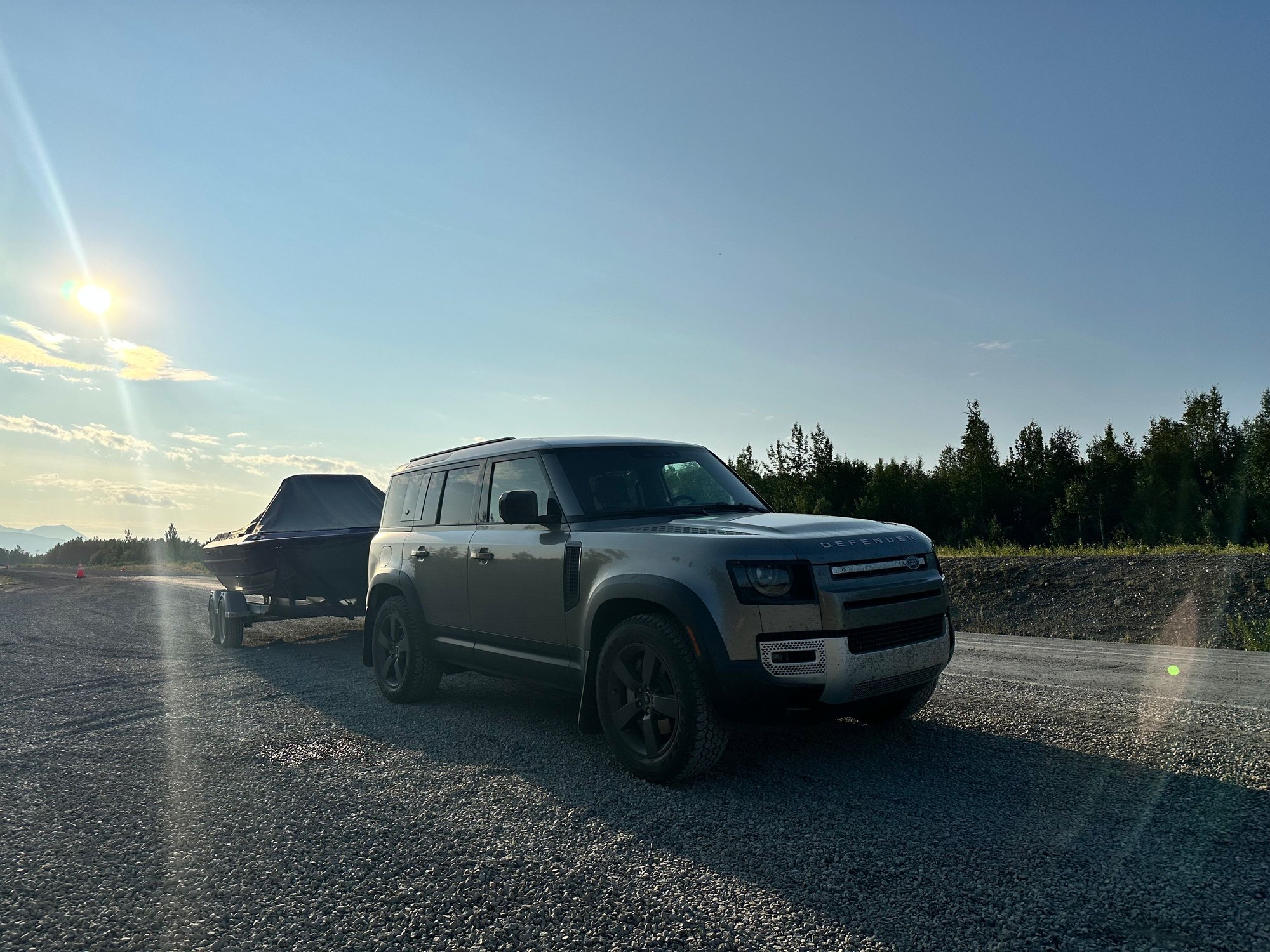

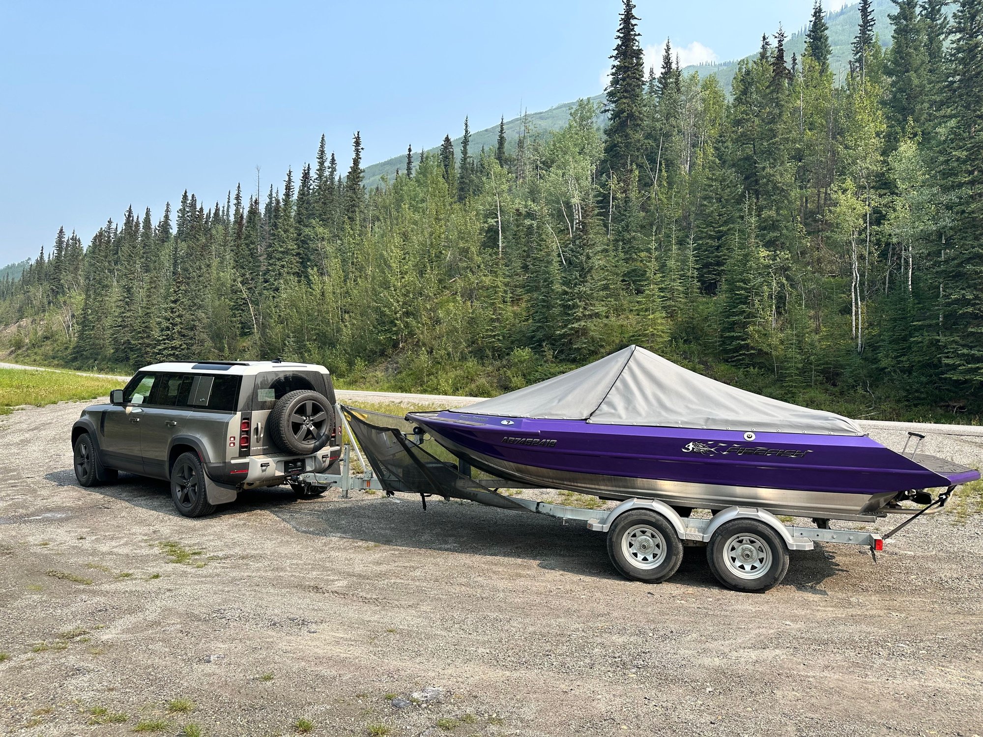

Hi Guys,
Long time lurker (6 months while the truck was being built and shipped) 1st time poster :-)
Figured I would join in on the convo ... I live in Alaska, picked up my Defender from LR Spokane on 7/26 ...Had a great experience with the guys there BTW.
Drove to Calgary, AB on the 28th, picked up a jet boat, and towed it 2,000+ miles back home to Alaska with the Defender.
My experience towing with the Defender was great! ... It is an SUV and not your typical full-size tuck, and you do hear a lot of the noises the trailer makes inside the Defender while driving, but the P400 has plenty of power and tows very nicely on and off the highway. Navigating gas stations and parking lots was a breeze.
I'm interested in the difference between the LR branded ball mount and an everyday one you find at any auto parts store. I used a standard Reese 2" drop, ball mount from Auto Zone with a locking hitch pin and it worked fine.
The Advanced tow assist is pretty cool, you use the left AC dial to steer the vehicle/trailer while reversing. It works great backing up in a straight line, I haven't quite got it down enough to use it to back up a 90 degree turn effectively.
