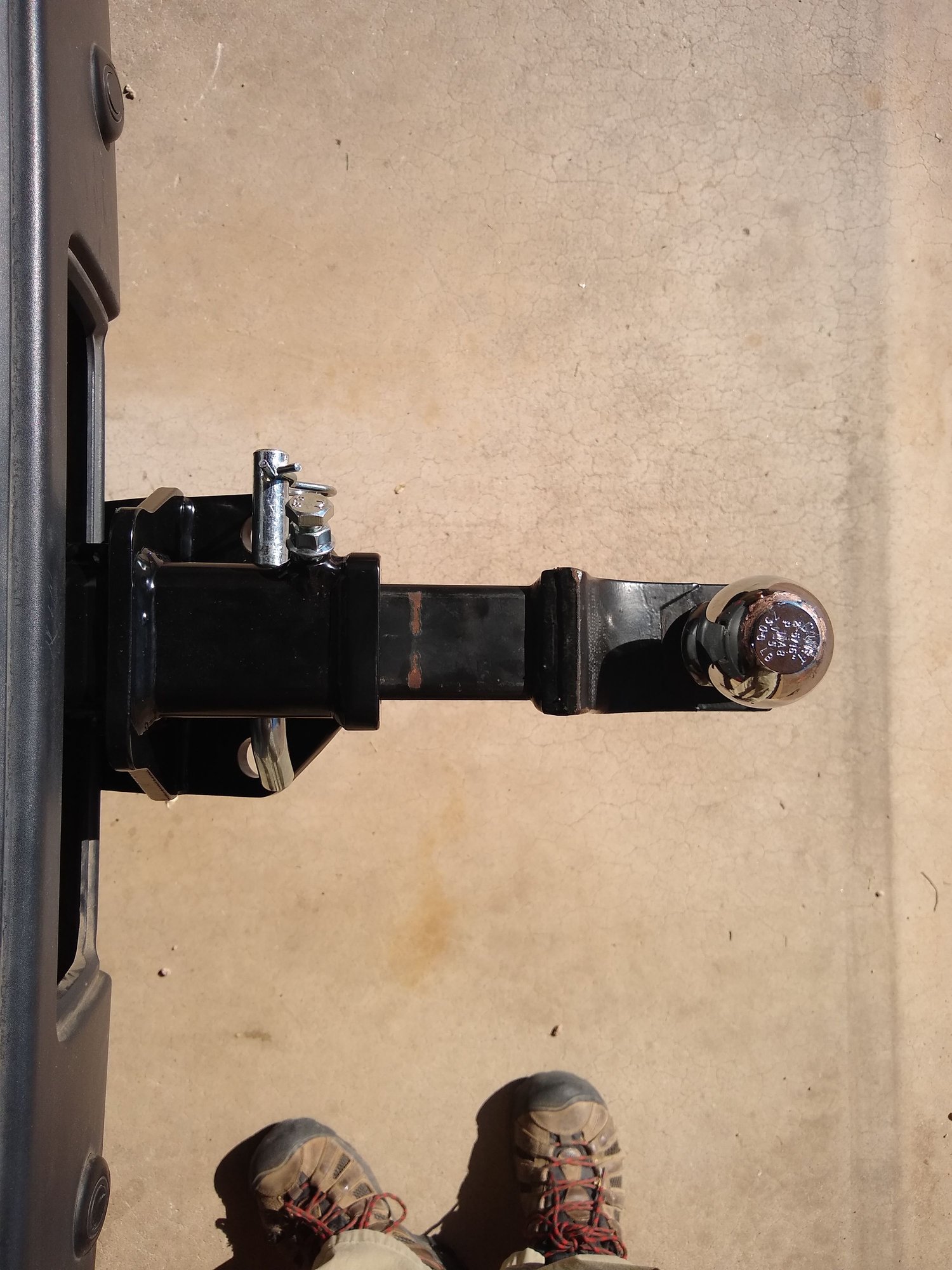

Default Ball Mount length is bugging me...
8-1/2" center of lock pin to ball center. I think it's 2 or 2-1/2" to long. Camper has a ~380 lbs tongue weight. Mind you...I ain't no "Towmaster"

Yes too long, you want the tube all the way in. You can just reposition and drill a new hole for the pin.

Yep. Thought so. Thanks (again) !!!

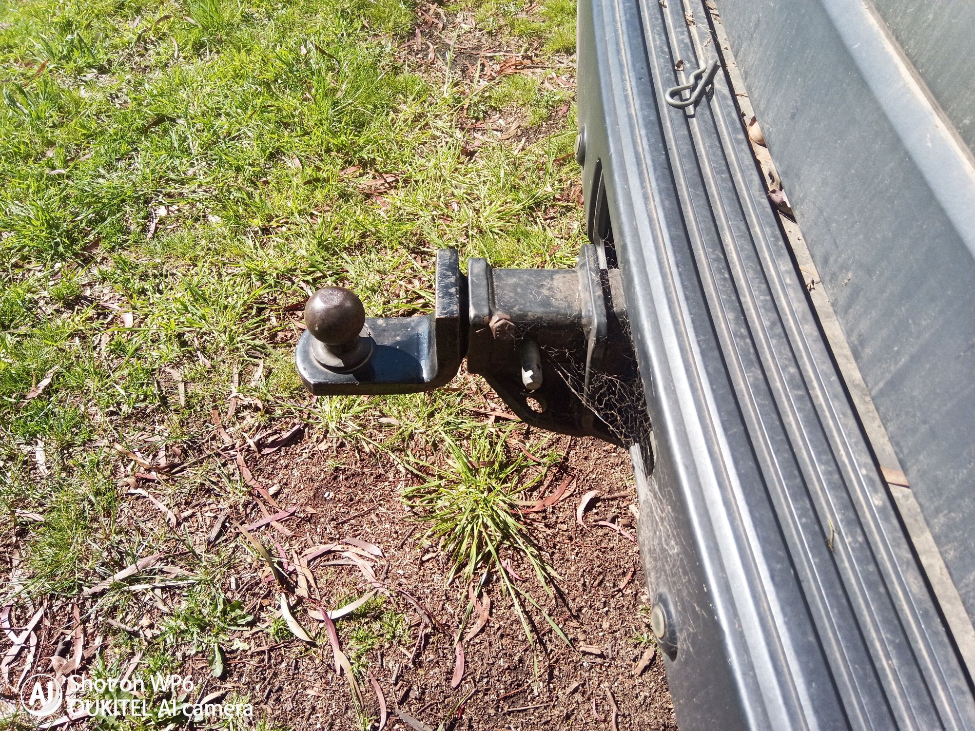

Forgot the pics yesterday.

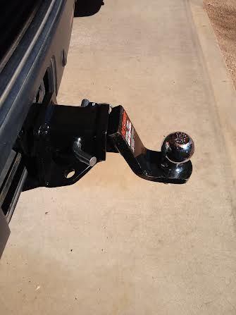

Perfection. Exactly as needed.

I am happy now. What I needed where I needed it.
