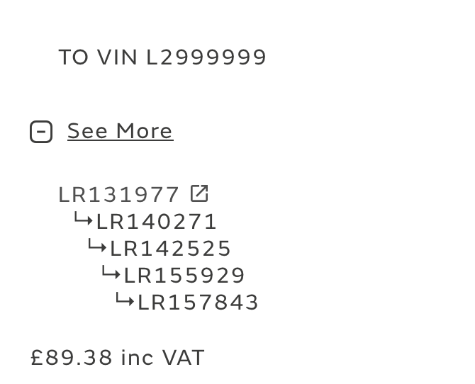

Very thorough but those #'s you post in the far right column are *not* the JLR part #'s. Those are the #'s stamped on the back. Different thing. (I know I know)
A helpful trick. This usually (if not always) has the latest part revisions
https://parts.jaguarlandroverclassic...nd/land-rover/
So here are all the part # supersessions JUST for the one a pillar outer cover, LH, primed (ie have to paint, not the black one)
Also... they always are "not available" on this website because that JLR classic site doesn't sell the parts for the new cars. Only classic stuff. But you can hack the site to see the L663 parts catalog as I've one above !
