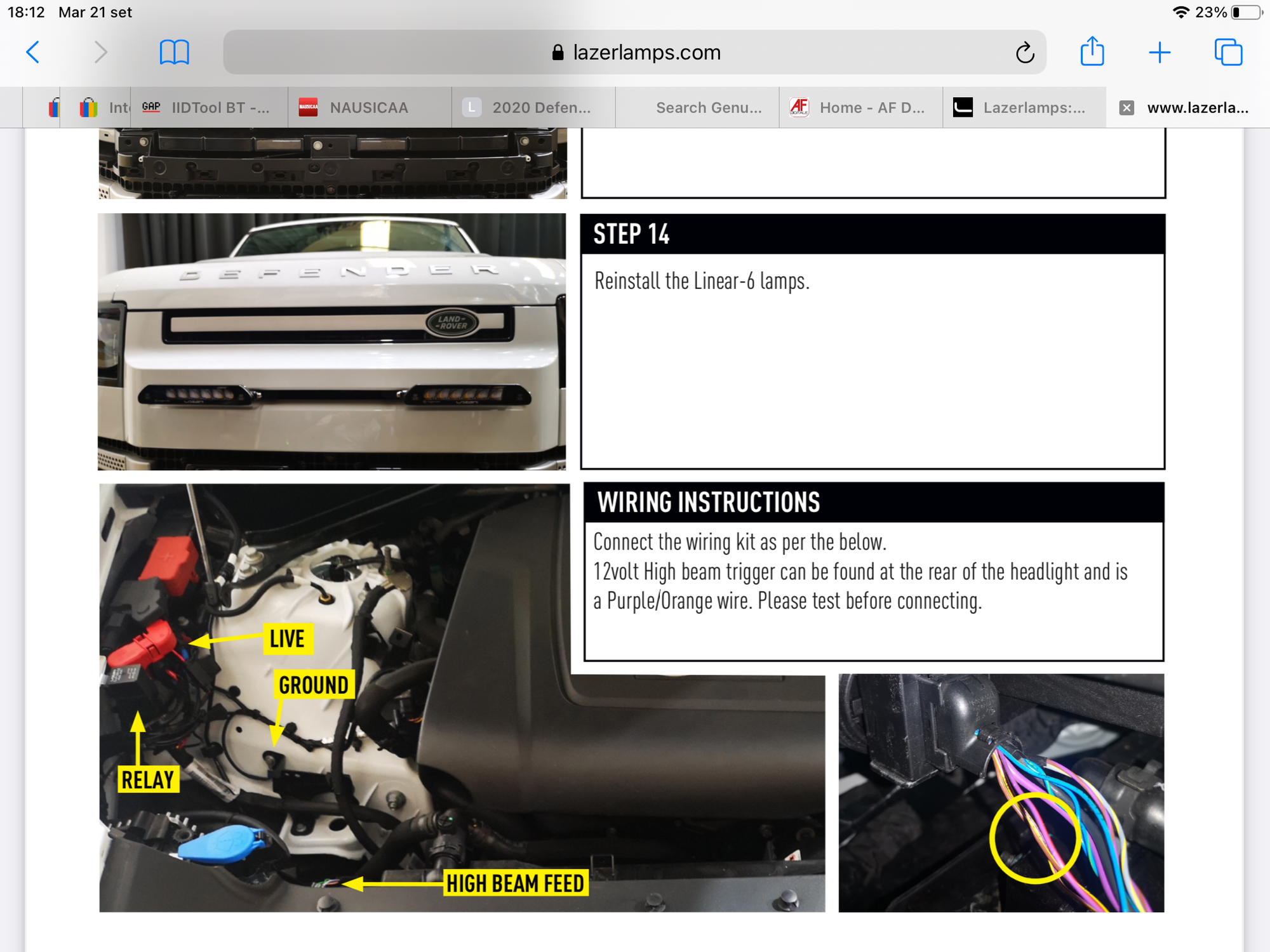

hello, I saw these instructions on the Lazer website, are you referring to the high beam wire?
attention that I think you need can-bus adapter, otherwise the machine goes into error.

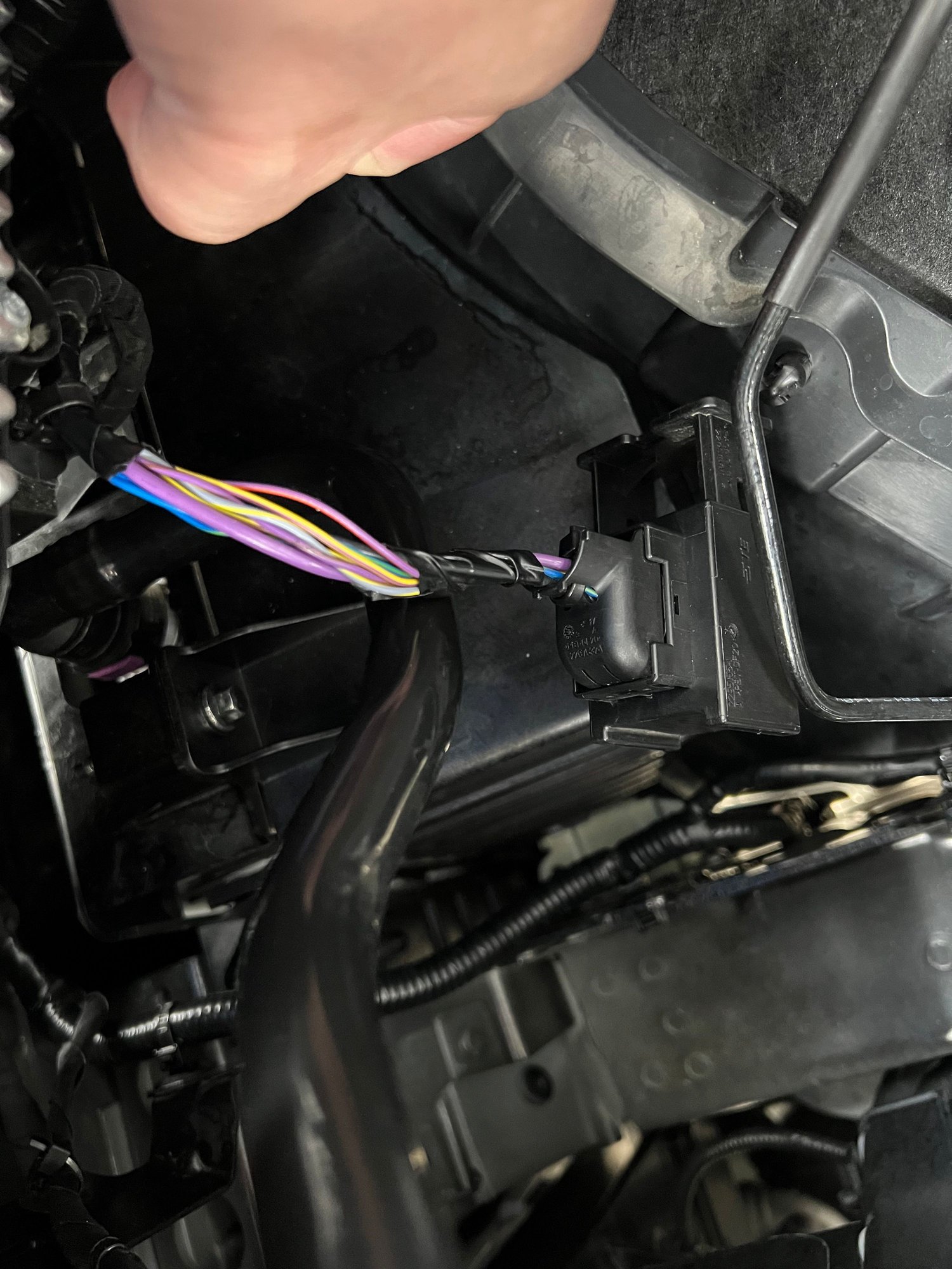

HI, I watched the company's youtube channel. They said the new defender has a 12v signal at the back of the headlamp. CAN reader is not necessary. We can use a standard wiring kit.
I have found the high beam wire.
Now how to get the cable passing the grille to the lamp connector is a problem to me. I can't find any information on it.

the purple wire rightly feeds the relay to turn on the laser, you can connect it to the high beam wire which should still be that color, (be careful though, another user cut that wire and 1000 errors appeared on the car) my advice would be bring the wires inside and put a switch, it's simple.

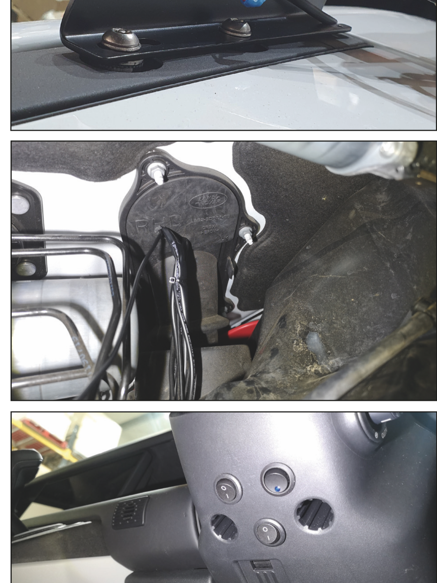

I am looking into installing lazer 750R lamps. Did you have them turn on with the high beam? Or did you install a switch inside? If so, where did you put it and how did you get the wire through?
Thanks!
Old Oct 15, 2021 | 07:38 AM
mmbanf's Avatar
Joined: Sep 2021
Posts: 86
Likes: 41

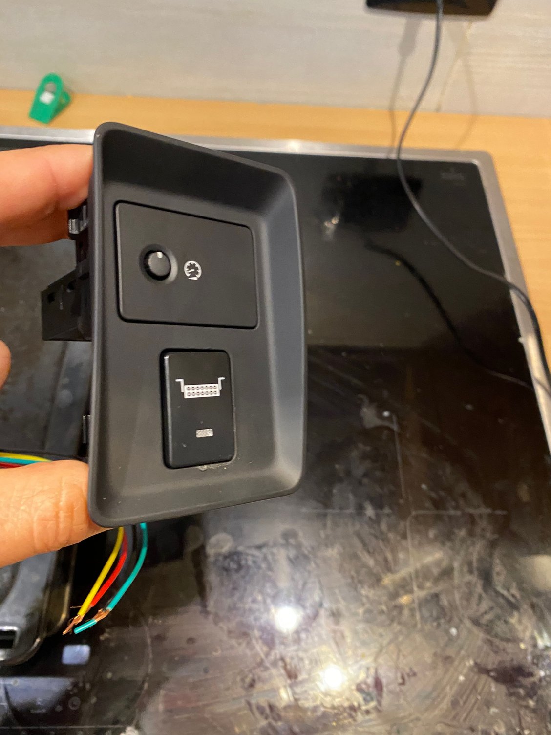

Thanks for those images, @mmbanf ! Very helpful. Please excuse me for my ignorance. You seem to have four switches there?
Did you have 3d printed the switch below the dashboard light know?

Hello
I only have one switch, the one with the led bar symbol,
the others were on the instructions lazer lamps.
