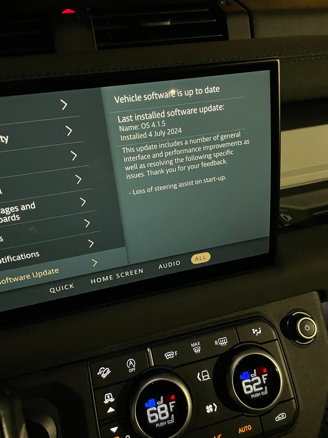

Old Aug 4, 2024 | 10:14 AM
SpyHop's Avatar
Joined: Apr 2023
Posts: 70
Likes: 47
From: Cape Cod, Mass
Default 4.1.5 installed July 4…
[QUOTE=SpyHop;906012] i have 4.1.5 - don’t know there was a 4.2?
Old Aug 4, 2024 | 12:07 PM
nashvegas's Avatar
Joined: Oct 2007
Posts: 2,776
Likes: 1,985
From: Whidbey Island, PNW
Very interesting indeed. Seems like a bug to me but -- Anyone else have this same issue with 4.1.5?
