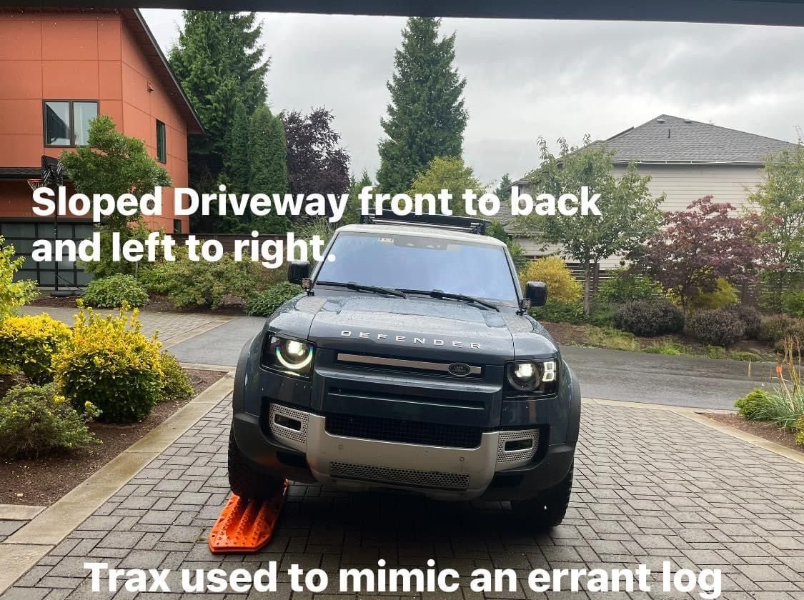

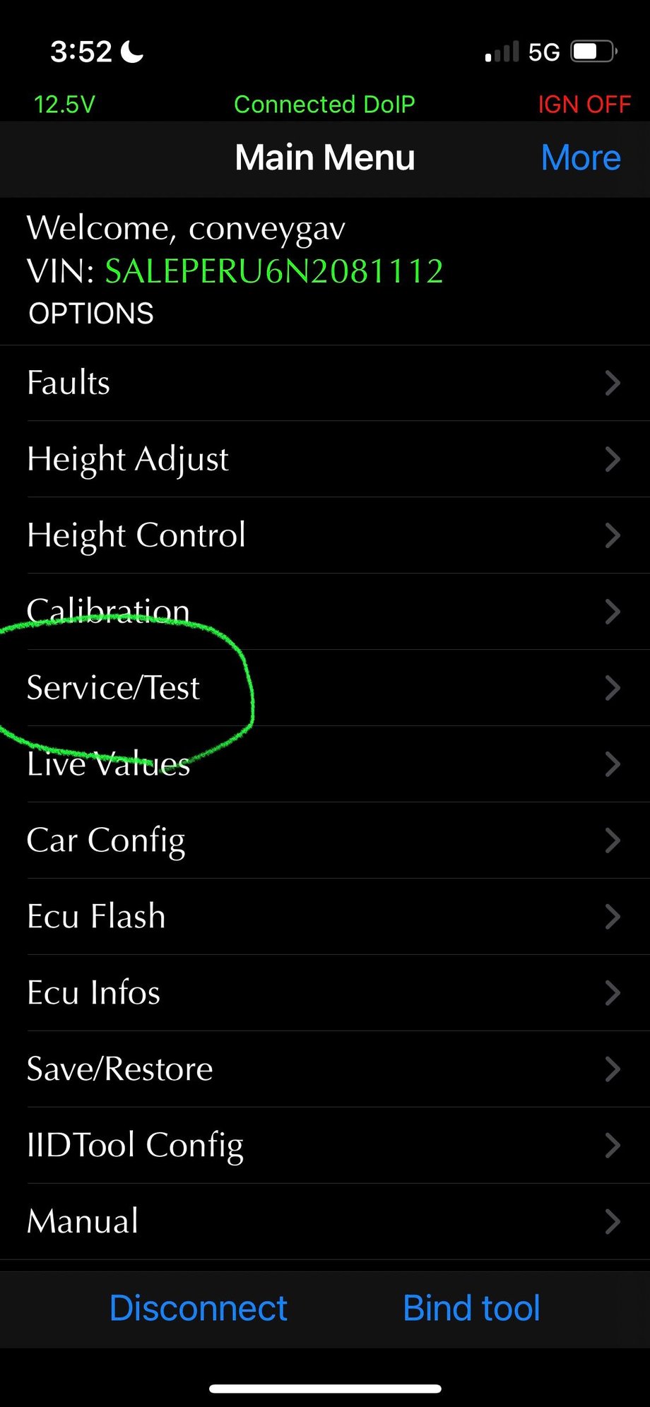

Using the GAP IID tool to level your Defender for roof top camping or a lofty perch is simple enough.
Who doesn’t like getting horizontal?
It takes a minute or so A small time investment given the duration of a comfy nights sleep ahead
I don’t use a RTT but thought I’d test the process nonetheless.

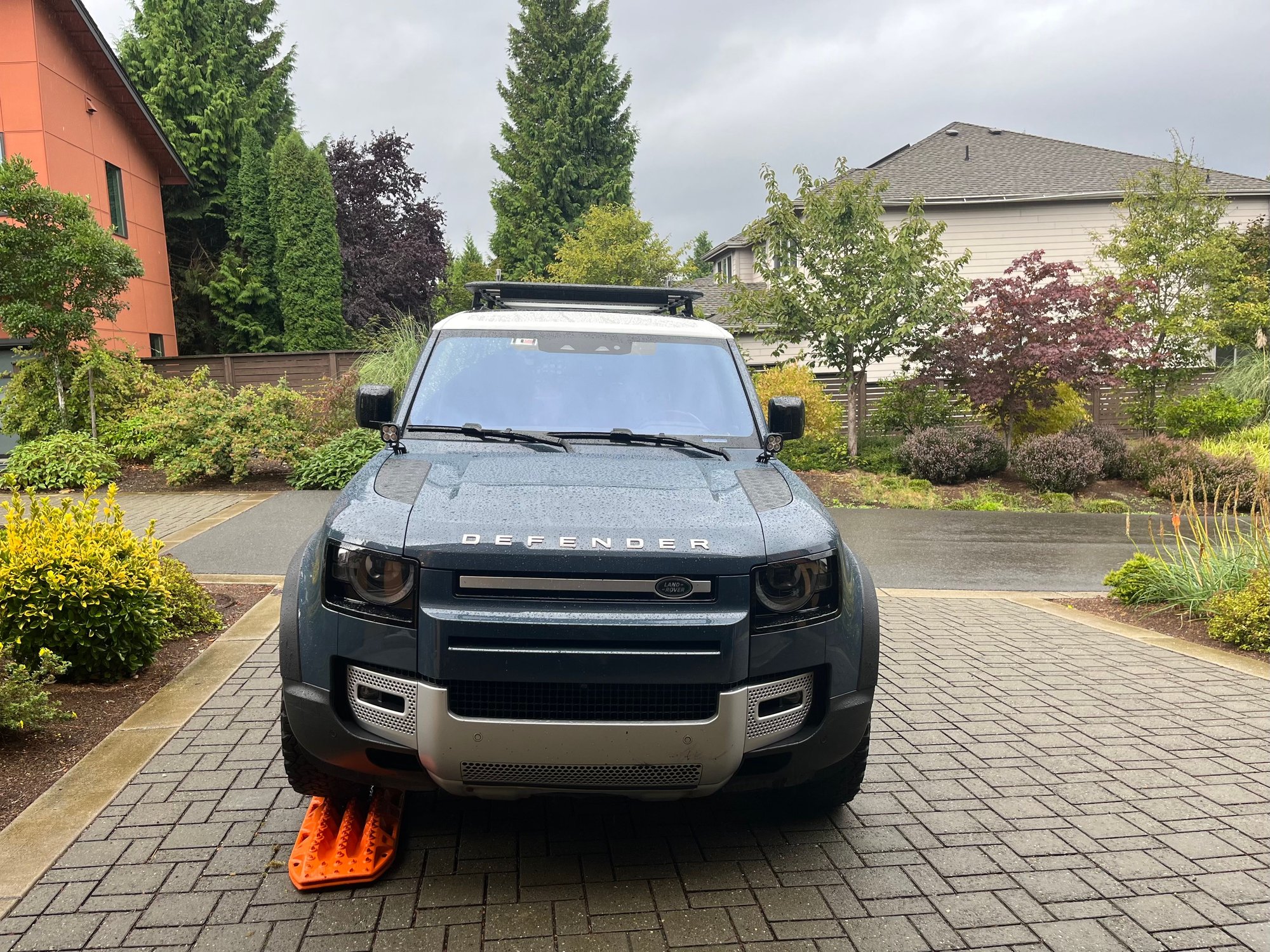

One more cool feature of the GAP tool An X-lifter in disguise.

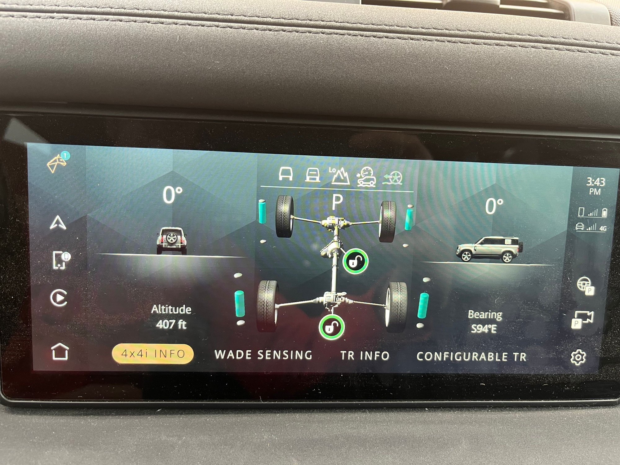

After leveling.

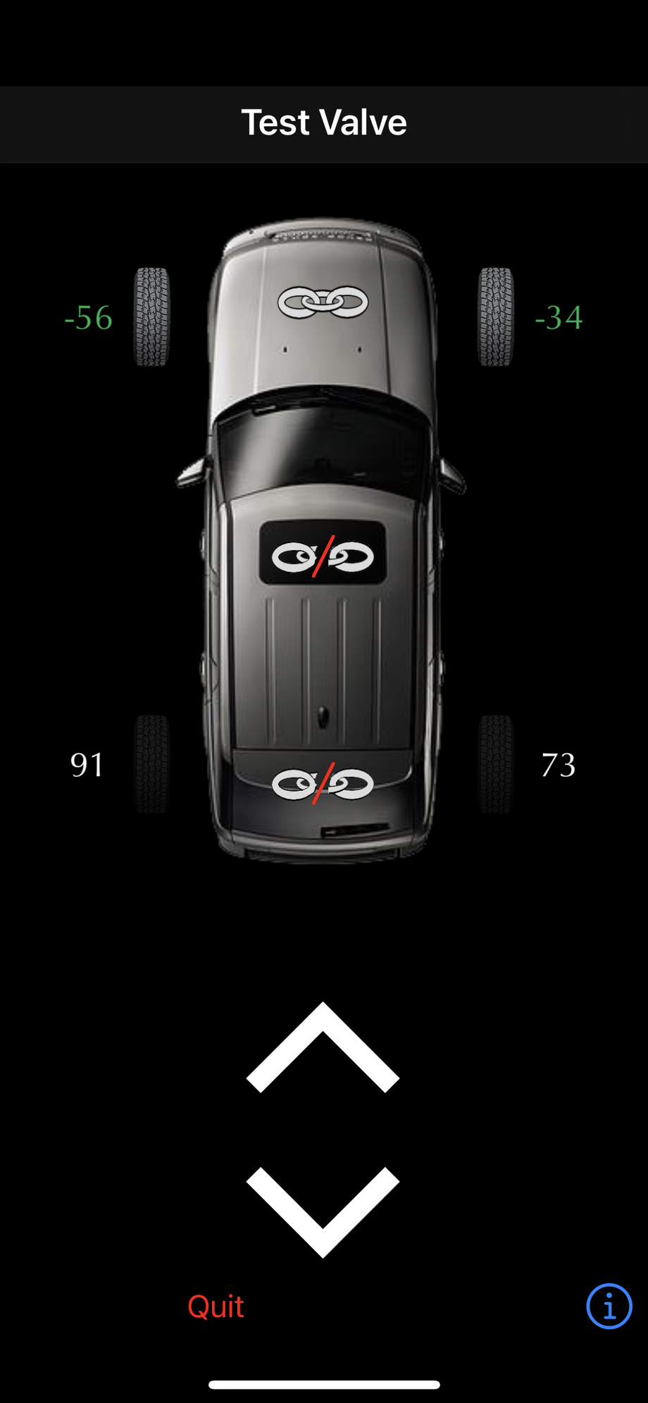

Each corner can be inflated/deflated as needed.

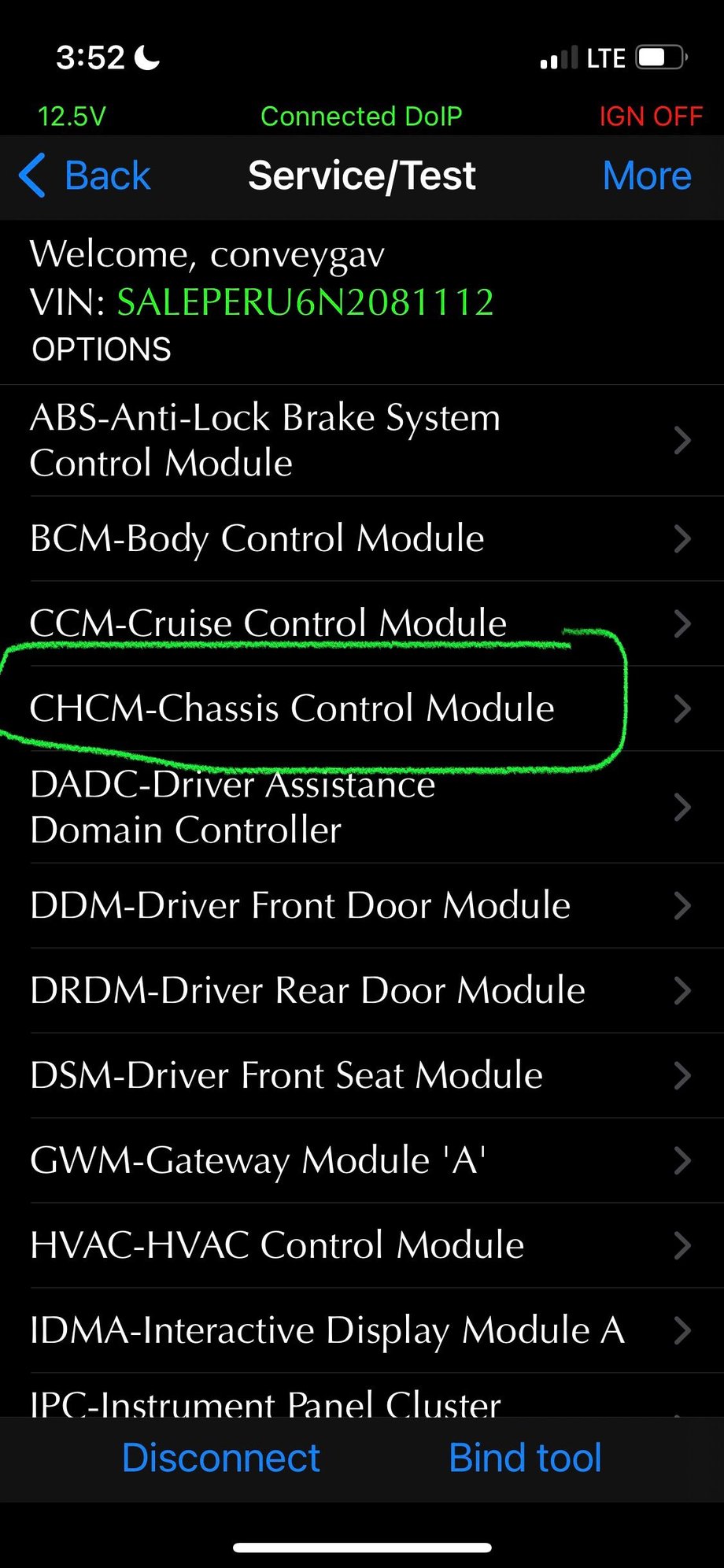

BTW, you have to put the vehicle into 'Build Mode' first to keep the EAS from trying to level out when you leave 'Test Valves' if you want to sleep level in your RTT or platform in the vehicle, etc.

I don’t see a build mode in the menu. Just the options I’ve shown.
nothing happens to the suspension settings once I stay there. Is there another option to select?
I thought the service/test section was the same as build mode for the L663 and GAP G4/G3

I forgot - "Build Mode" was replaced "Manufacturing Mode". It's in the CHCM (Chassis Control Module).

I don't see " manufacturing mode" either. Still only seeing the menus I showed. It works just fine, just not got the same labels you mention.

Or you could just not park on logs.
I hadn't really considered that remote possibility.
