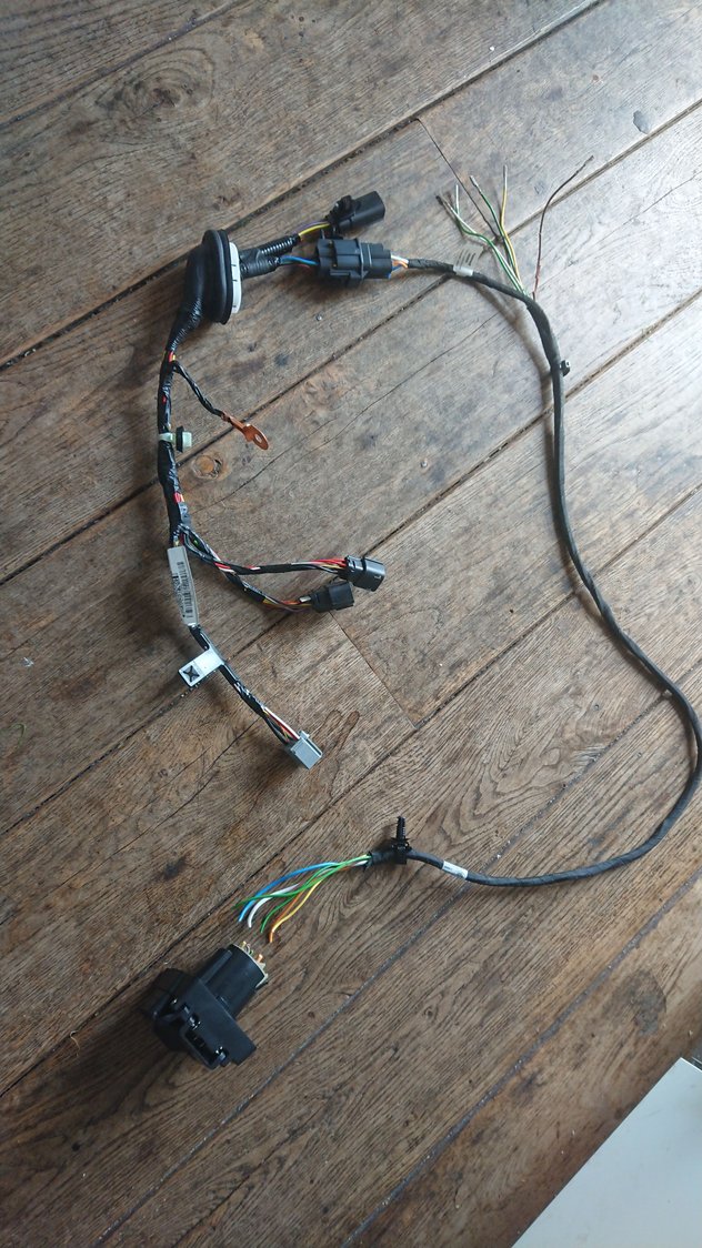

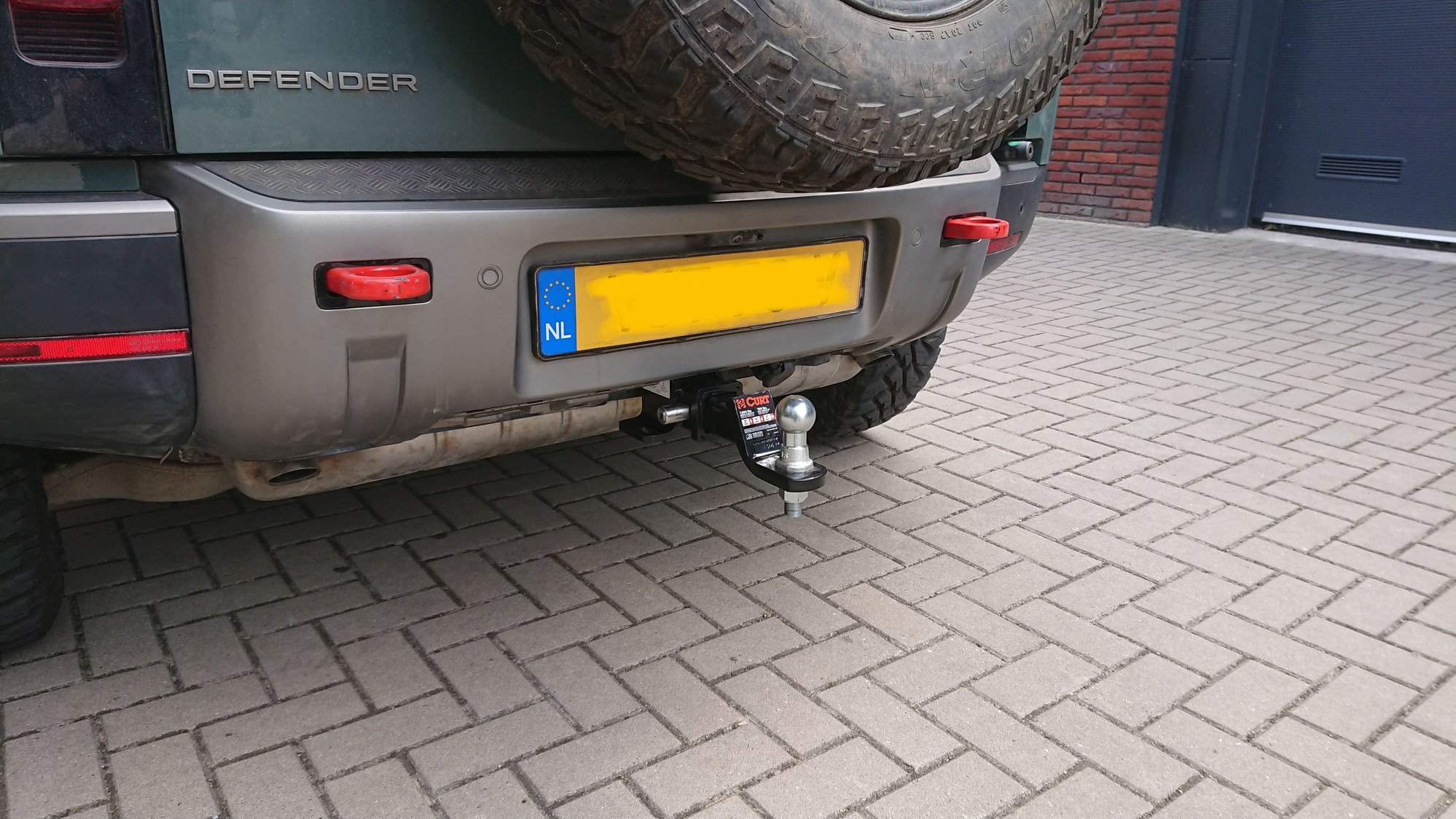

I've just mounted a NAS hitch on my ( ROW ) New Defender MY21.
I needed to modify the loom on the towbar from 7 wires to 11 for the Euro 13 pin socket.
This involved some work, money and time.
Back to topic, mounting the electronics in the car, 1 hour labour
Mounting the Towbar with the 24 heavy bolts, 4 hours labour
Programming with the GAP iidtool v4 , 20 minutes.
So I hope this is helpful if you get a quote , labour 6 hours maximum.
