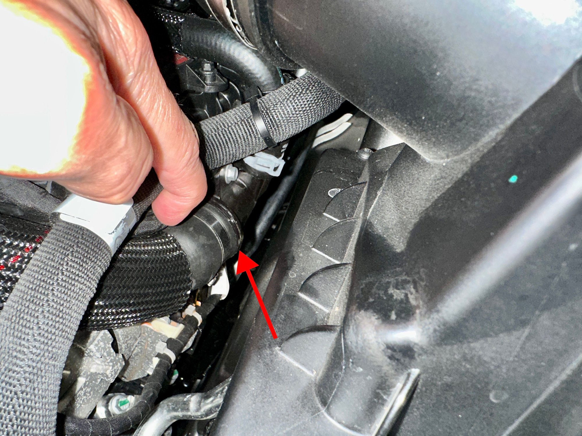

Yep....after a closer look its definitely coming from the larger diameter hose that comes from the drivers side (US) upper part of radiator and ties into the upper drivers side of engine. There's a hose clamp there holding it on but I can't get my hand in there to see if its tight.
Old Sep 5, 2023 | 11:05 AM
  #44
Low Country's Avatar
Joined: Oct 2021
Posts: 308
Likes: 129
Here is the exact spot mine is leaking from. It's leaking right where the upper radiator hose clamps on to the plastic part on the upper side of the engine on drivers side (US).

All fixed, hose part # LR121446. Land Rover Fort Myers was exceptional, GREAT service!!!

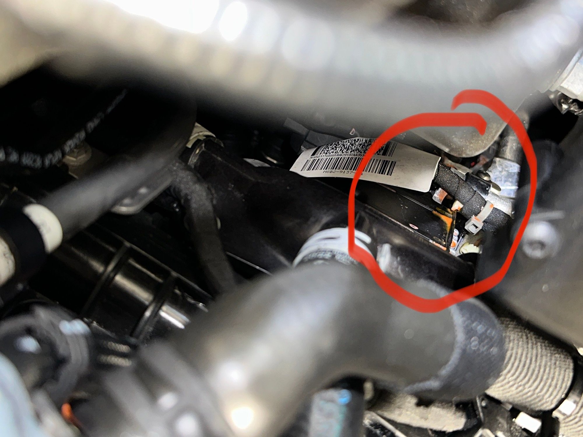

@ballandchain my 2020 110 passed 4 pressure tests. I took pictures every couple weeks over a 3-5 month period IIRC and was able to get the Service manager to agree that my car did have some kind of leak that still passed pressure testing and LRs protocols.
So we agreed to let him drive it home without all the skid plates (a 45 minute drive). Then in the morning he drove it straight into the service bay all nice and hot and straight onto a rack.
While still running on the rack, they finally found the tiny pinhole leak down by the PCM module. The leak dripped on some hot part and evaporated. This is why there was no residue on the skid plates or anywhere else from a visual inspection.
My reservoir was dropping from max to min roughly in a 2-3 week period. So over about 4-5 months I burned about 1/3 of a container of coolant. That leak was small enough to “pass pressure testing”.

Hi and thanks for sharing,
I don't understand the point of the fluid leak... can you please take a photo?
Marco
